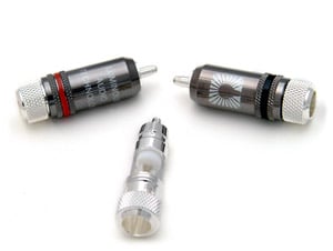

    Nice offer zingo. I've used connectors like these for my coax IC's.
    http://www.parts-express.com/pe/showdetl.cfm?partnumber=091-400
    I've been using Belden coax as IC's for years. Mine are stranded center conductor, very flexible. And yes, I've owned some pricey IC's in my audio time.

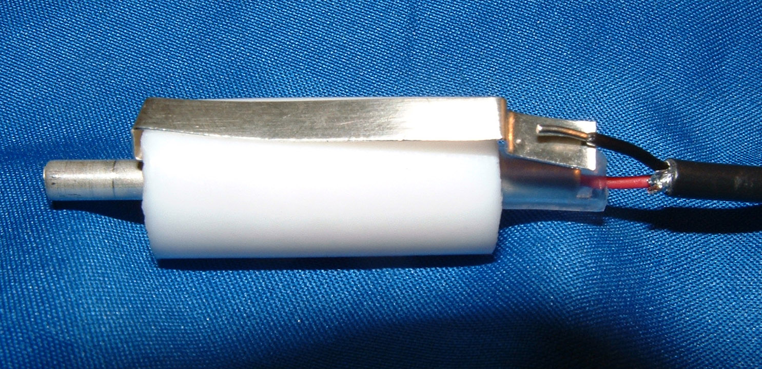

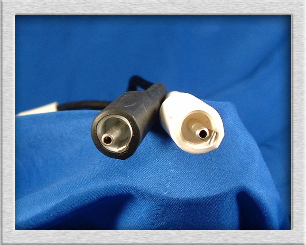

    I would love to find a source for these old RCA coax terminations. They are off a damaged Linn LP12 turntable IC, 5 pin DIN plug to RCA. They had two grounds, so you unbraided the shield and split it into two for the best strain relief. These are currently in use on my turntable.

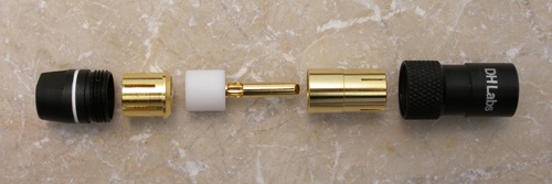

    Very cool plugs. The DH Labs RCA-3 75 ohm plug also has a very nice design, and I believe the dielectric is solid teflon. You solder the center pin, then compress the shield. It makes for a very solid connection both mechanically and electrically, but you can still easily take the plug apart and resolder the center pin if needed.
