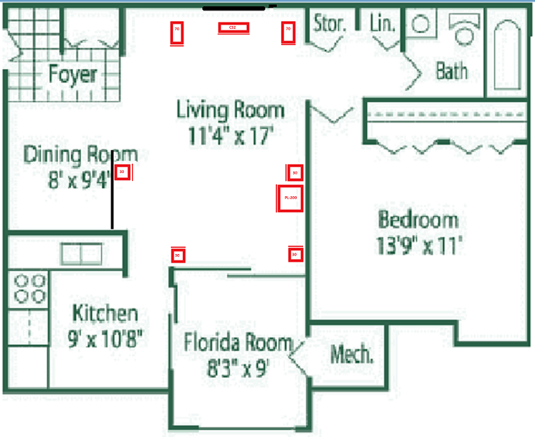

cnh: That's awesome that some manufacturers actually include port plugs. That could really help people in tight situations! So, room boundary effects, eh? That's probably it since I have such a limited space to work with. Take a look-see:
