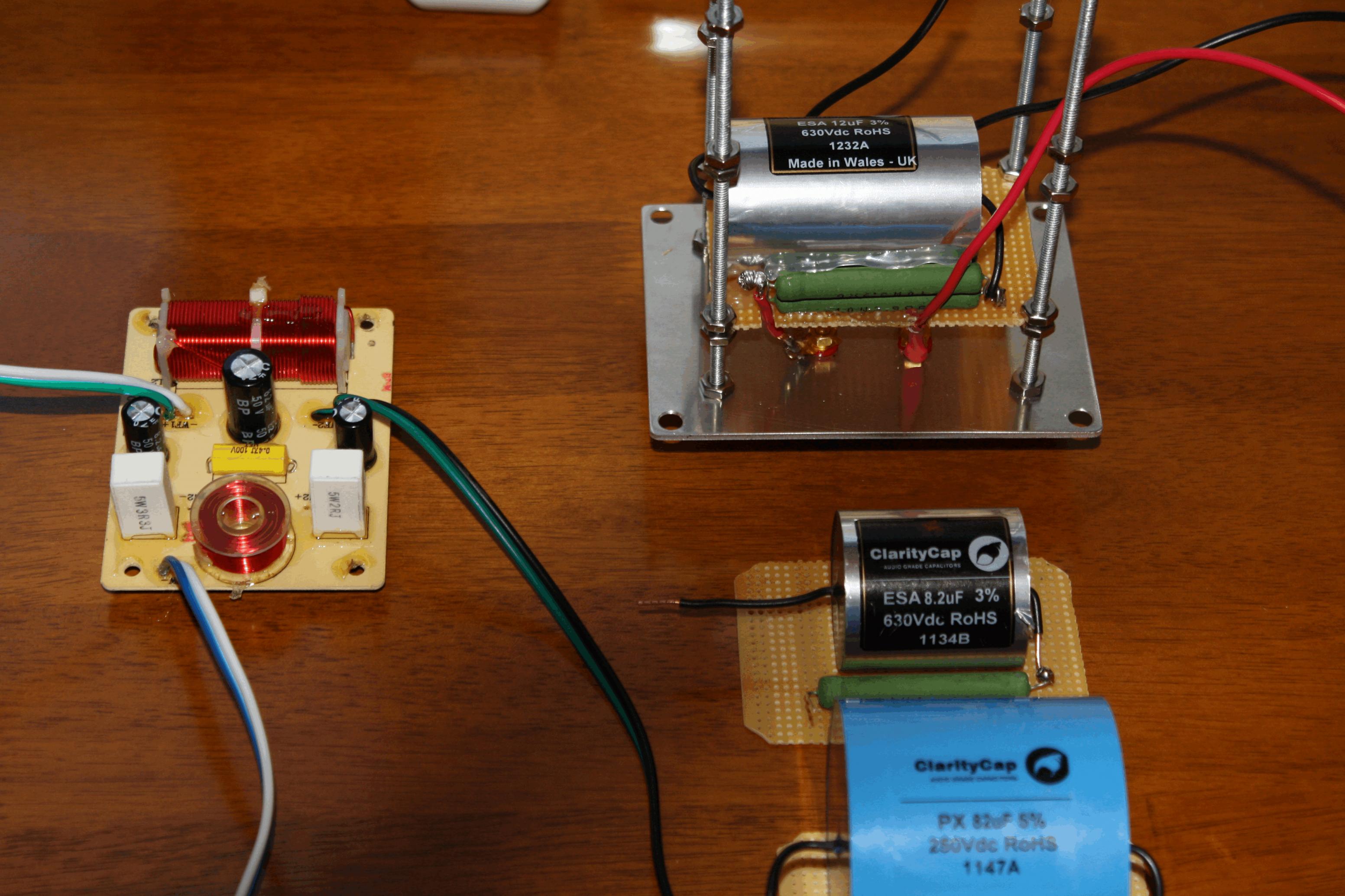

    I have been trying to map out the best positioning..Dang this harder than I thought. Its like a freaking Rubics Cube, LOL. I think I'm going to go with the Tweeter on the bottom board, Mid in the middle and the shunt on top.

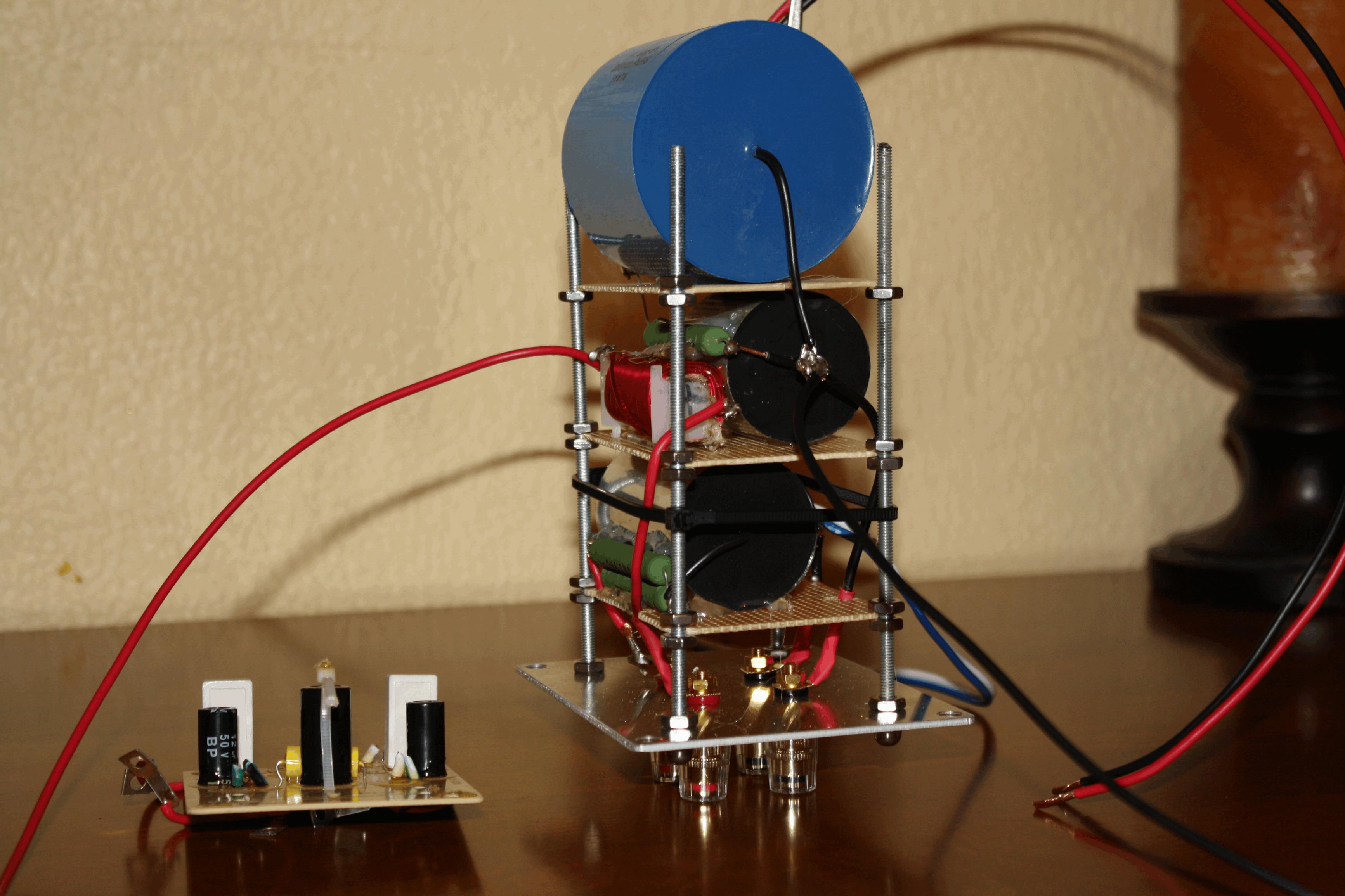

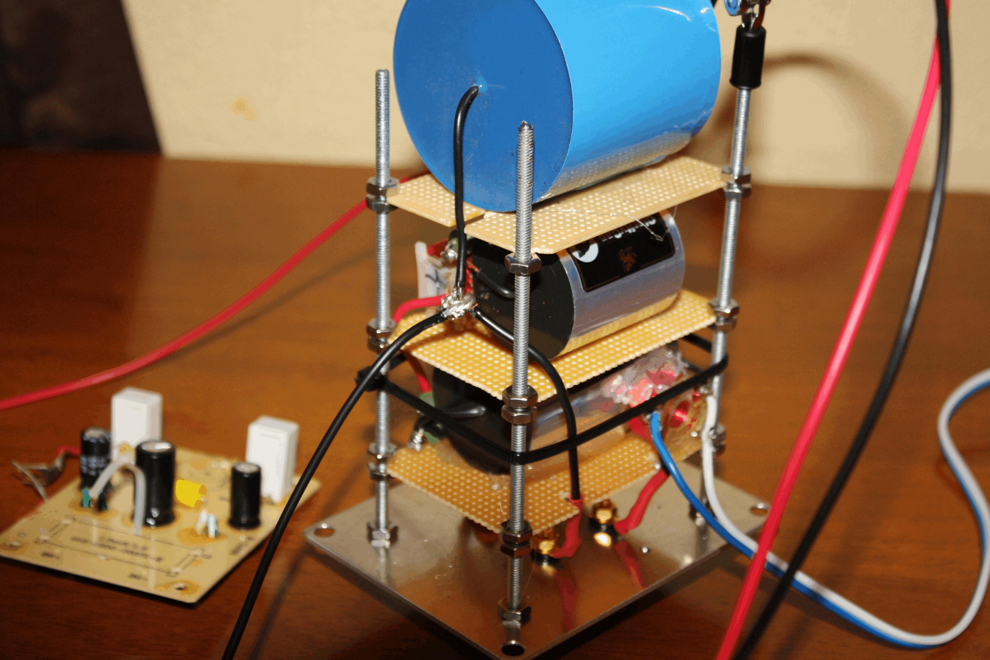

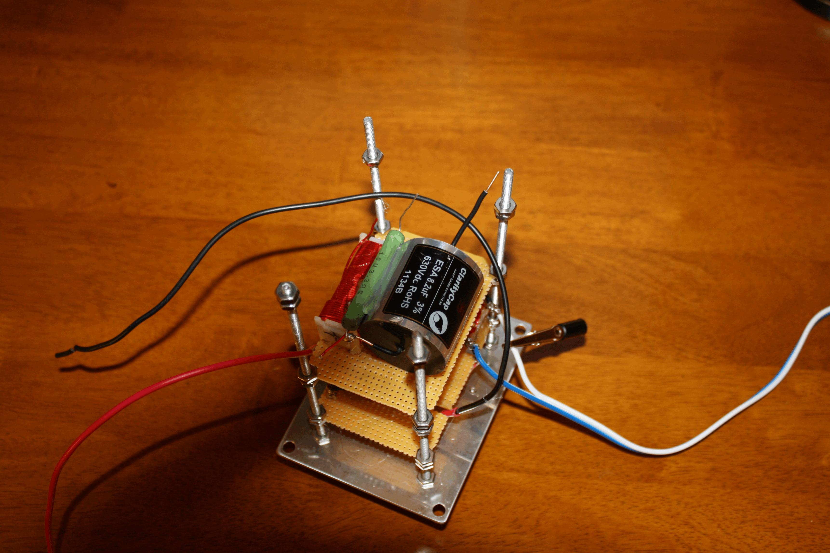

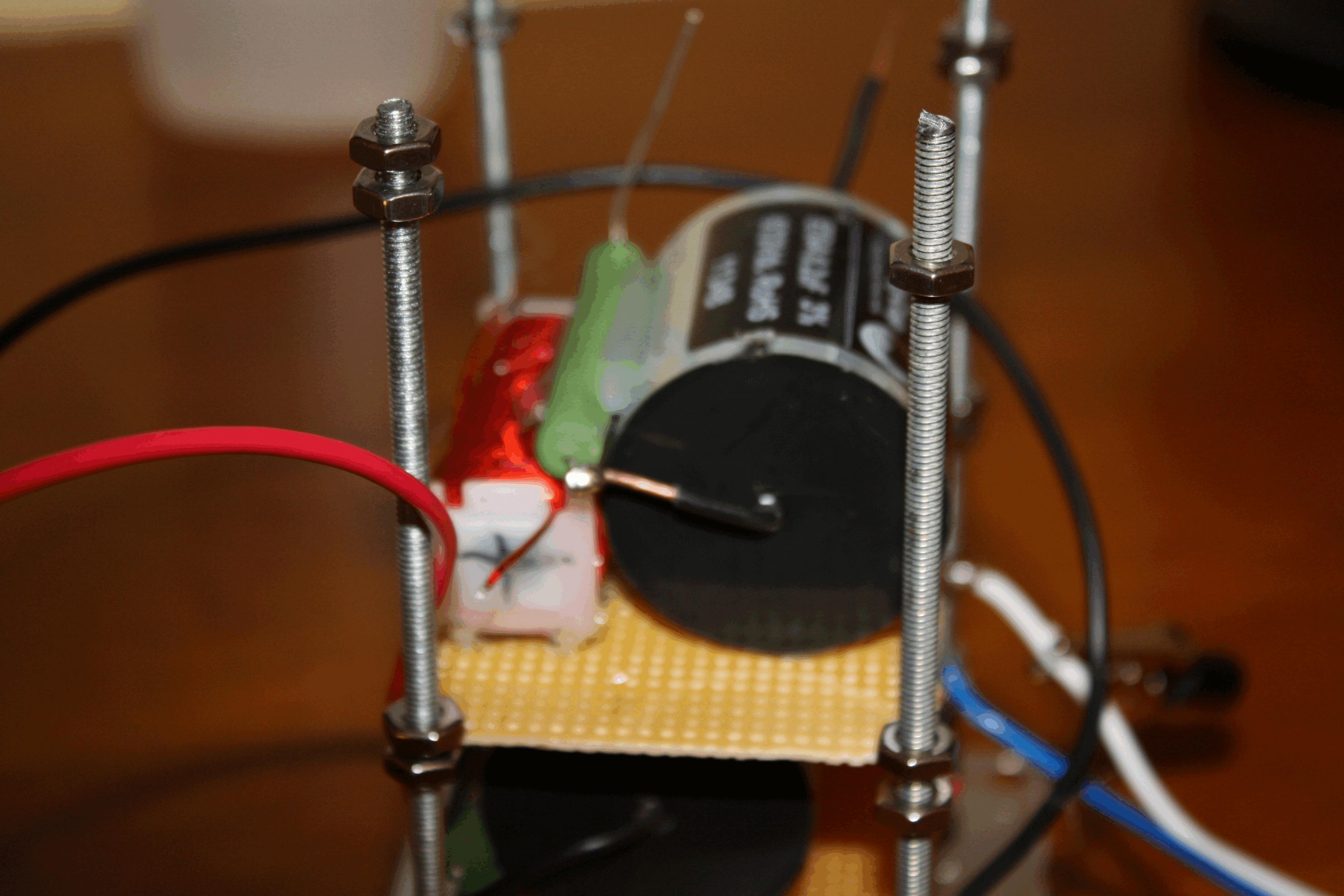

    Things are moving exstremeley slow for this mod. The solder station I got in from Parts Express was a piece of junk so I went out and bought a Weller it seems to work very well. Please go easy on me about the soldering I am very new at all of this and am learning a great deal doing the DIY kit from Trey.
    Here is as far as I have gotten. I hope to finish up and Install sometime this weekend, however that depends on the wife and kids.
    I will continue to post more step by step pics as I complete each step.
    Thomas
    PS:These pics uploaded kinda crappy..I'll make sure just to use my Mac in the future.

    Tommy, thanks for taking the time to post your progress! If possible, is there a way that you could record (even with a camcorder or camera mic) some music before and after mod's on your Lsi's? Also, on youtube there is a guy going back and forth between stock Lsi on one side to modded Lsi on the other while the same piece of music was playing. That is an impressive demo and has had a big influence on me moding my Lsi's. Anyway, just a suggestion.

    Dev, i have thought about that alot actually, Ill see what I can do. Anyone thinking about modding for the first time, i would recommend going through Trey he is one hell of a helpful dude and has the best customer service I have ever encountered.

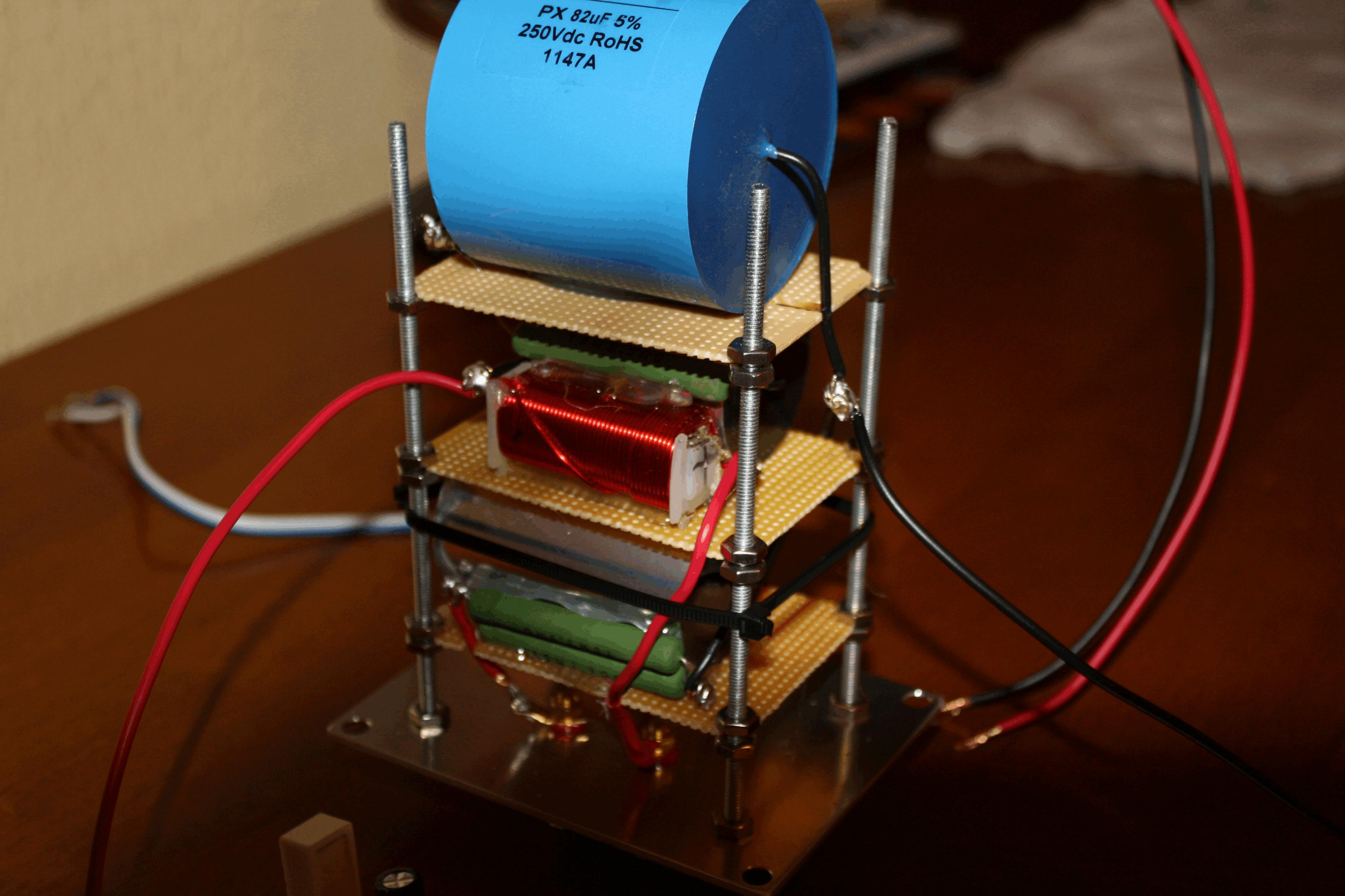

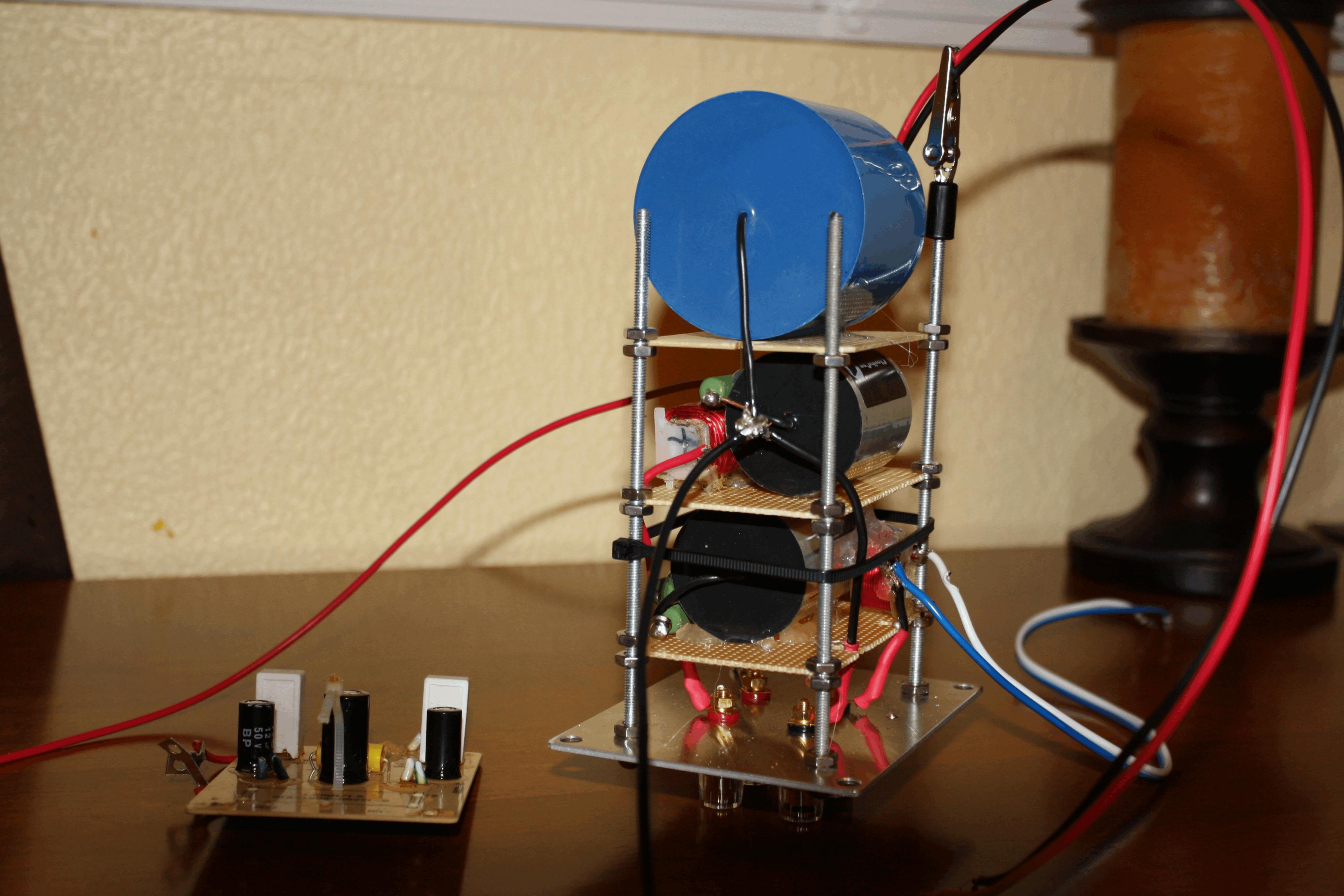

    I hope to get alot more completed today. Here is a side by side of the current mod build next to the stock CSIA6 x-over. You can see the signifigant size difference.The stock x-over is so lil and cute I may give it to my daughter after I finish removing the Inductors..:redface:J/K.
    I hope to post more pics later in the day.

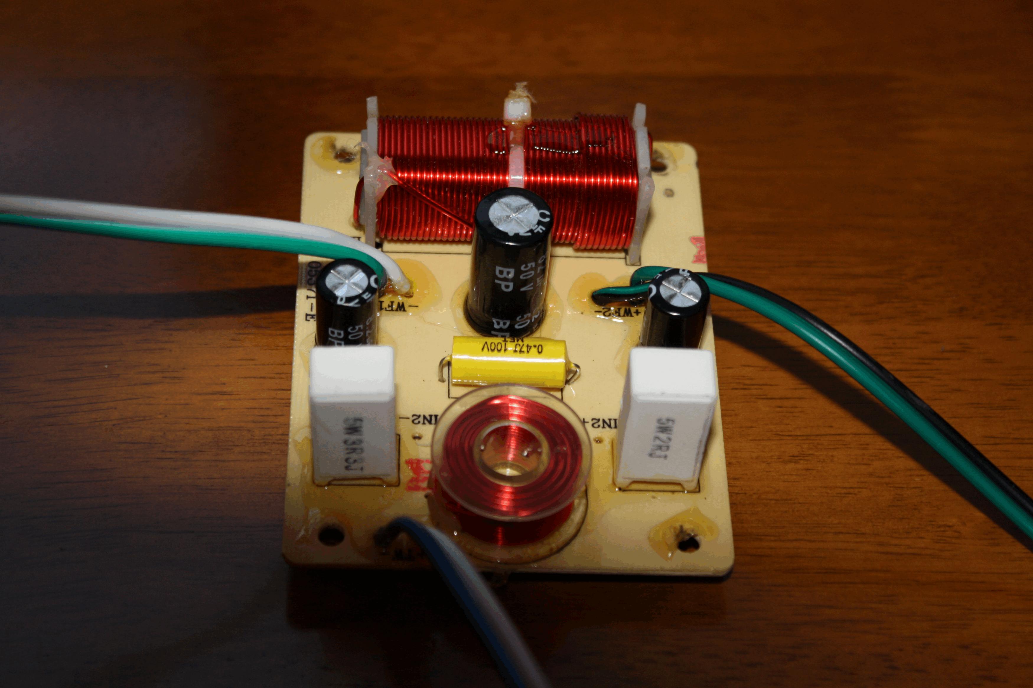

    Any tips on getting the inductors of the stock board? I having a tuff time...

    rubbing alcohol and a q-tip....works really well!

    Midbass inductor... cut the leads.. rip it off
    Tweeter inductor, desoldering the leads - take a knife, on the blade slowly work under the inductor and pry it off...
    Bada bing, bada boom

    Dev thanks for the support, Hobby great tip on the rubbing Alcohol made life alot easier. Those Inductors are fragile little pains in the arse.. I now have them off now I need to figure out how to position them without creating problems.

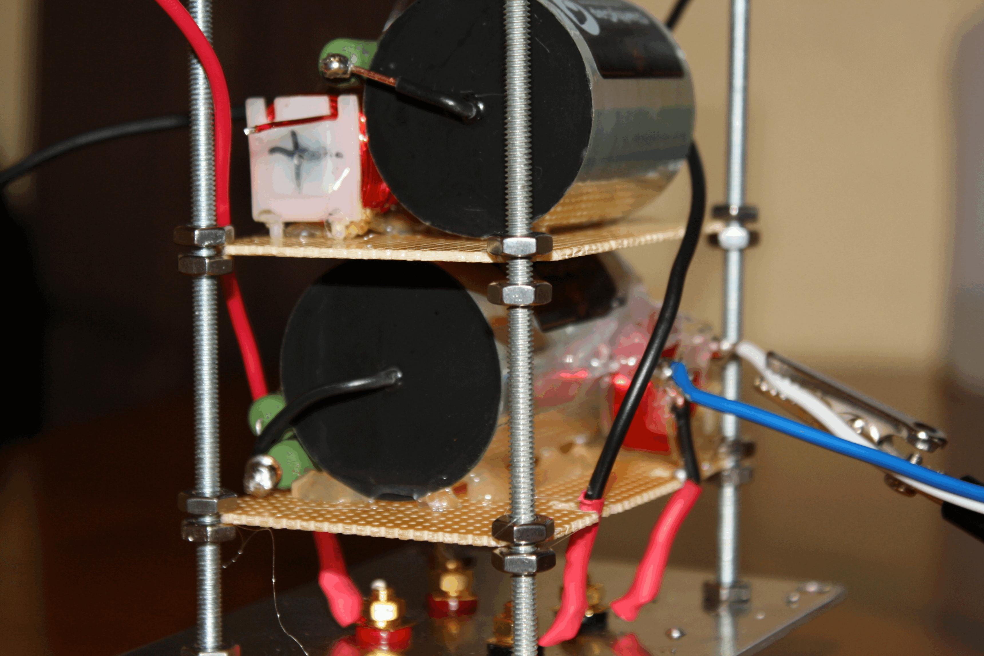

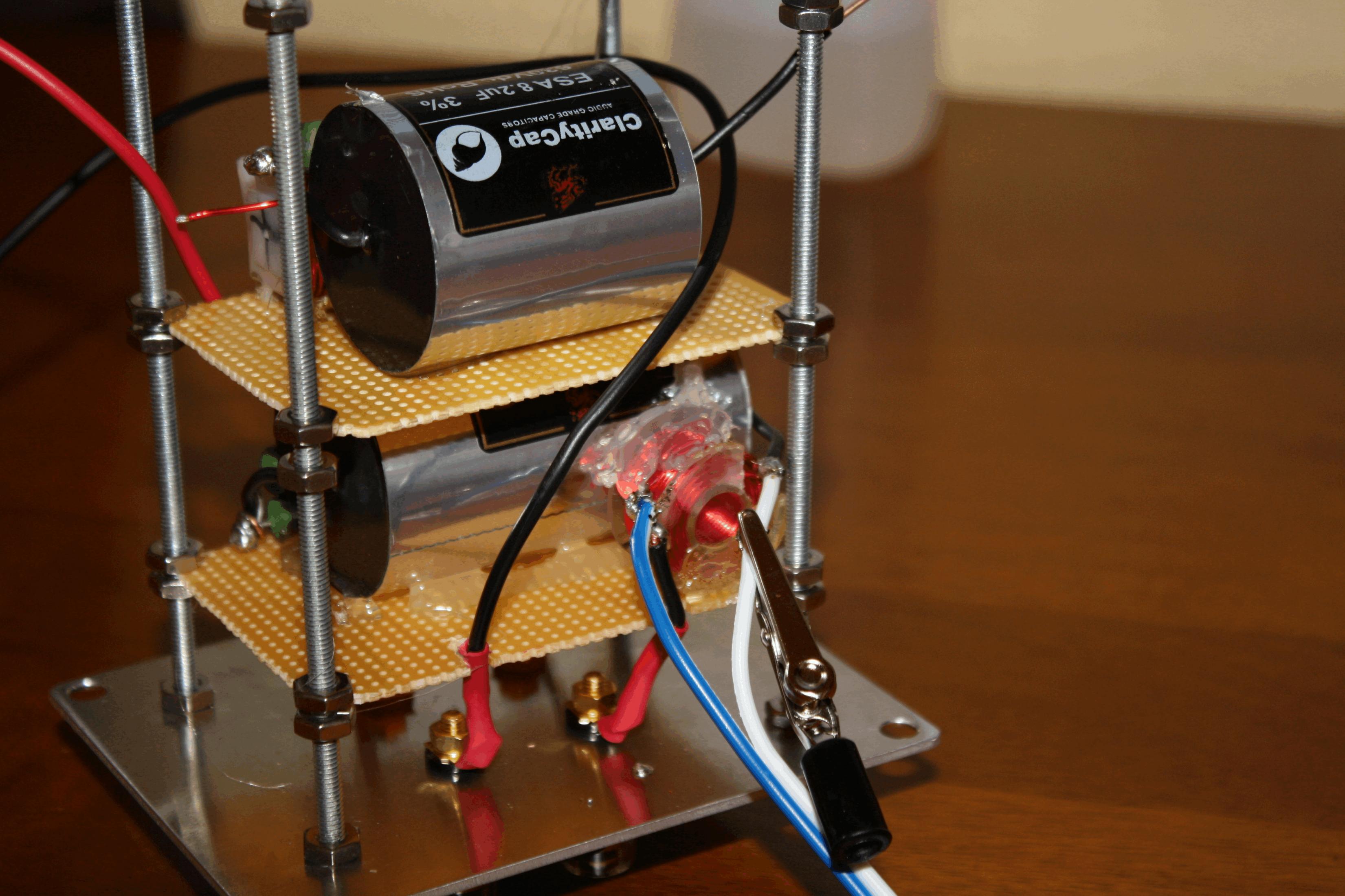

    Forgive me. Use heavier wire to connect the MB BPs to XO. Make this upgrade compleat w/better wire.
    From the photos, I can't tell if you're using the incredibly CRAPPY* existing or new wire to connect the BPs to the XO.
    From reading you're "having a bit of time" doing the work. You can't call it a "plus" upgrade w/mediocre wire. I think its a waste, from your words to go through all that trouble & not upgrade the BP connecting wire.
    * THE crapiest I've ever messed with
    Speaking from experience, take a little more trouble w/this incredibly AWESOME upgrade & "complete" it w/ better wire, heavier to the MB.
    The Polk Forum's Wire gauge fanatic, Tony
    *all connected w/Premiere ICs

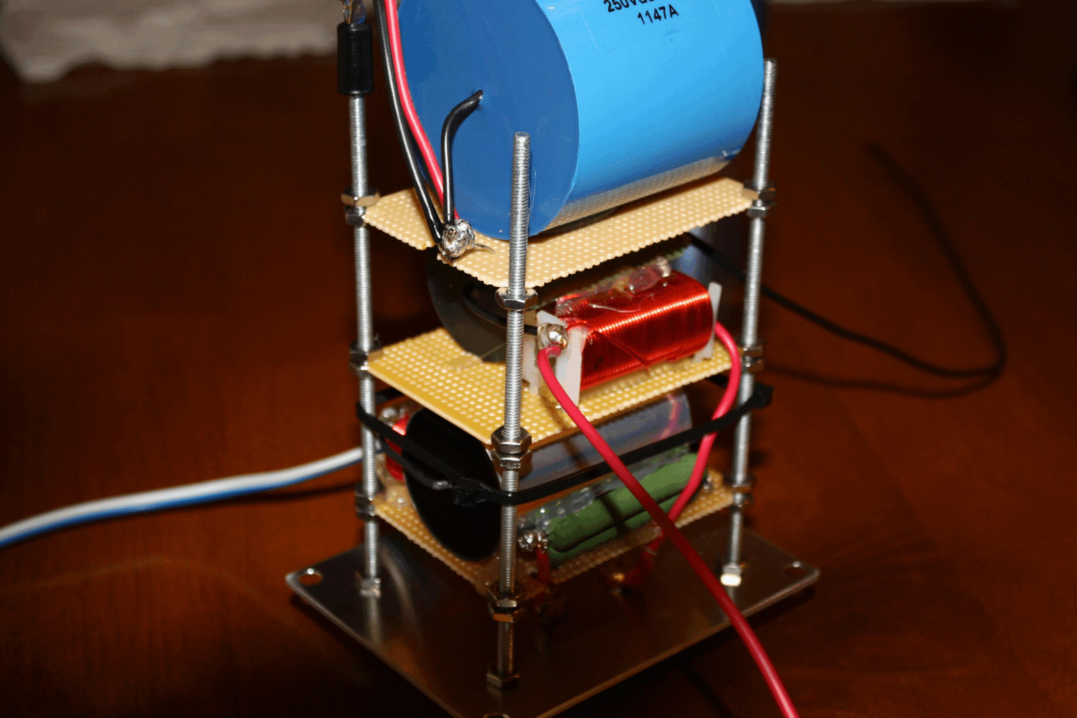

    Here are a few more pics not much more to go. Tweeter network is complete! That tiny little inductor gave me a ton of trouble.

    Gp4, I appreciate the suggestion. I know it doesn't look it in the pics but Im actually using 14g wire. I have 20ft of Blue Jeans and 105 ft of Audio Quest Hyperlitz I guess I could have used also but it seemed very hard to work with. The wire i'm using is significantly heavier gw than any of the leads on the resistors, Caps or the stock leads to the MB's. This is my first go at it and that is definitely a suggestion I will carry over to the A7's.
    Thanks Thomas

    That is an awesome Job!!! I did this early on and it feels even better doing it yourself.... Trey provides high quality parts and its a great learning experience AND he helps a lot when in a jam!
    But seriously, I wish those inductors were easier to rip off!!!! I warmed them up and started prying basically.... Those lateral ones are easier, but man this bobbin donut ones, GEEZ I snapped both my off and basically hot glued them back together!!
    Great work TommyT21!!
  • tommyt21
    tommyt21 Posts: 685
    edited October 2012
    slider2828 wrote: »
    Thanks!, LOL I know what you mean about the Tweeteer Inductor, what a Pain in the Tuckus. Hobby had a GREAT TIP. Rubbing Acohol helped a ton. It lossens the glue considerable!

    tommyt21 wrote: »
    It feels great when you hear them and you can be proud of the work too..... that is the best part besides the awesome sound.....

    Here it is guys! I still have to do some touch up stuff and I want to double check everything one more time before I load it back in the cab. Tommorrow is the $64,000 question? did i do it right lol. This was a really fun experince. Shout out to a great dude Trey, thanks for everything brotha!
