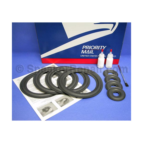

My KEF 104/2s are due for a refoam simply based on age, and I'd rather fix any problems before they happen; PM as we like to say. I've do a lot with speakers, but never this task. Are their any local Polkies who have experience and be willing to help me with the refoam project? I'd provide beer for the assistance, or whatever terms we agree on. :mrgreen:
I contacted Orange County Speaker and they can supply this kit for $80 which covers all four woofers for surrounds and donut dust covers.

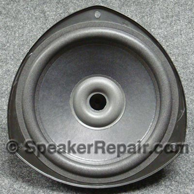

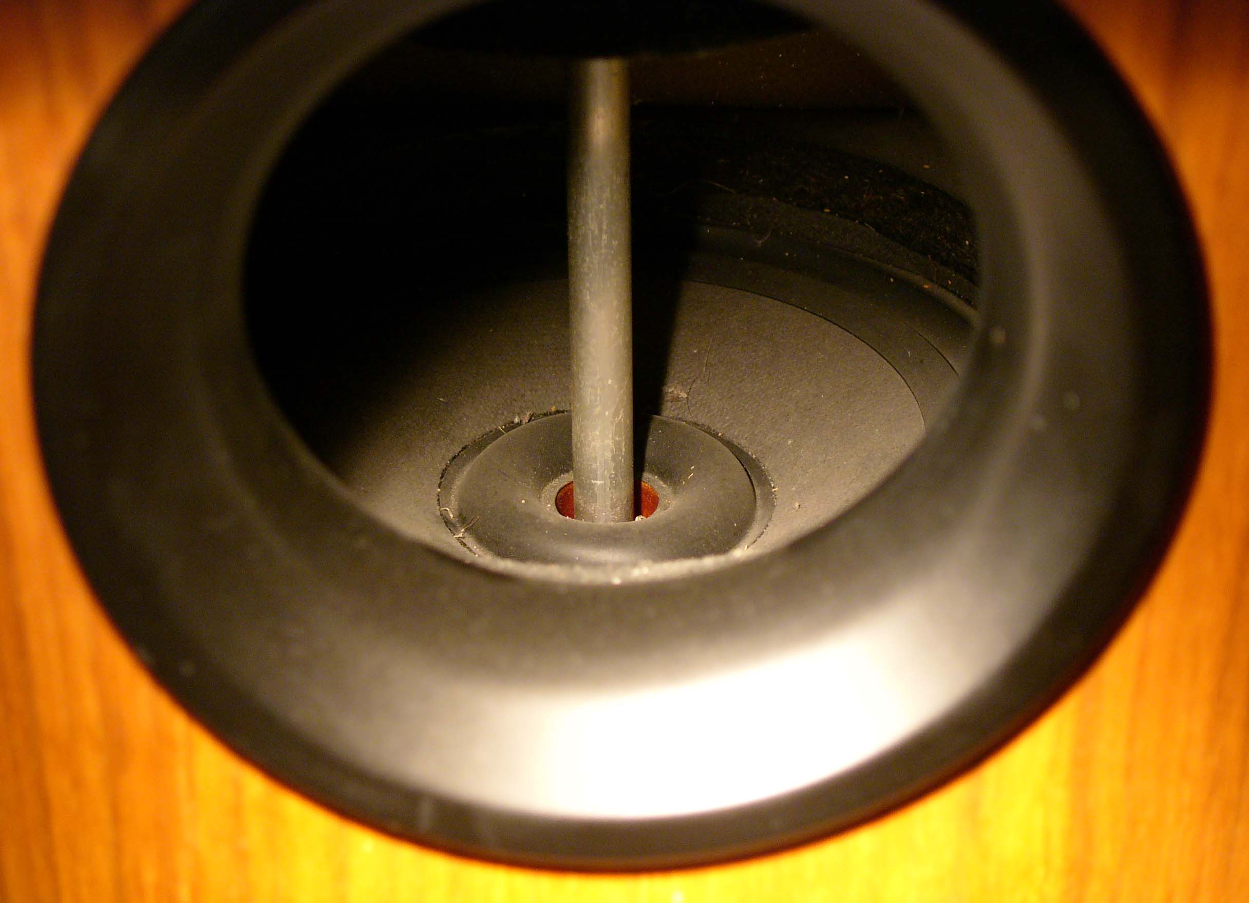

    Orange county send me these instructions when I asked them if they had any experience with these KEF speakers. The mounting system on these is extensive, but the sound quality is great.
    Here are some tips on how to disassemble the speakers:
    * Use 5mm hex wrench to remove (4) bolts securing high/mid baffle to cabinet
    * Lift baffle and unplug harness from back of baffle
    * Set baffle aside
    * Remove 8 philips head screws from bottom panel
    * Remove bottom panel and unplug crossover (make note of wire colors and locations on crossover)
    * Set panel aside
    * Remove batting material from both bottom and top of cabinet to gain access to woofers
    * Unsolder wires to woofer leads (make note of wire colors to left/right side of speaker terminal)
    * Use 10mm socket to remove bolt from back of bottom woofer and front of top woofer
    * Remove (6) nuts from front of each woofer
    * Remove green foam if necessary
    * Remove top woofer through cutout in top of cabinet
    * Remove connecting rod
    * Remove bottom woofer through cutout in middle of cabinet
    I also chatted with a local speaker repair guy who many friends have used, and he quoted me about $220 to replace both foam pieces on all four woofers. Having never done this before, do you think it's worth saving $140 to do it myself? Either way I'd have to remove them from the cabinet.

    Cracked the bottom of the speakers and they seem pretty easy to take apart and pull the woofers; more to come.
