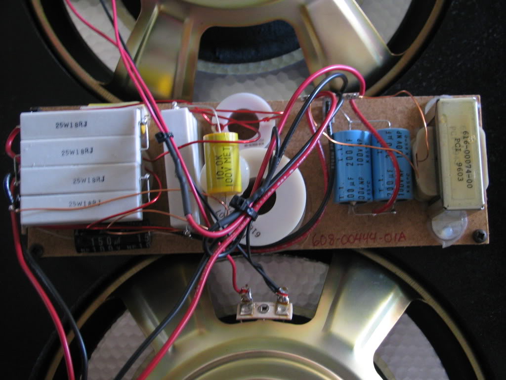

I agree. The main reason to go active is to remove the lossy, passive crossover components, and the hybrid approach does not accomplish that.
This picture alone looks like a good reason to do active...

This IMO defeats one of the main benifits of going active,vs a hybrid aproach.Since if as you say the woofers low pass filter is in the 100hz region one can assume a very large series inductor and it's associated DC resistance and it's negative effect on damping. Going fully active allowing the removal the large coils will allow the amp to be directly coupled to the woofers which should result in improvements in the bass range because of the increased control the amp has over the woofer due to the increased damping.
