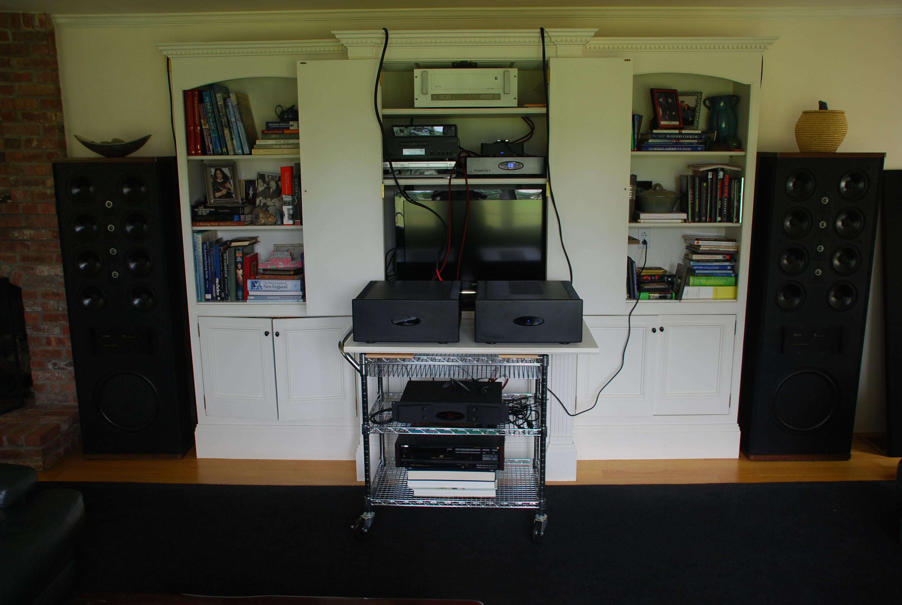

    I've attached a rather crude photo of the location of my stereo set up in my family room to give you a clearer idea of the problem I'm facing.
    First, to address Trey's comments about connections. When I bought this house, I had wall-plate connections installed behind where the SRSs are now located. When I purchased the SRSs, I disconnected the speaker wires from the binding posts in the wall plates and connected the bare wires to the binding posts in the SRSs. Next, I purchased Canare 4S11 Star Quad cables to connect the SRSs in a double-run biwire configuration, through the wall from the monoblocks to the speakers, using the existing "through-hole" access points in the back of the cabinetry you see in the picture, down into the basement, and up through the walls to the speakers. I never actually pulled the Canare cables through the walls because I bought them as an experiment to see whether higher quality wire in a double-run, biware configuration would make a difference in sonic performance. It did. My wife had a hard time listening to the rig with the Canare cables.
    Concurrently, I ordered a pair of single-run, biwire Morrow SP7 cables, which have a 60-days return policy, to see whether a much more expensive set of cables would make a difference v. the Canare cables and the original Monster wires. The Morrow cables made a difference. While my wife had trouble listening for long periods with the Canares, she literally danced to the music when the Morrow cables were used. However, the Morrow cables need to be six meters in length to run from the top shelf of the cabinet in the picture (where the monoblocks were to be installed) down into the basement over to the speaker locations and back up through the walls to the SRSs. (The cables for the Dreadnought, by the way, will not go down to the basement, but in the void underneath the cabinets to the SRSs on each side. The transformer will be on the bottom shelf of the center cabinet.)
    If I suspend the monoblocks from the joists in the basement more or less under the SRSs, then I can reduce the speaker cable runs to about half their current length of six meters. This seems to me to be a good thing, but whether it is worth the cost of retermination, I do not know.
    But the more important issue is that the top shelf in the cabinets that you see in the picture gives me only a total of eight inches of clearance for the monoblocks -- sufficient to install them, but less than the optimal amount of clearance for ventilating them. I had the top of the cabinet ventilated when I moved into the house to help ventilate the Perreaux PMF2350 that I was using with SDA 1Cs at the time (July, 1997). If I end up installing the monoblocks on the top shelf, I shall likely have a perforated stainless steel shelf fabricated to improve air flow, and I shall certainly further open up the top of the cabinetry. I also have a cabinet maker looking at installing piano hinges on the cabinet doors so they open up virtually the full width of the inside of the cabinets, which is ~40 inches.
    Now, it is probably obvious at this point that my wife's concerns are decisive in this matter. She is both a tough critic of sonic performance -- not a technical critic, but one who knows what she likes and has a discerning ear -- and a tough critic when it comes to interior decoration. Our listening "room" is our family room, and she is very understanding of my interest in getting the best sonic performance I can, while she also wants the family room to be aesthetically pleasing.
    I would love to listen to good music while staring at the Prisma 750s. They are beautiful pieces of equipment as well as extraordinary performers. However, putting them in the basement does solve any concerns about proper ventilation, shortens the runs of speaker cables, and necessitates adding a dedicated circuit for them in the basement. Eventually, I would aim at installing a PerfectWave P5 or P10 Power Plant in the basement alongside the monoblocks, and I would connect my preamp, CD player, and iPod transport to it, as well.
    Neil, thank you for your comments, which I understand and with which I agree. My comments about my wife's concerns and the peculiarities of our cabinetry above, explain the reasons that I'm willing "to bury" the monoblocks in the basement. I wish we had a separate listening room in which I could lay out my system both in an optimal configuration for performance and for proudly displaying it. As I have described above, the holes are already in the walls to pull the cables down to the basement from the preamp and up from the basement from the monoblocks. I've talked with a contractor about fabricating and installing a structurally sound "shelf" to suspend the monoblocks from the floor joists. I would not risk doing that myself.
    Nhpm510, I don't have the Photoshop acumen to create a picture of the basement configuration, but your post made me realize that I should have posted the picture of my current predicament with my original post.
    Sorry for the "shaggy-dog" post -- it is always the risk when an old English professor starts writing. I am, again, very grateful for the wisdom you have given me on this issue, as I have been for all the assistance I have received on my other issues.
    And, I shall be grateful for any additional comments. Thank you.

    I hate to ask a stupid question, but why not just put them on top a shelf that is directly on top of the SRS's? You could easily pull that off. Also just a question but how far off the back wall are your SRS's? I ask because the normal suggestion is 6 inches and it looks like yours are right up against the wall (probably to make them flush with the entertainment center). I would try to pull them out a bit farther forward so they are not flush with the Entertainment center.
    But thats just me and I fully realize compromises have to be made sometimes.

    EndersShadow, Not a stupid question. I had not even thought of that. I shall put it to my wife. My hunch is that she will not want the monoblocks placed that way, but I might be surprised. It is really a novel idea.
    The SRSs are usually about four inches from the rear wall. They can't be closer because of the length of the bananas on the speaker cables that plug into the binding posts. Flush with the front of the entertainment center is as far out from the wall as I can place them to meet aesthetic "standards," but I try to fudge it a bit!
    Right now, however, the SRSs are out of service. I have the tweeters and drivers, as well as the crossovers, out of the speakers. I'm replacing the tweeters with RD0194s. I'm putting Dynamat Xtreme on the drivers, putting Black Hole 5 on the inside of the cabinets, removing all the hot glue inside the cabinets, resealing the cabinets, and VR3 Mods is doing upgrades on the crossovers and binding post cups. In a couple of months I should have the whole system modified, up and running! In the meantime, I have to settle on the placement of the monoblocks.

    Looking at your room, I think mounting them in the basement is a good idea.

    Replace the floating panels in the cabinet doors at the bottom of the built-in with perforated wood or metal panels painted white. Place one amp on each bottom shelf with nothing above them. The amps are now out of the room and close to the speakers.
    If the top doors also have floating panels, you could replace them too.
    Move those speakers out 2 inches.

    Good, new suggestions. It would also be great if the side cabinets were deep enough for the amps, but they aren't. If I go for adding louvred or perforated doors, I'll need to consult my wife. She did agree to adding vents in the sides of the center cabinet (discretely), but I don't know about changing out the cabinet doors. They match a bunch of other cabinets in the house.
    The top cabinet also has floating shelves, and if I end up putting the amps up there, I'll likely have perforated stainless steel shelves made. My contractor also questioned whether the shelf brackets might need to be replaced with heavier duty ones. The amps weigh in at about 65 lbs. each.
    I will move the speakers out to six inches as soon as I get all the mods completed and installed!
