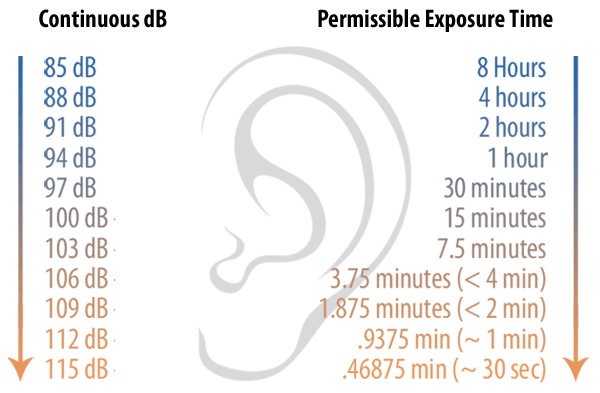

    I believe "reference level" is 90db, but it really doesn't matter. Reference level really has to do with theater, and standards for mixing, testing with pink noise, etc.
    Whatever volume sounds the best in your room with your equipment, is the one you should listen at. Just make sure you keep the levels below ruining your equipment or ears.

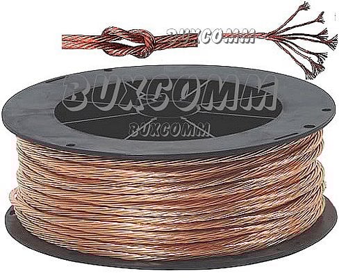

    For the lengths if the conductors we are talking about unless there is something wrong with the wires, corrosion, loose connections, cold solder joints, etc. most people are not going to hear any difference if you change out these wire for something with a larger AWG, or wires made from silver, or other metals. Nor is there any advantage in sold wire, over stranded. The one thing I would be concerned with if a larger gauge, or a solid conductor is the affect this heavier less flexible wire is going to have on the connection points on the speakers, heavy and stiff enough to damage them.
    There is one wire that would be interesting to try. Have any of you heard of Flex Weave wire? It is well known in the Amateur Radio world and we use is mainly for antennas. the insulated #12 wire has 259 strands of tinned copper wire. As the name implys it is very flexible. if not internal speaker connects it would make great speaker wire. I always purchased it from the Wireman (http://www.thewireman.com/antennap.html)
    FLEX WEAVE? 12, or 14 AWG with Black, Army Green, or Clear ultra violet resistant, very flexible PVC jacket.

    So you speak from transmitter radio experience and not actually modifying speakers?

    I have used Flex-Weave as speaker cable it works very well you do the electric drill method of twisting it together. When I purchase it I get it several hundred feet at a time so after an antenna job I have enough left over to use it for other purposes. My '95 Ford F150's sound system is wired with it still, because it is so flexible it is very easy to snake through the nooks and crannies of a pickup truck. I have not had a reason to use it for internal wiring in speakers. Next time I decide to build a new HF antenna I just might try it out.
