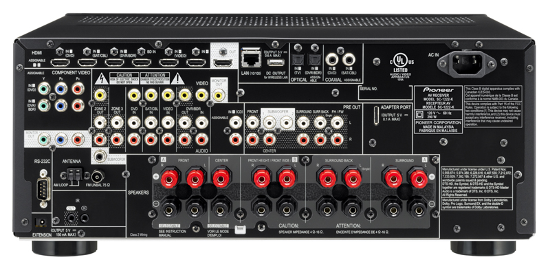

    You have NO OUTPUTS on the back of your AVR that would allow you to send the sound to an external amp. Most entry and even mid-level AVRs do NOT have that feature!
    Look at the back of a Pioneer VSX 1222 toward the middle. See the pre-out panel. Now look at yours, no such panel!
