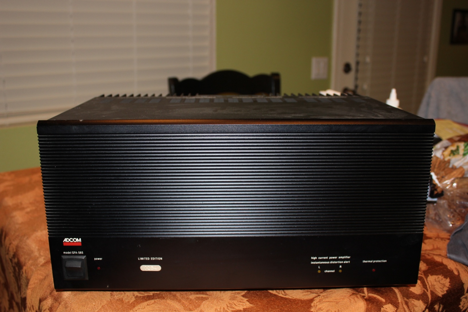

After asking and reading here I had decided on an Adcom 555 to have rebuilt. With the different models of the 555 I had no clue which one to look for so I called a man named Rick at Big Sky Audio for advice. Big Sky is listed on the Adcom page as a repair center and the only place that would discuss anything more than replacing the out of spec parts. The place in Austin told me they only replaced caps if visually leaking and did not do total replacement in one shot.
As fate would have it someone had contacted them about selling a 585 in need of refreshing due to leaking caps. Big Sky put me in contact with the owner out in CA. We came to an agreement with the amp due to hit the shop tomorrow. Estimated turn around is two weeks.
While the amp is in for service are there any upgrades over the basics that should be considered? I will be swapping the power for a detachable cord. They seem to have a stock of Blackgate caps. I have read good things about the Blackgates but wonder if they are worth the extra money. I have also seen where longevity might also be in question.
The 585 has enough power to blast my 2a's into orbit so increasing power is not a concern.
Having spent my working life in and around industrial shipyards I doubt I could hear subtle differences anyway.
Any thoughts?

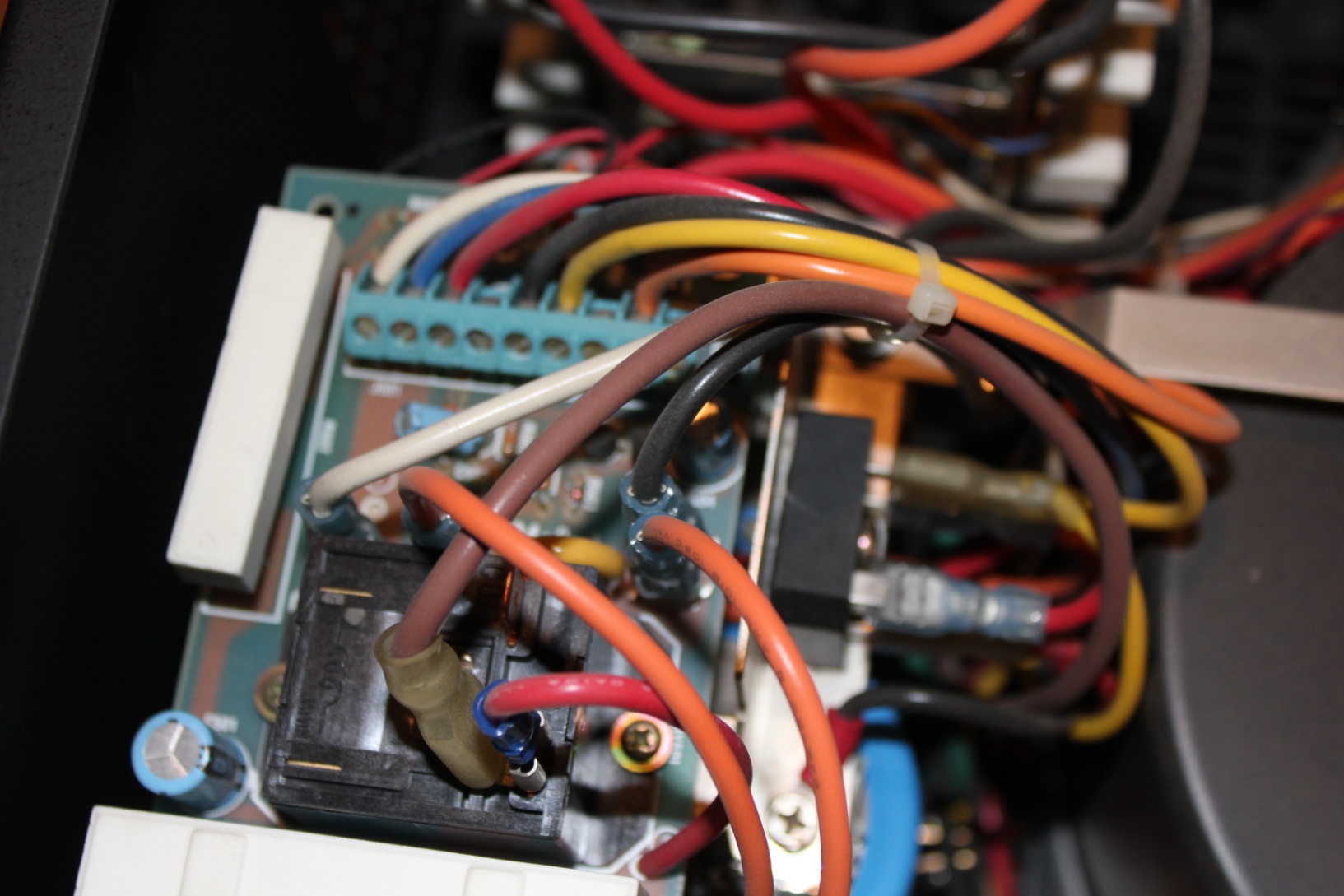

    Here are a couple of images.
    ad1.jpg 421.7K
    ad7.jpg 487.1K

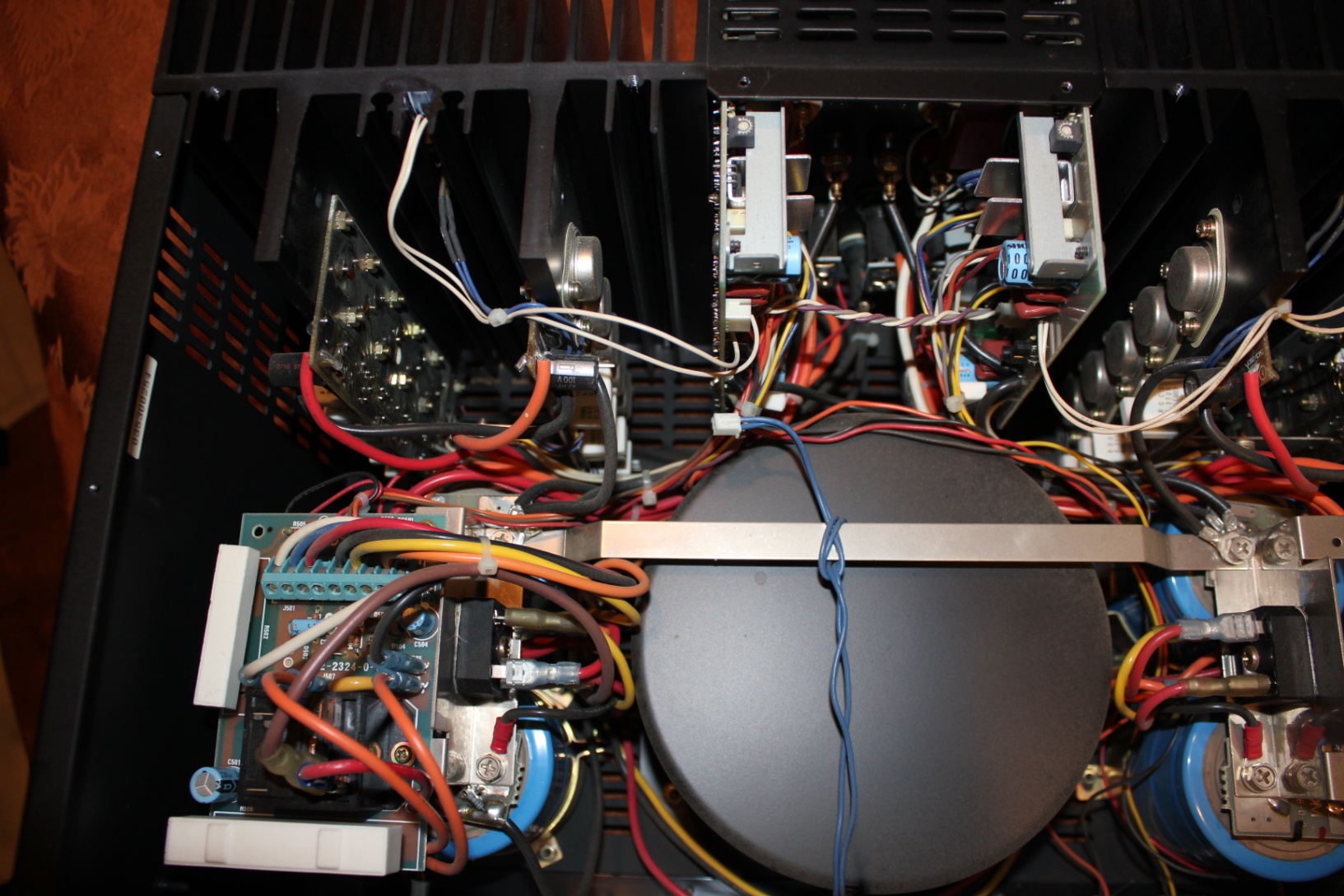

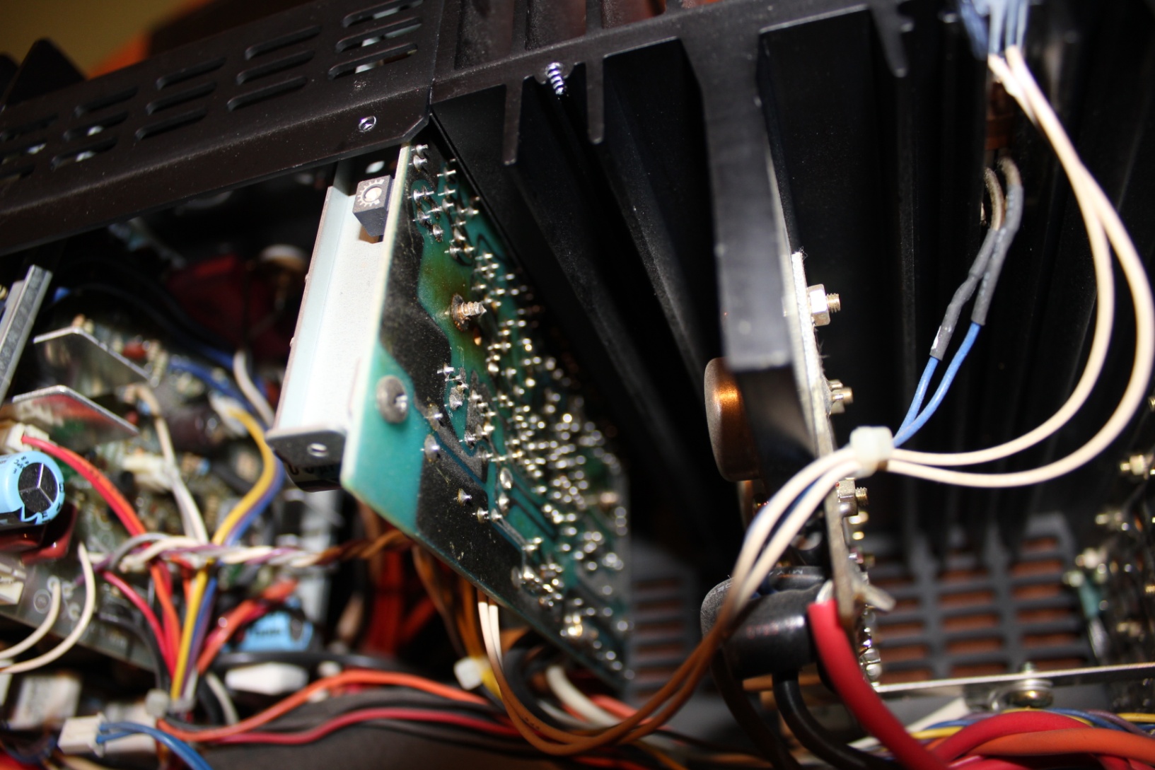

    Here are a few more images.

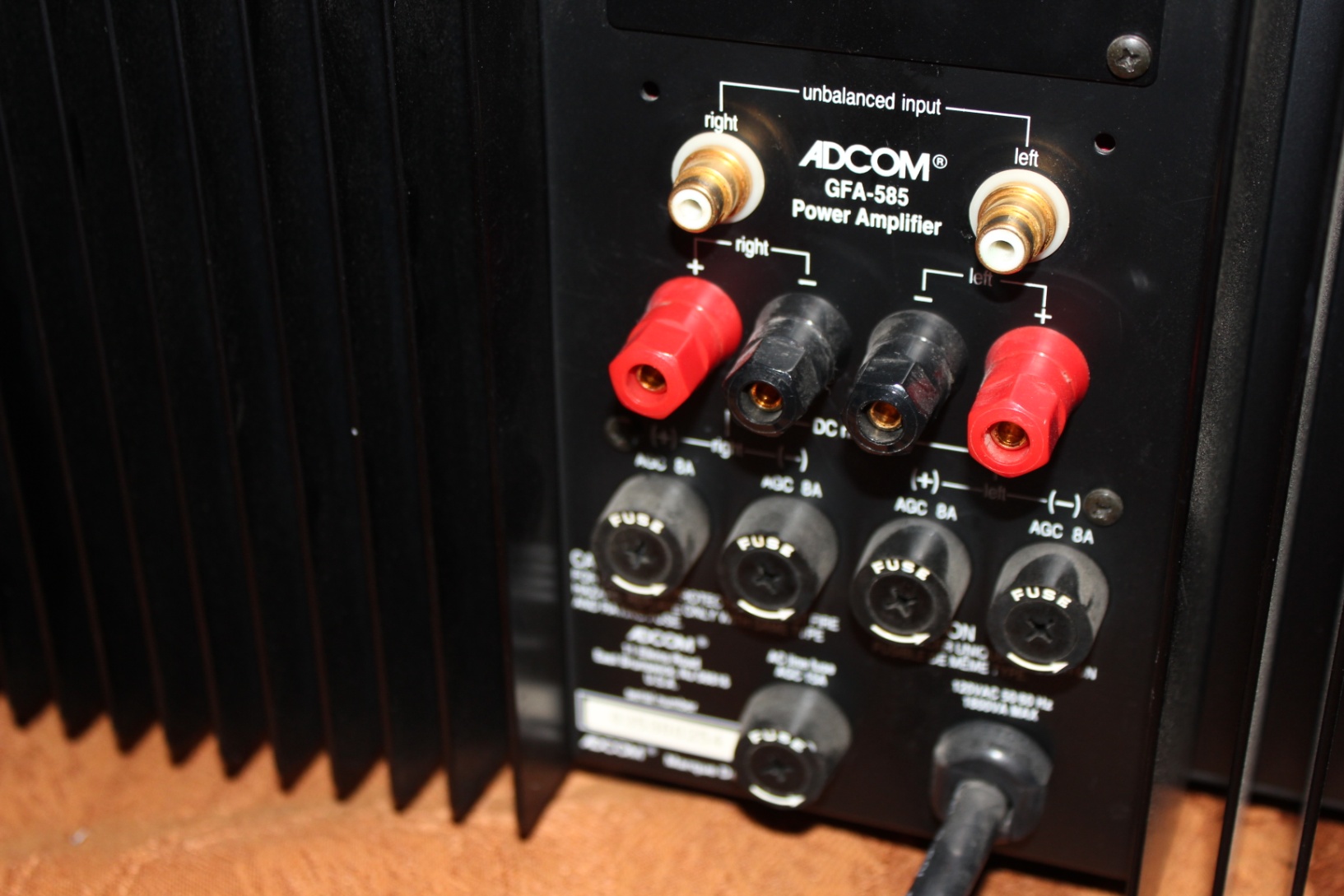

    IIRC, the 585 is a non-common ground amp so unless the negative terminals can be strapped then you can't use it with those SDA's. Early SDA's like your 2A's can't use the AI-1.
    That said, a refreshed 585 is a very nice amp. IMO, at this point the cost of Black Gates isn't worth it. Panasonic FC's are a very good choice (for the power supply) and hella cheaper. Nichicon Muse or Nichicon FG or Elna Silmic for signal path electrolytics are very nice.
    P.s. if you search the archives, IIRC the negative terminals can be strapped to create a common ground. But please check with someone before doing it. Maybe FTGV will chime in and confirm.

    Hopefully the damage from the leaking caps hasn't damaged the PCB's. The only soultion is to strip them and clean them. Replacement PCB's haven't been available for quite a few years. If the electrolytic gunk sits on there too long it will ruin the traces. Do you know how long the caps have been leaking or how long it's been sitting in that condition?

    The 585 will need to have the grounds tied together. Definitely something to stay on top of to be absolutely certain. First do no harm

    The AI-1 is a better sounding solution than tieing grounds together. If in the future you own SDA's that can use the AI-1 that's a better solution than tieing grounds. Nothing to forget, you buy a couple heavy duty spade terminations for each end of large cable and put them under the speaker nut.
    Clean, simple, cheap and completely reverseable.
    There is a reason certain designs are not common ground so I would un-do the strap if I wasn't using SDA's to return the amp to it's intended use, but that's just me.

    It wouldn't be a problem for future speakers, but you'd lose some channel separation. A toggle switch would be super easy to implement: one position and the negatives are connected, the other position is just open.
    I'm looking at the schematic, and I'm pretty sure the negatives are at ground potential, but the scan is pretty crappy and split across pages, so have your tech confirm.

    To clarify: There are some designs that are not common ground and cannot be made so: these tend to be high-power designs where you basically have two amplifier modules per channel run in series. Put differently, it's a pair of stereo amps, each run in brigded-mono mode crammed into one chassis. On these amps, the negative terminal is the inverse of the positive terminal and strapping the two negatives together will fry your amp.
    The other "non-common ground" that can be made so are dual-mono designs where the left and right channels are completely isolated, but the negative terminals are both at ground potential. These can be made to work with SDAs by strapping the ground together.
    I believe that the 585 is the latter type.

    I think H9's solution of strapping the negatives together with a short piece of speaker cable is safer. If you have a toggle switch installed it'd be too easy to inadvertantly flip it to the wrong position.

    Yes your good to go.It's a non bridged output stage so each channels negative terminal is connected to ground.However the two channels grounds are isolated from each other with 6.8 ohm resistors so strapping would be required to make those grounds common.
    Hopefully the electrolyte has not wandered to far from home since it could potentially cause issues(ie. noise,offset) even if it appears the tech has it all cleaned away.

    We know there has been some leakage and the images did show some signs of the leaks. Rick seemed to think that it was isolated to only small areas. We are hoping for the best but nothing is known for certain until he gets it on the bench. I have no idea what is involved in Adcoms tech bulletin that covers cleaning. He seems to be able to a good job cleaning and has resurrected a number of these over the years. As long as the residue has not gotten under the traces I am good to go?
