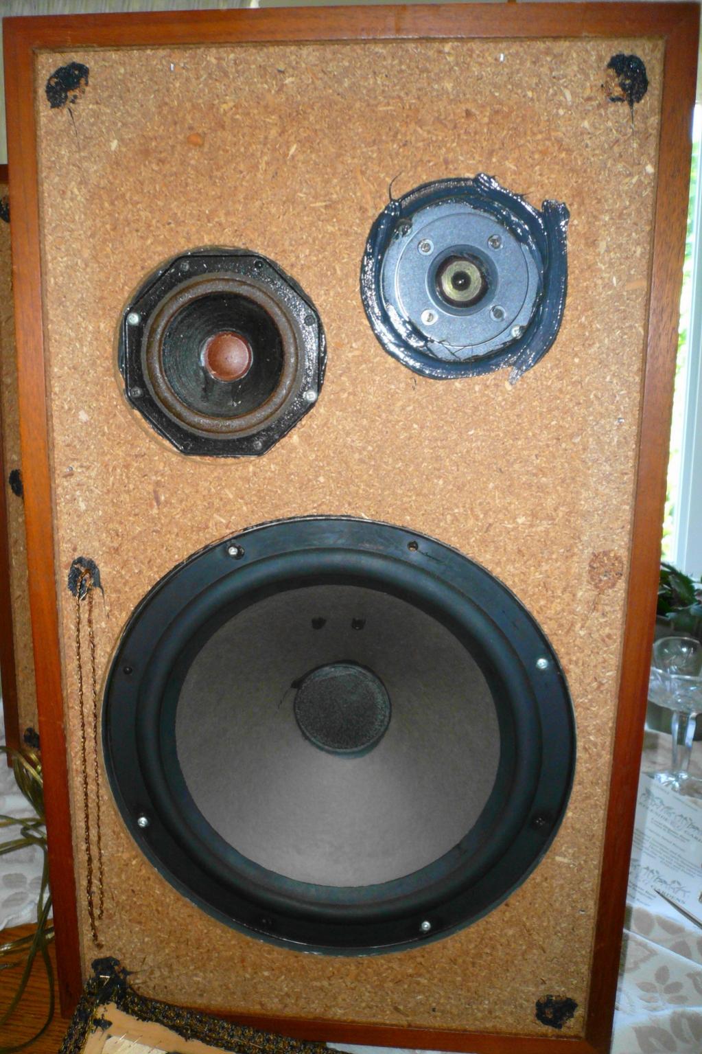

Hi, I bought these speakers today from a 93 year old man who bought them in the 60's with a Harman Kardon system.
When I opened them I saw one of the cone covers had come off on one speaker.
They way aproximately 40-45 lbs and measure 27" high and 16" wide and have a wood veneer covering. They are
in pristine condition.
My question is are these worth repairing?
Many thanks for any input, Joyce

    Guess it would be helpful to put the image
    mhardy6647 Posts: 35,041
    edited August 2012
    Well... the midrange and tweeter are very nice Philips drivers.
    They are not junk; perhaps RtR speakers or one of several other brands which was closely related.
    The alternative is that the MR and tweeter were "aftermarket" replacements. In that case, all bets are off - possibly HH Scott or Sherwood, from the days when they were still US companies. Neither originally used Philips drivers, though, AFAIK.
    If you pull out the woofer and look on the basket or cone, you may well find the EIA manufacturer's code and date stamp for the actual manufacturer of the woofer. You can find the secret, magic listing of EIA mfgr codes at www.webervst.com/codes.html :-)

    The W8 335 AH looks like a Philips number; so maybe all Philips drivers.
    Have you listened to them yet: they should be pretty good.
    If you feel like investing a little effort into them - the speakers' crossovers could benefit from refreshing with new capacitors... if you dig around at sites like this or www.audiokarma.org you should be able to find information on crossover upgrades (or many of us could 'talk you through' the process).

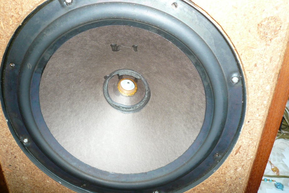

    I am concerned that the cone cover on one speaker has crumbled off and probably should have that repaired.
    This is what i mean, sorry, I am not very up on the jargon but eager to learn. Thank you for responding drumminman:))

    Hard to tell, but it looks like from your pic that's a rubber surround. Unless they get a hole poked in them they last just about forever. The dustcap is what's damaged/missing.
    That should be even easier to replace than the surround. Just need to be careful when cutting out the remnants of the old dustcap. I believe the new one will be simply glued in place. The outfit you purchase it from should have it, glue and directions.
    You might want to connect the speakers first to be sure they work, have no other issues.

    Dust caps are readily available from many different sources, e.g., www.partsexpress.com (full collection of speaker repair parts, but they have a minimum order). A product called "Aileen's Tacky Glue" - readily available from arts and crafts stores such as Michael's - is ideal for gluing dust caps to (paper) speaker cones, and also for replacing surrounds. Your rubber surrounds should last essentially forever, though.
    http://www.michaels.com/Aleene's%C2%AE-Original-Tacky-Glue%C2%AE/gc0040,default,pd.html
    If you're in the US, I'd be happy to throw a dust cap in the mail (with instructions) to you if you wish; just PM me a mailing address and it's yours!
    It is worth replacing the missing dust cap - it keeps crap out of the (magnetic) gap! :-)
    EDIT: This tutorial on re-foaming speakers will tell you more than you need to know! You can disregard almost all of it :-) just note the steps on removal and reattachment of the dust cap.
    http://www.decware.com/newsite/refoam.htm
    Because the woofer's properties (Thiele-Small parameters) will be somewhat affected by the weight and porosity of the dustcap, the "best practice" would be to replace both... that said, replacing th missing one will get you most of the value; replacing the other one with a dust cap that matches the "new" one would be incremental.
