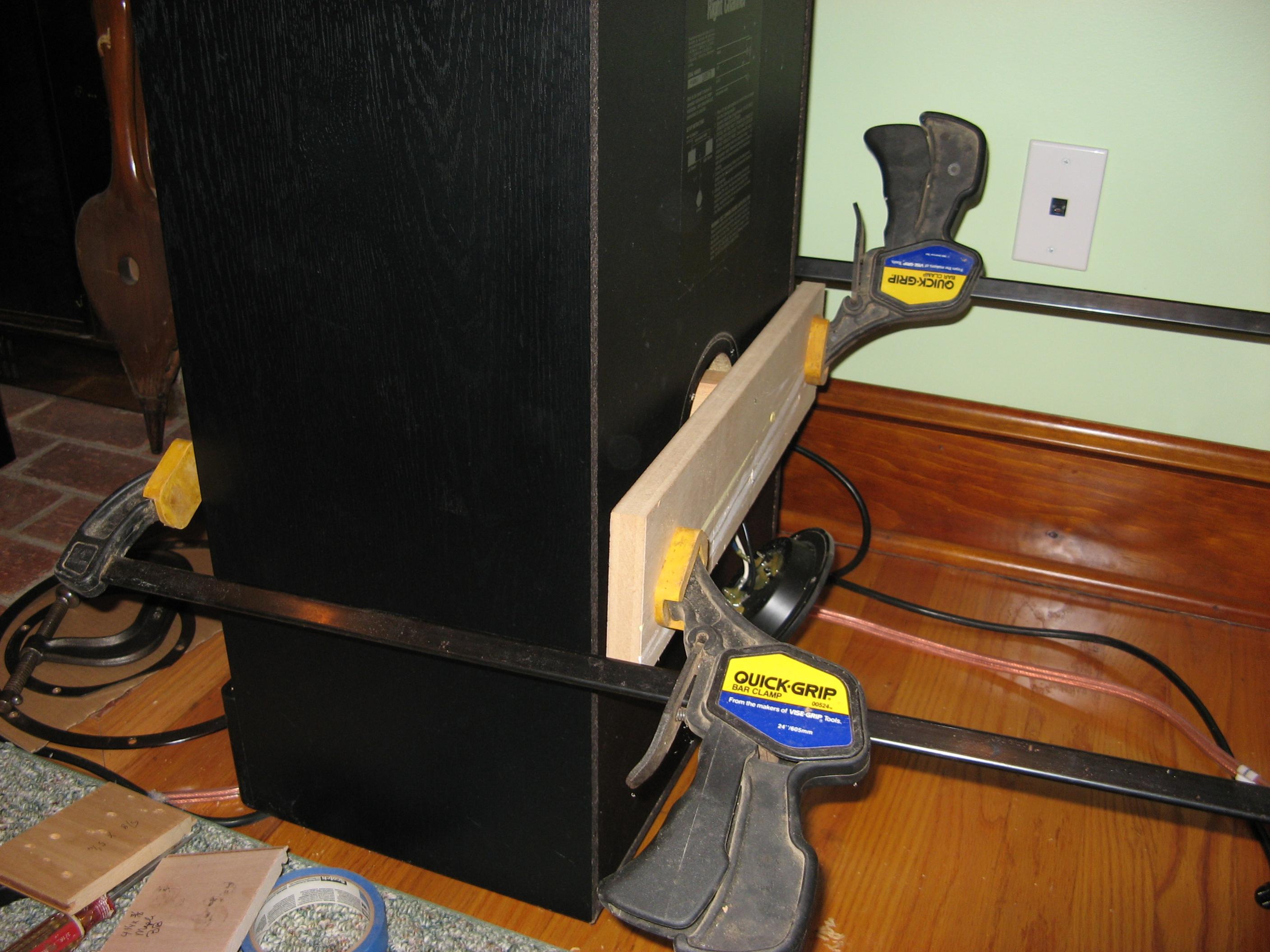

    The stuff I used was a rope caulk and not the Mortite brand. I don't remember what brand but I seen a post(s) where someone asked about a different brand than Mortite and was told it would be OK. Well, I do have them out and have been spending the day cutting the Armacell gaskets and doing the Dynamat and installing the rings in the Left speaker. I will wait until next weekend for the Right one. Installation of the rings went well except for the left hand driver. The center partition was not centered and I had to modify that ring becuase it was not going to go in even with the flattened edge. Thanks for all the suggestions. I'll try to post a pic of my method of PR removal when I get to the Right speaker.

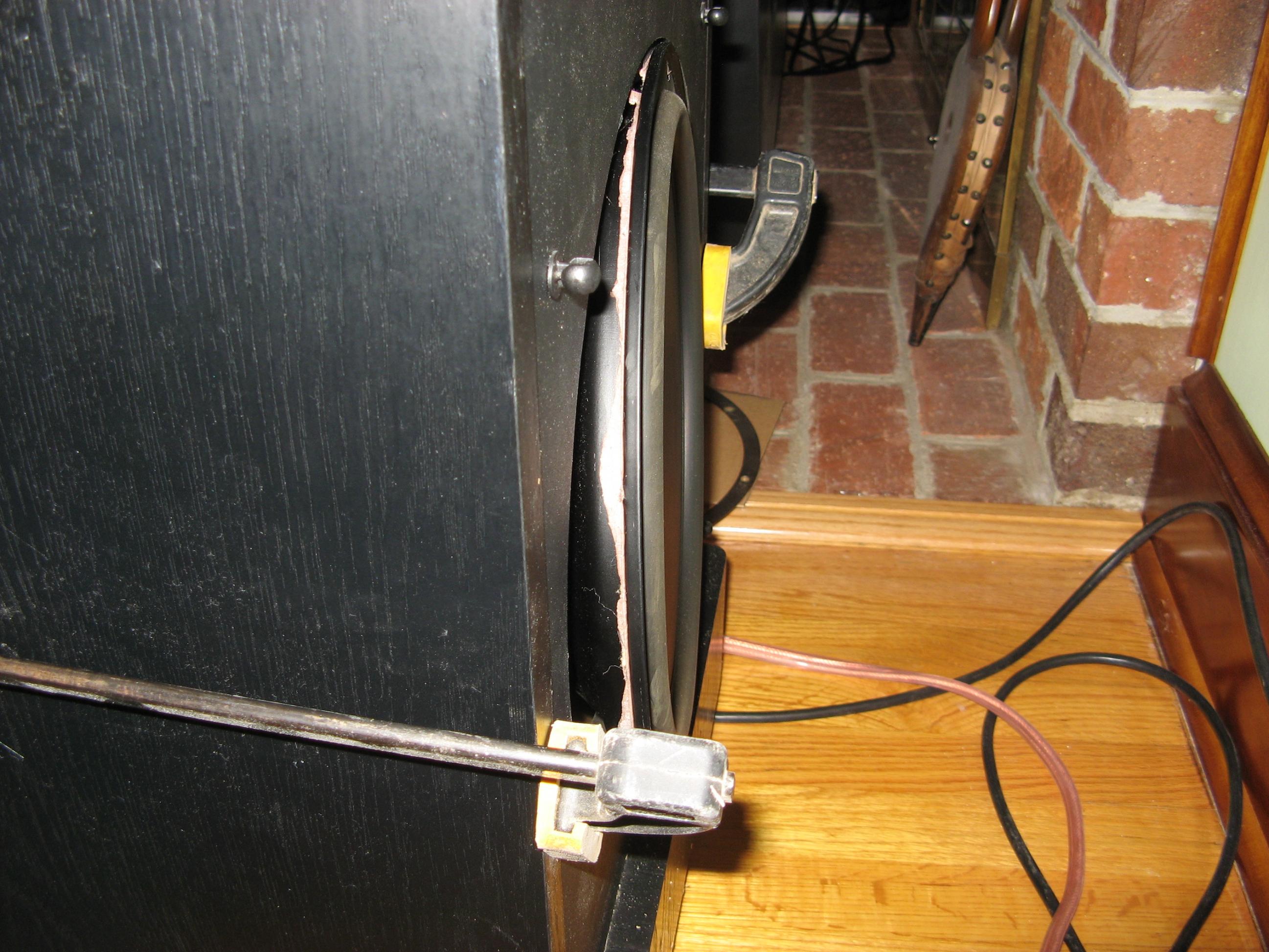

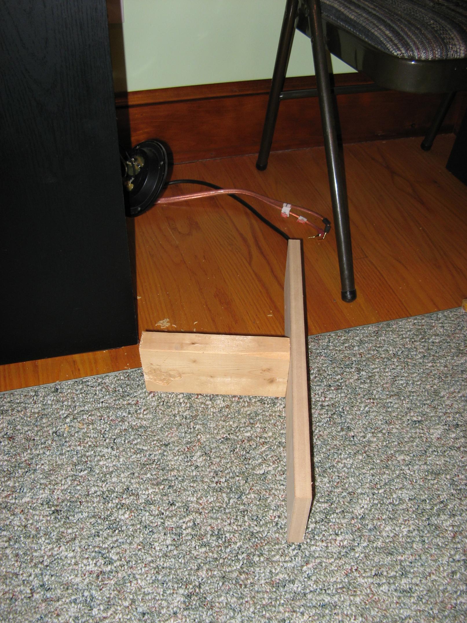

    Update on the Right speaker. The drivers came off easily with paint can opening tool. The rope caulk came off without sticking. I had to use my wood "T" and clamps to get off the PR. It took more effort to remove than the Left speaker. The caulk even pulled off some thin strips of wood. I installed the rings and used Armacell which made a good seal where the strips pulled off. It was really "glued" to the cabinet. Here are some pictures demonstrating my explanation of the wood "T" earlier. Maybe if I had used the Mortite brand, I wouldn't have had this problem. I'll stick with the Armacell for now!
