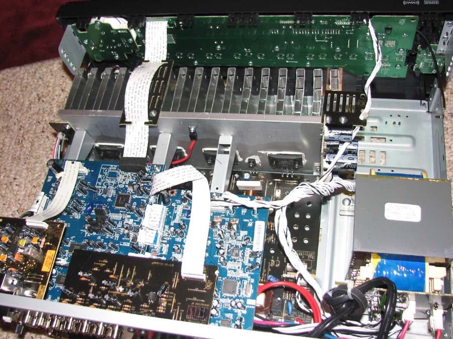

    I see a lot of empty space and standard electronic switching power supplies where I would expect to see large, toroidal power supplies and heatsinks. Not a sign of a high quality component.
    This is the inside of a HK 990:
    I would feel much better recommending the 990 if you want to stick with HK, but that is a $1,700 receiver (on Amazon).
    The point is that if you go with something like the Outlaw, it's going to have much higher quality internals at lower price. The Outlaw does use a toroidal power supply.

    Syndil wrote: »
    I think the HK 3490 would work fine for you, but I think you could do better at the same price range. Looking at the internals of the 3490:
