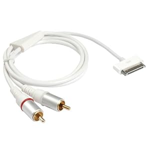

    Deoxit should do it.
    And also, get one of these: It sounds better.

    I am debating buying a LOD to RCA cable for my iPhone to hook this all up. I am torn however as I also have a portable headphone amp thats hopefully showing up soon and I dont really want to get 2 LOD cables (they dont take the same one :sad).
    I think I might just listen to both for a bit and after hearing which is better stock get a better cable for that setup to start with...

    Joe already one step ahead of ya :wink:
    Looking at either one of these (for the yamaha):
    http://www.ebay.com/itm/IPOD-IPHONE-LINE-OUT-DOCK-RCA-CABLE-PURE-COPPER-3ft-/250809837834?pt=Other_MP3_Player_Accessories&hash=item3a656e690a
    Or one of these (for the headphone amp):
    http://www.ebay.com/itm/IPOD-LINE-OUT-DOCK-LOD-HEADPHONE-AMP-SILVER-COPPER-/250888867648?pt=Other_MP3_Player_Accessories&hash=item3a6a244f40

    Ender, glad to hear your ordering a different hook up. Your ears will thank you.
    I have done the old 3.5 to RCA route and the Ipod to RCA is just a thousand times better.

    Yup, really wish that PEPSTER made LOD cables so I could keep it in the family but he isnt there..... yet :wink:.
    For just casual listening at work (with one headphone ear off anyway) it sounds pretty darned good.
