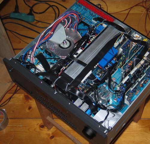

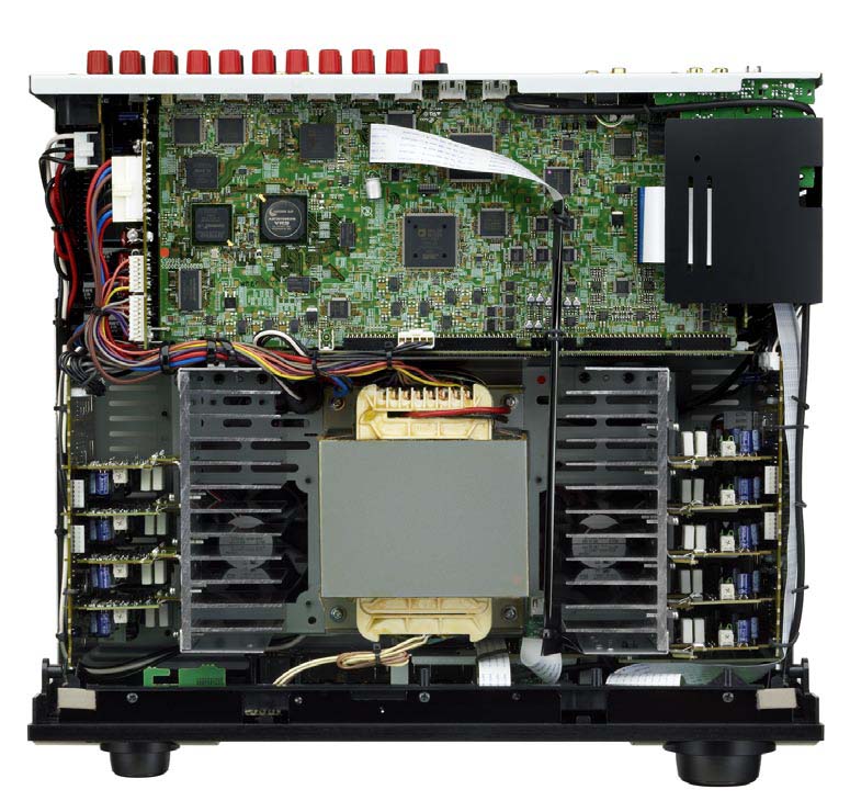

    Your AVR has only one power supply for all the channels, therefore it is incapable of bi-amping. Some might call what you're doing passive bi-amping, I call it ghetto bi-amping. True bi-amping not only requires separate amps, but active crossovers as well.
    He had the left and right speakers swapped. I didn't notice this until after I got the speakers home and unpacked them. When I heard the speakers at the owner's place, I was not impressed, but thought that it might have been due to his amplifier or acoustics. I'm glad I bought them anyway!
    The AVR has only one power supply, but as far as I understand, separate amplifier circuits for each channel. With one channel, I am limited to 140 watts per amp, but if I bi-amp, more of the power from the power supply is available to the speaker. The product description says "The equal power amp design features 9 discrete power amp circuits, and each channel is rated at 140 watts (8 ohms, 20 Hz to 20 kHz, .08% THD). The amplifier section also features the ability to easily handle 4 ohm speakers." Presumably the amplifier power supply can drive all 9 channels and should therefore have a fair amount of power handling capacity, at least as much as I need anyway. I have been up till now, using two RTA12Bs in addition to seven Monitor 5jr's which are 4 ohm speakers. There are specific Bi-amp settings in the receiver for this application.
    I can't debate true bi-amping, but I think I am achieving my objective, which is to supply more power to the speakers.

    You aren't. Think of it this way, a 4 wheel drive truck in 2 wheel drive or 4 wheel drive still has the same horespower. HP doesn't magically increase just because you engage the other two wheels. Same with the AVR, the power output is limited by the power supply and in those receiver current limiting, no matter how many channels you have running. AVR's can NOT properly power a pair of SDA's. When I say "properly" I am talking about getting the best performance from them. Congrats on the new SDA's.

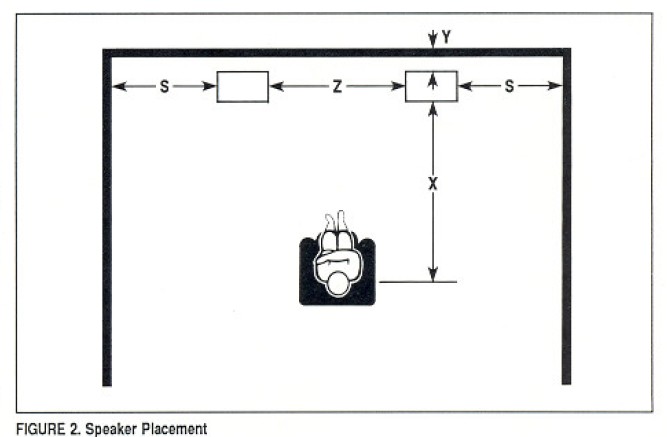

    Ok, it does sound like you have them set up correctly now. Just to check, you should have the row of 4 drivers on the outside edge.

    This is where the power supply limitations come into play. The more channels the AVR has to drive, the less power per channel it can provide. It says each channel is rated at 140 watts, but that is a not with all channels driven, probably only 2. By the time you get to driving 9 channels the wpc will have dropped considerably, so by bi-amping you are driving all of the speakers with less power.

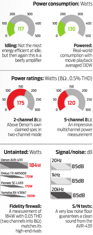

    I'm not an electrical engineer, so I can't really argue these points. This is the information upon which I'm basing the decision to bi-amplify is essentially that I called Denon and asked if there was any benefit in doing so, and they said absolutely yes. I'm not saying that anyone else should use an AVR, or that anyone is wrong to say that I shouldn't "ghetto bi-amp".
    Regarding the capabilities of this model, here are the results of independent testing, which show that Denon's specs were slightly conservative:
    http://issuu.com/homecinemachoice/docs/hcc193denon?mode=window&pageNumber=6
    Also worth noting is that since I have a horrible bass resonance problem at 46hz, the speakers are running with a LPF of 60hz, with low bass re-directed to dual subwoofers on opposite sides of the room. This cancels the bass buildup as verified by SPL measurement of 1khz stepped frequency test tones, and also presumably reduces the power required by the SDA speakers since the subs have their own amplifiers to reproduce these frequencies.
    In any case, I am quite pleased with the sound of these speakers, and unless my receiver starts to suddenly experience audible distortion or thermal shutdown, there is no way I am replacing it since I _just_ bought it. Additionally, I can't and won't be listening to any of these speakers loudly, partially because I live in a condominium, buy mostly because I find that fatiguing and prefer moderate to low volume.
    Regarding 5jrs being an easy load, I can tell you that with just 5x5jrs (before I got the RTA12Bs), my previous AVR-4306 would experience thermal shutdowns at even low volume, forget about including the RTA12s. The 4311 has never had any such issue even with seven 4 ohm speakers driven. Hopefully this means the current model is better suited to this type of speaker.

    Again, if you call the company that made the product, they are usually biased so of course they are going to tell you what you want to hear. Try it and if for some reason you hear a difference, then more power to you. But passive bi-amping usually results in no difference for all the reasons already stated. You can magically make more power by using a seperate channel that gets it's power from the same source.
    You won't get 280 watts to each speaker by passive (ghetto) bi-amping. Electricity doesn't work that way at all. The thing you are missing is we have been there and experienced what you think you are trying to do, what you are thinking and what happens in reality aren't even close. Because you don't understand basic electrical current flow, etc.

    I misunderstood the reason for bi-amplification with this receiver, as I thought that each circuit was strictly limited to 140w, which is less than the power output capability of this unit in stereo. The total power consumption of this receiver can go as high as 780 watts, so I thought that I would need to maximize the number of amp circuits used. I thought that in order to get the full output of the receiver to the speakers, I would need to bi-amp.
    This seems to have been an error on my part, as the independent testing seems to indicate stereo output at 8ohms at 175w (>140w). I can conclude that with a single set of speaker wires, if these speakers are 6 ohm, I should be getting ~185w per channel which is probably adequate for my listening needs. I understand that the recommended power is 50-750w. I do have an NAD T763 300w receiver in the other room, but it is not well suited to my AV setup which needs a lot of HDMI inputs, and Denon Link for digital playback of SACDs and DVD-Audio. That receiver is powering five Monitor 5jrs that I use as recording studio monitors. There is an 800w QSC amp in the basement that I can try, but I am sure is quite excessive for my needs. Does anyone here run SDAs with that kind of power?
    Also, it is not that I don't understand basic electrical current flow, it is that I do not know how this or any amplifier is designed; I don't exactly have schematics. The literature, some of the discussions, and Denon technical support all indicated a clear benefit from bi-amplification. When I look for answers on the Internet, I seek a consensus, and this was the consensus until I posted here. I get that the power supply can only output X amount of power, but between that and the speaker outputs, I have no idea what is being done, and assumed that I was getting around a published bottleneck. I can admit if this was not the case.
    So my question would be, is there any advantage or disadvantage to passive bi-amplification?

    On to other topics, what is the reasoning for using spikes
    They make the speakers sound better.
    what can I do with regard to speaker placement if the center (vocals for example) are distant sounding
    Adjust the speaker level via the menu in your AVR.

    I'm not talking about the center surround speaker, which is not enabled when I am listening to the SDAs in stereo. I mean, that when a stereo recording is played back on other speakers such as RTA12's the center image is strong and clear. On the SDAs, it seems that the center if muted and distant. I don't know if this is because I have the speakers too far apart, not far enough apart, or if my seat is too far or too close. I can't easily move the speakers around, so I would like some tips before I attempt to do that.
    Thanks
    Check to see that the speaker cables are connected in phase, that is + amp terminal to + speaker terminal, - amp terminal etc.
    Also, check your receiver speaker settings to be sure that's not causing issues. Not familiar with the Denon set up so I can't give specific advice. Should have a great center image like the RTA 12's but with a wider and deeper soundstage.
    heiney9 Posts: 25,217
    edited June 2012
    Center image should be very strong so I would first experiment with placement a little bit, if they are too far apart in relation to your listening position that could be part of the cause.
    That's a bit extreme.
    heiney9 wrote: »
    AVRs tend to be compromised devices, but there's nothing inherent in the concept that would prevent them from being a fine method of powering a pair--or many--speakers. The problem with AVRs tends to be in the implementation--not in the basic concept.
    heiney9 wrote: »
    I don't accept this.
    There are any number of multi-channel amplifiers that can provide full rated output with all channels driven. Sharing a common power supply does NOT have to limit the output of the amplifier modules IF (big IF) the power supply is robust enough.
    Passive "ghetto" bi-amping may or may not "improve" the sonics, but it certainly will provide additional current to the speaker. The voltage will be limited by the rail voltage within the amplifier, but having additional output devices could allow higher current before overloading the transistors. Same voltage, more current available = more potential power delivered. Whether that's a benefit or not depends on many things, and at any rate I don't think it's going to affect the volume the speakers can achieve since the voltage delivered doesn't increase.
