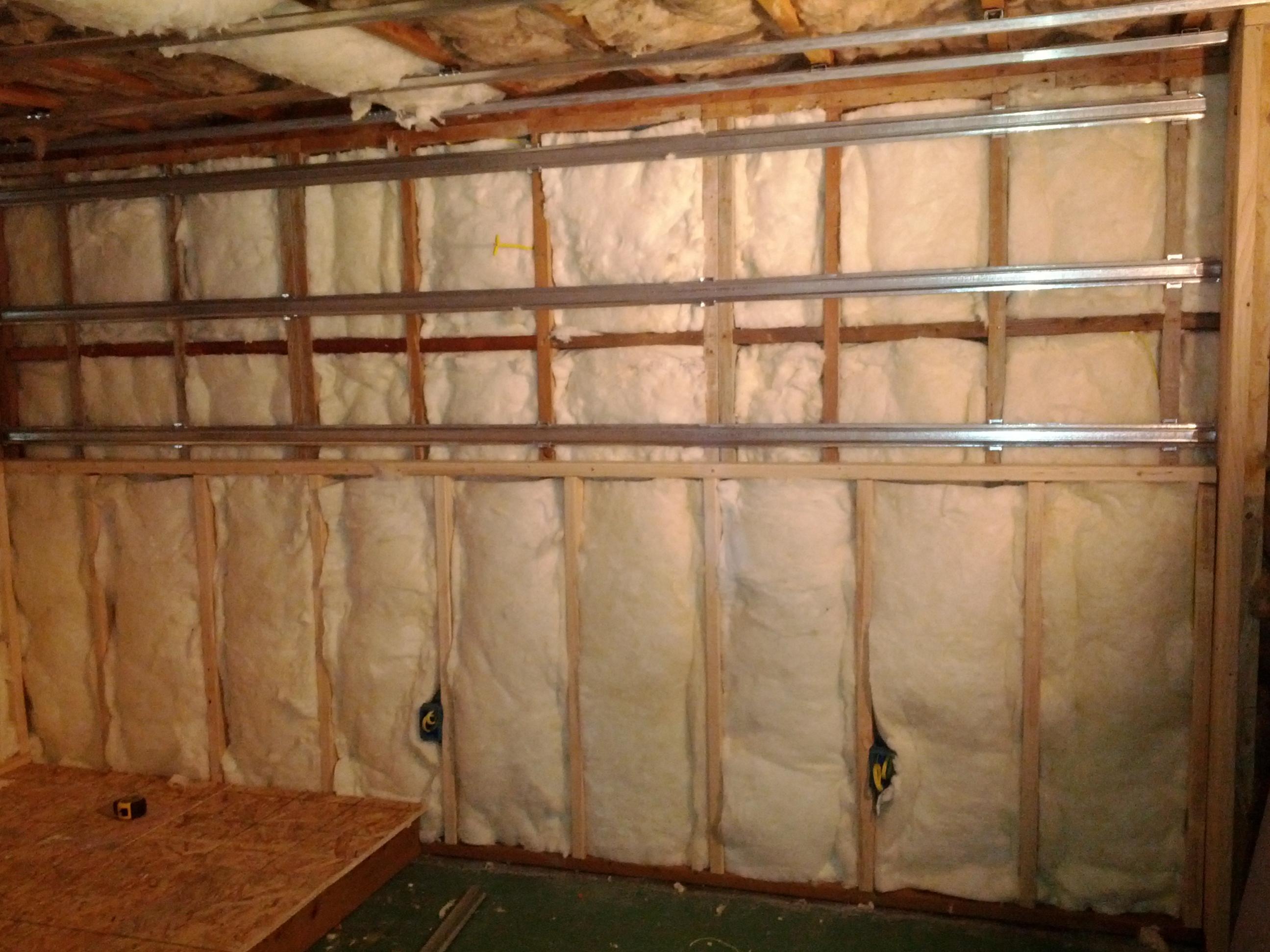

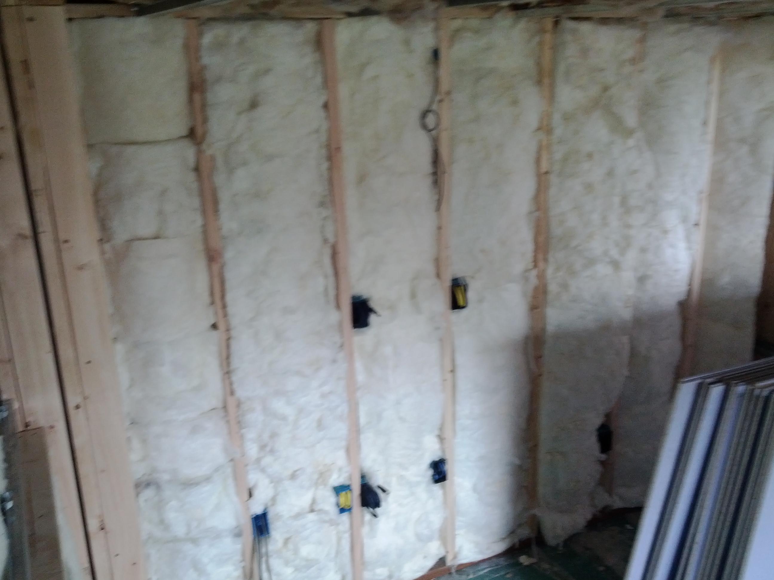

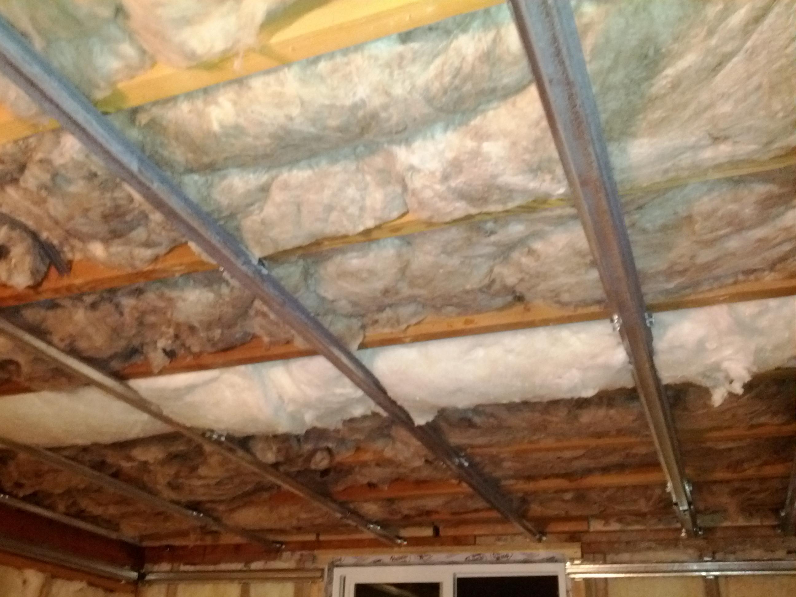

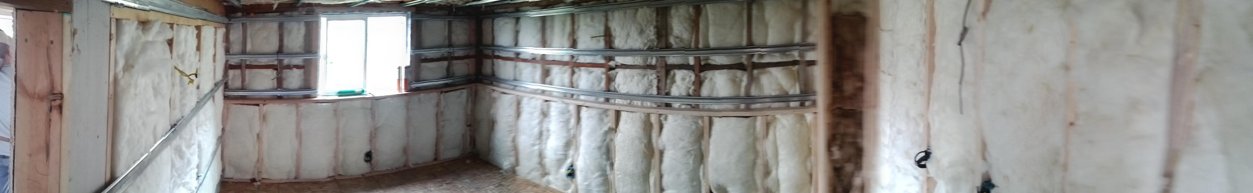

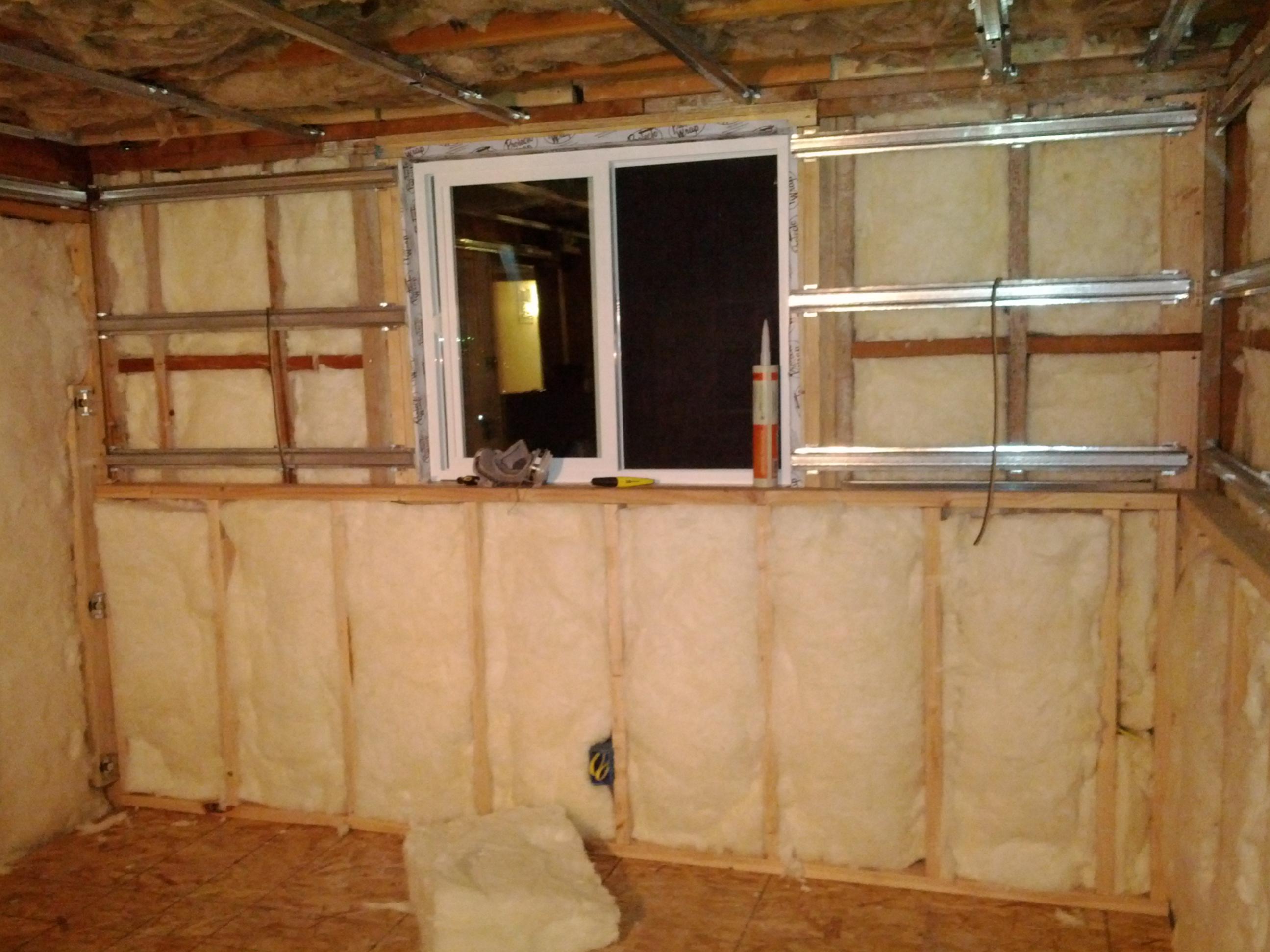

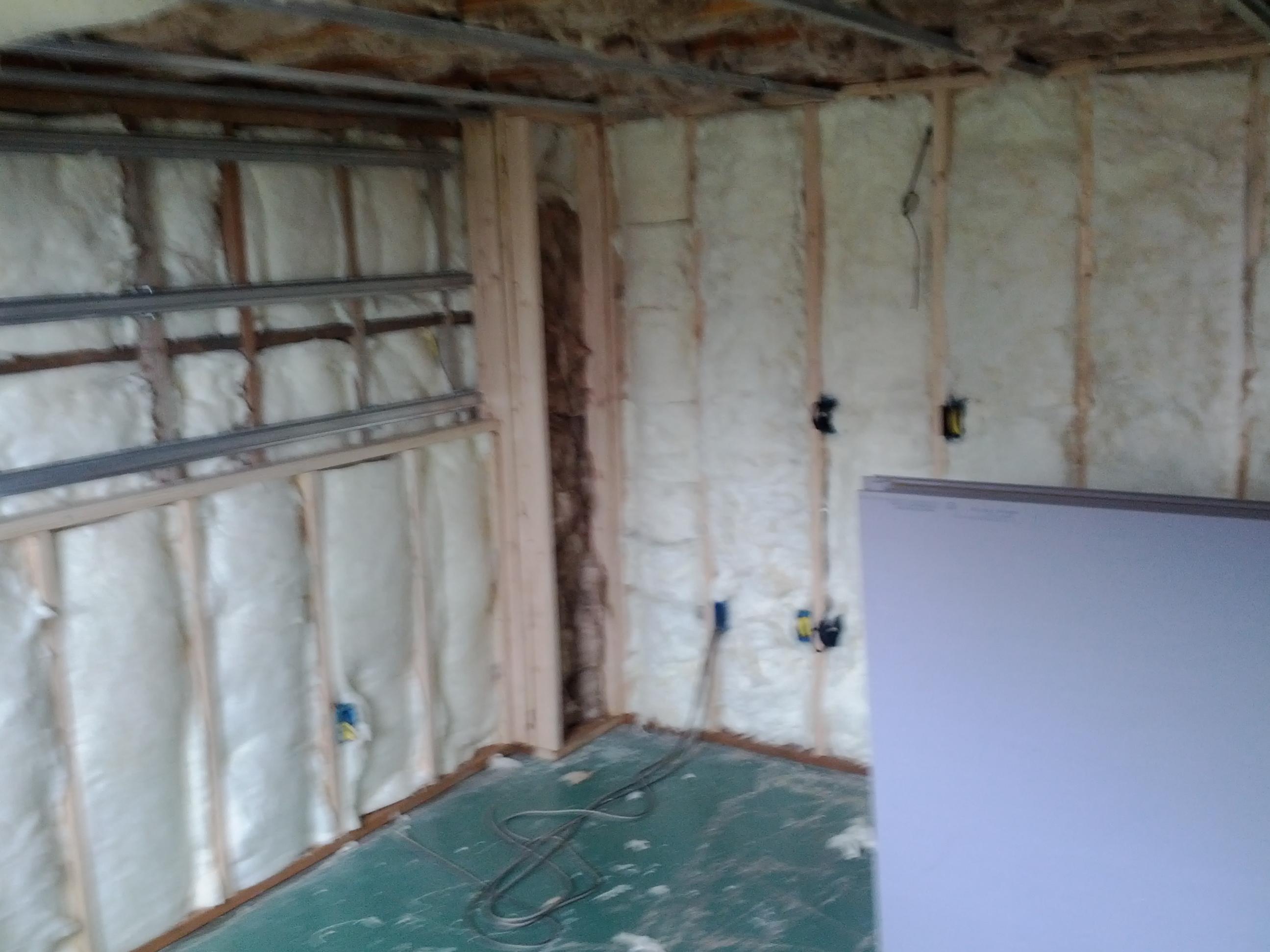

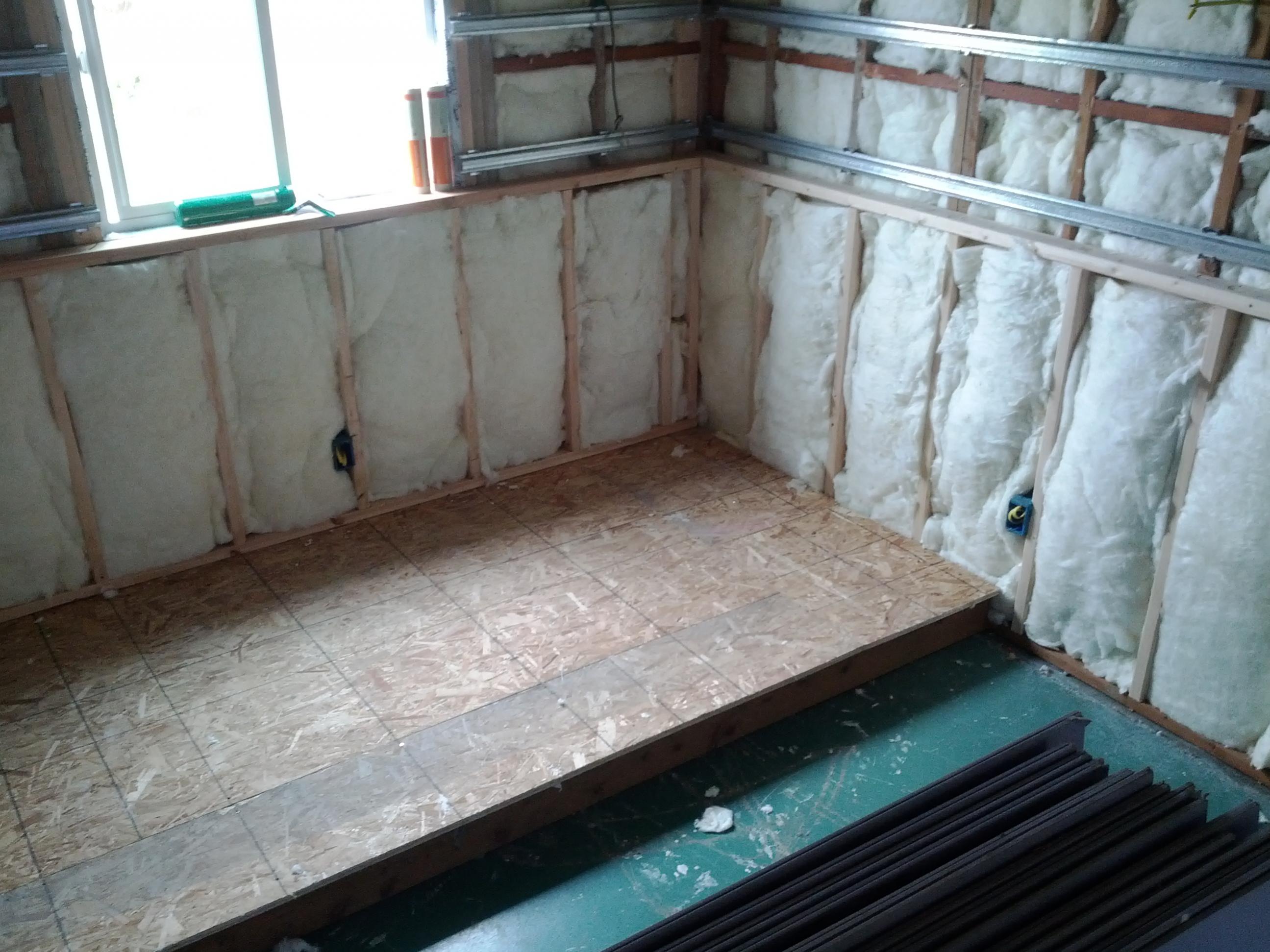

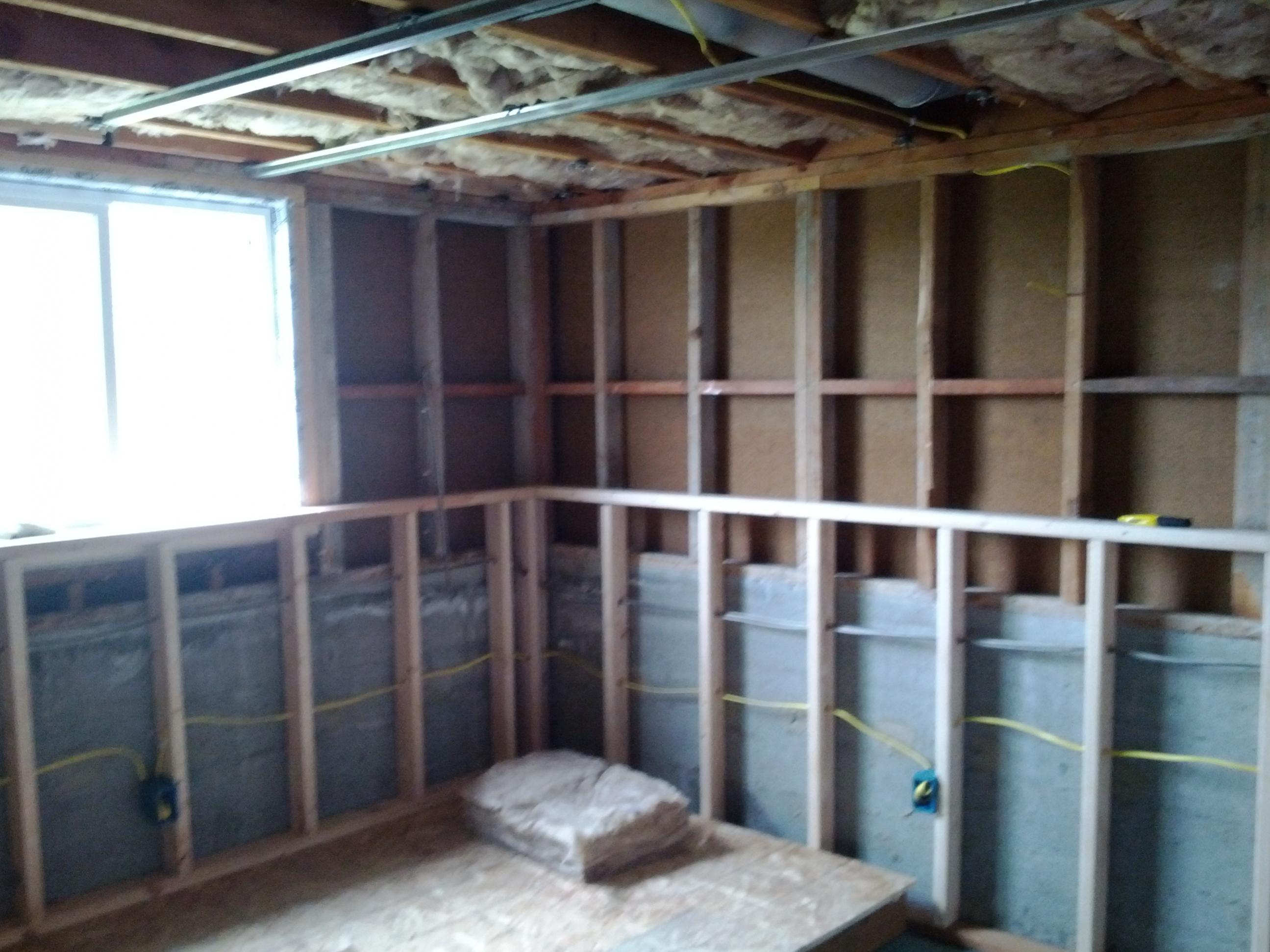

Demolition, framing, and wiring is complete. Currently decoupling the walls with RSC-1 clips and Hat Track, insulating, and then putting up the drywall, taping and floating.

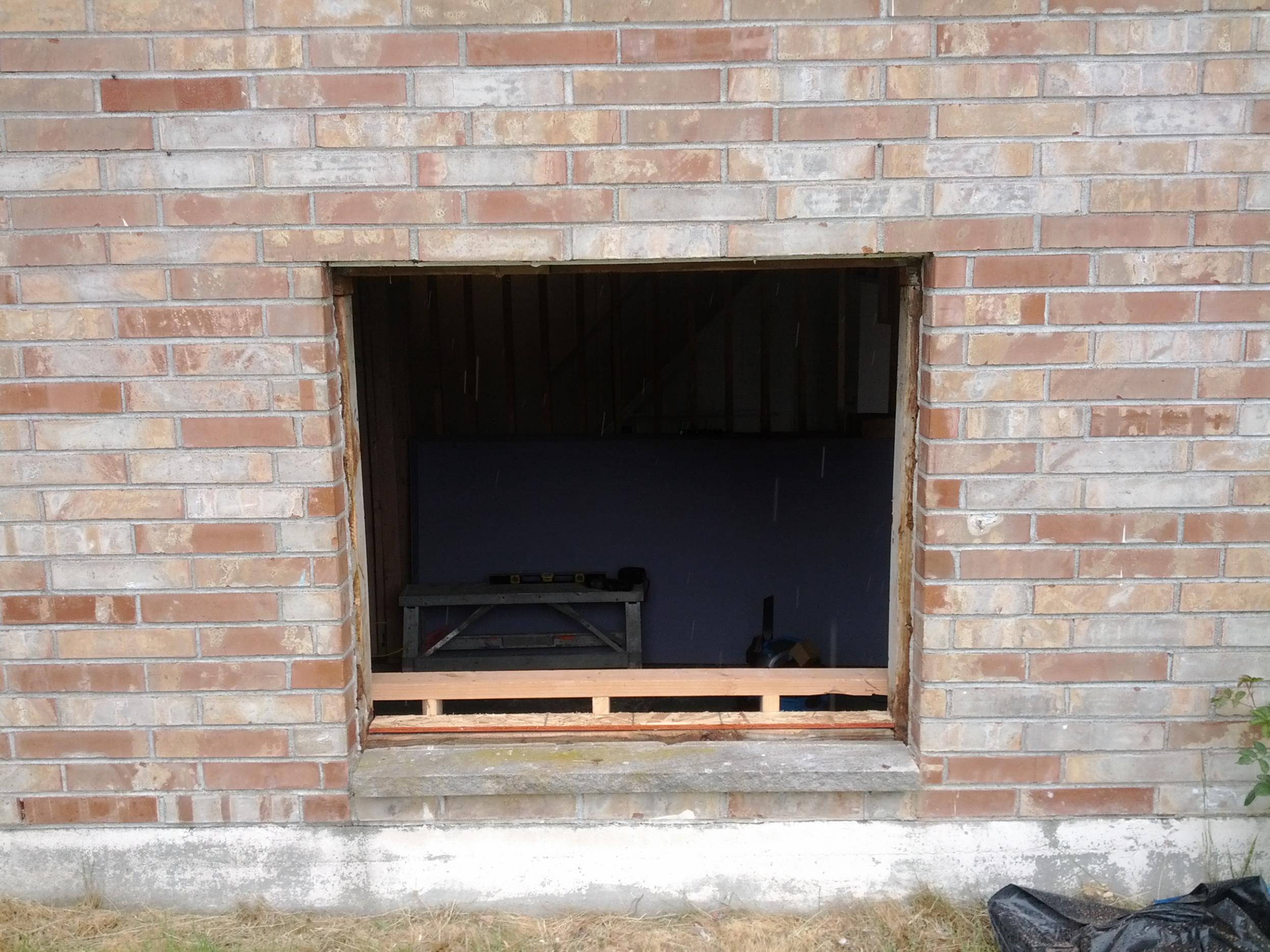

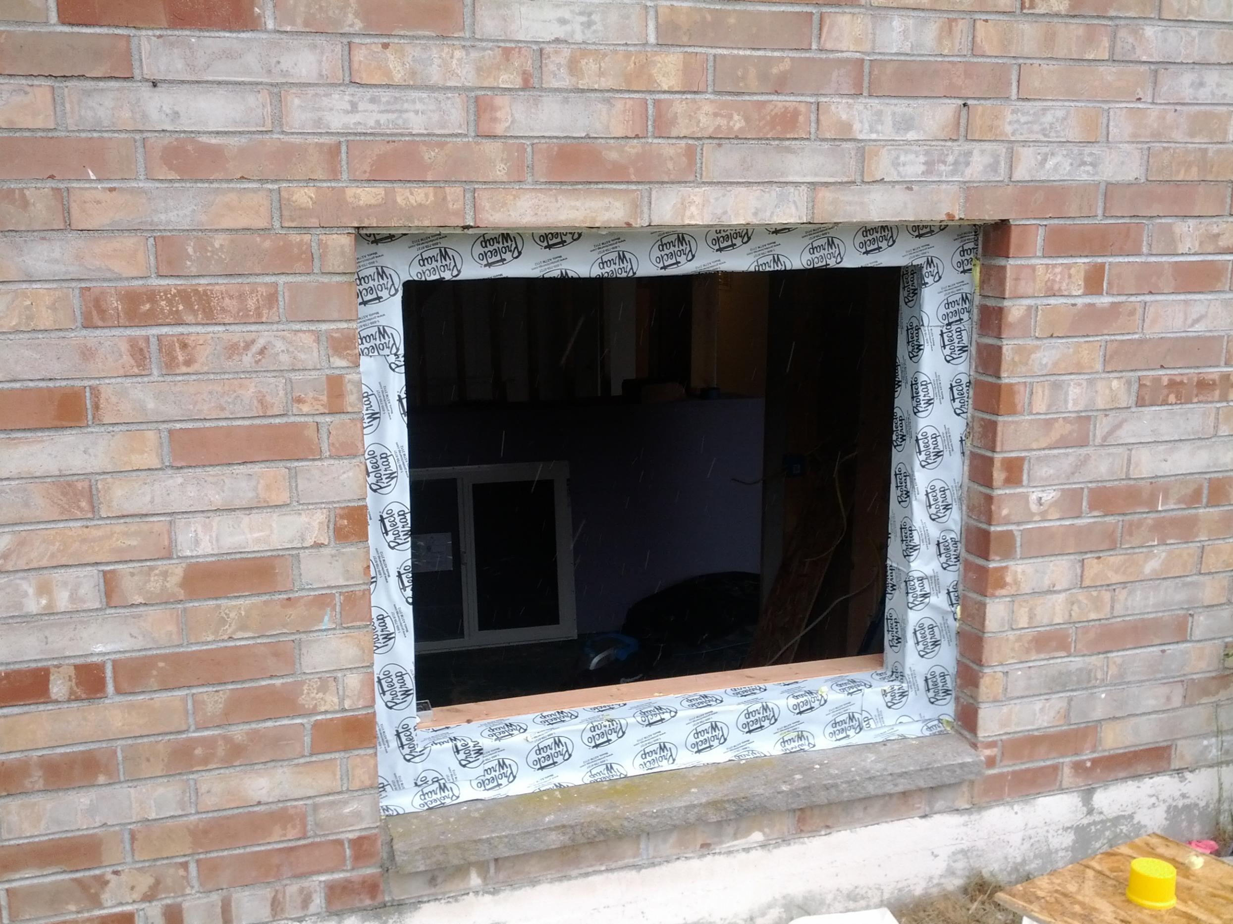

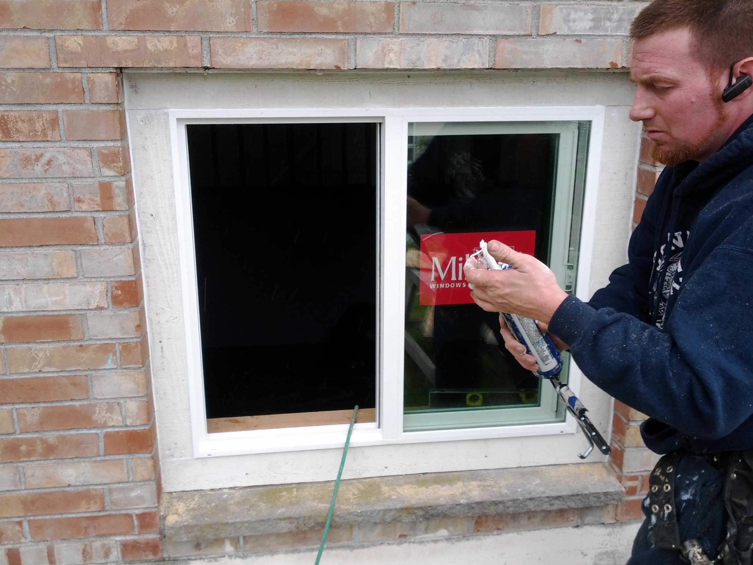

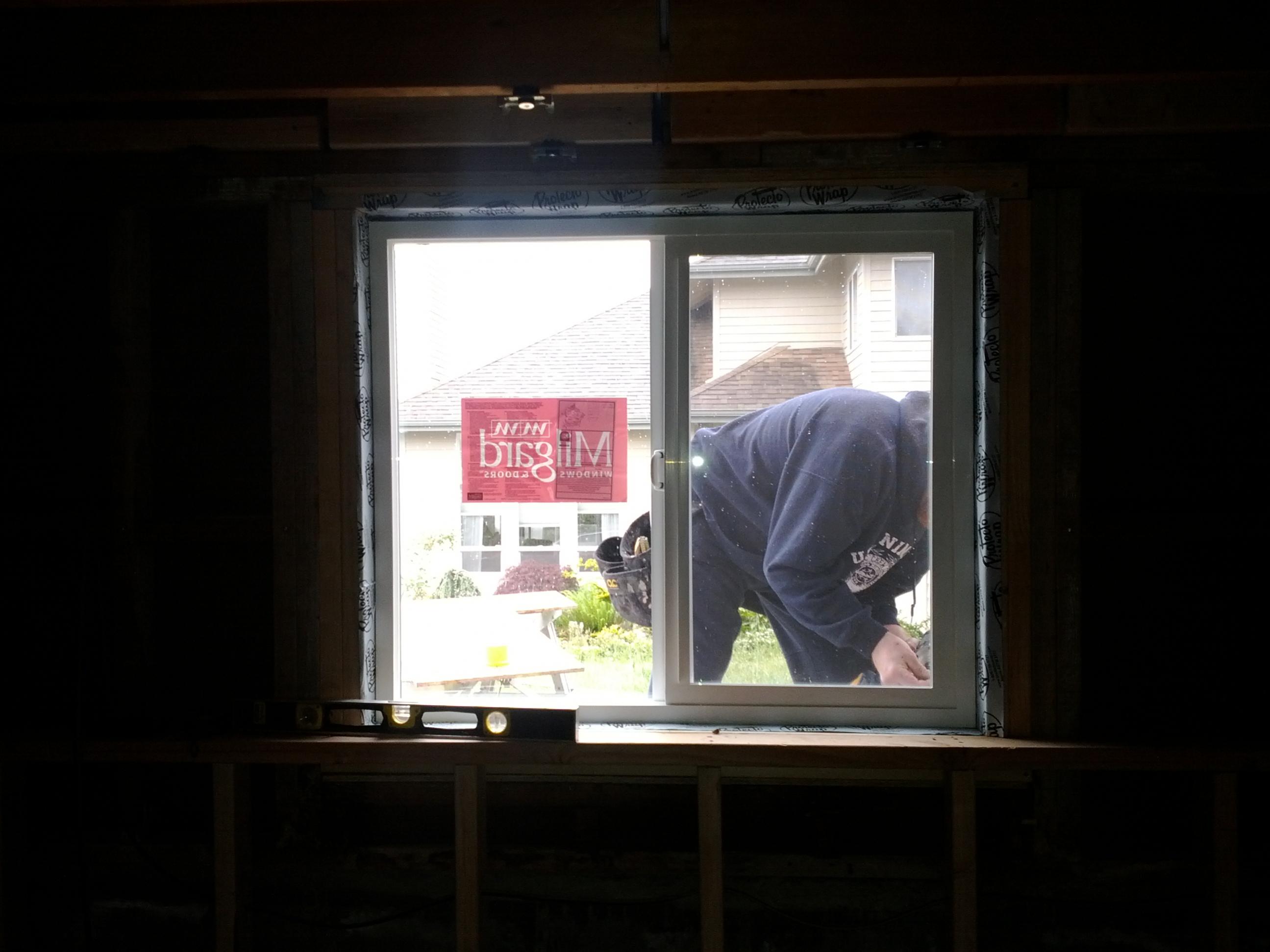

We have built a staggered stud wall to mount the plasma and center channel on. This will provide sound isolation and allow the wall to carry the load. The two perimeter facing walls have a half wall constructed that will provide a ledge for two of the walls. The original 1960 single pane window has been replaced with a dual pane (with different thickness glass) sliding window. The window will ultimately seat a window plug to prevent sound from bleeding out. I am decoupling all the other walls and ceiling with RSC-1 clips and Hat Track. This will hold Sound FX drywall which is essentially two high density gypsum boards with Green Glue sandwiched in between. The outlets have been a challenge. I have had to find boxes that travel out from the studs to allow for depth of the resilient channel. I am also using Quiet Putty to isolate these boxes.
Heres the fist wave of project photos... enjoy.

For thick walls you can use electrical box extenders. They make them for both plastic and metal boxes.Salk SoundScape 8's * Audio Research Reference 3 * Bottlehead Eros Phono * Park's Audio Budgie SUT * Krell KSA-250 * Harmonic Technology Pro 9+ * Signature Series Sonore Music Server w/Deux PS * Roon * Gustard R26 DAC / Singxer SU-6 DDC * Heavy Plinth Lenco L75 Idler Drive * AA MG-1 Linear Air Bearing Arm * AT33PTG/II & Denon 103R * Richard Gray 600S * NHT B-12d subs * GIK Acoustic Treatments * Sennheiser HD650 * -

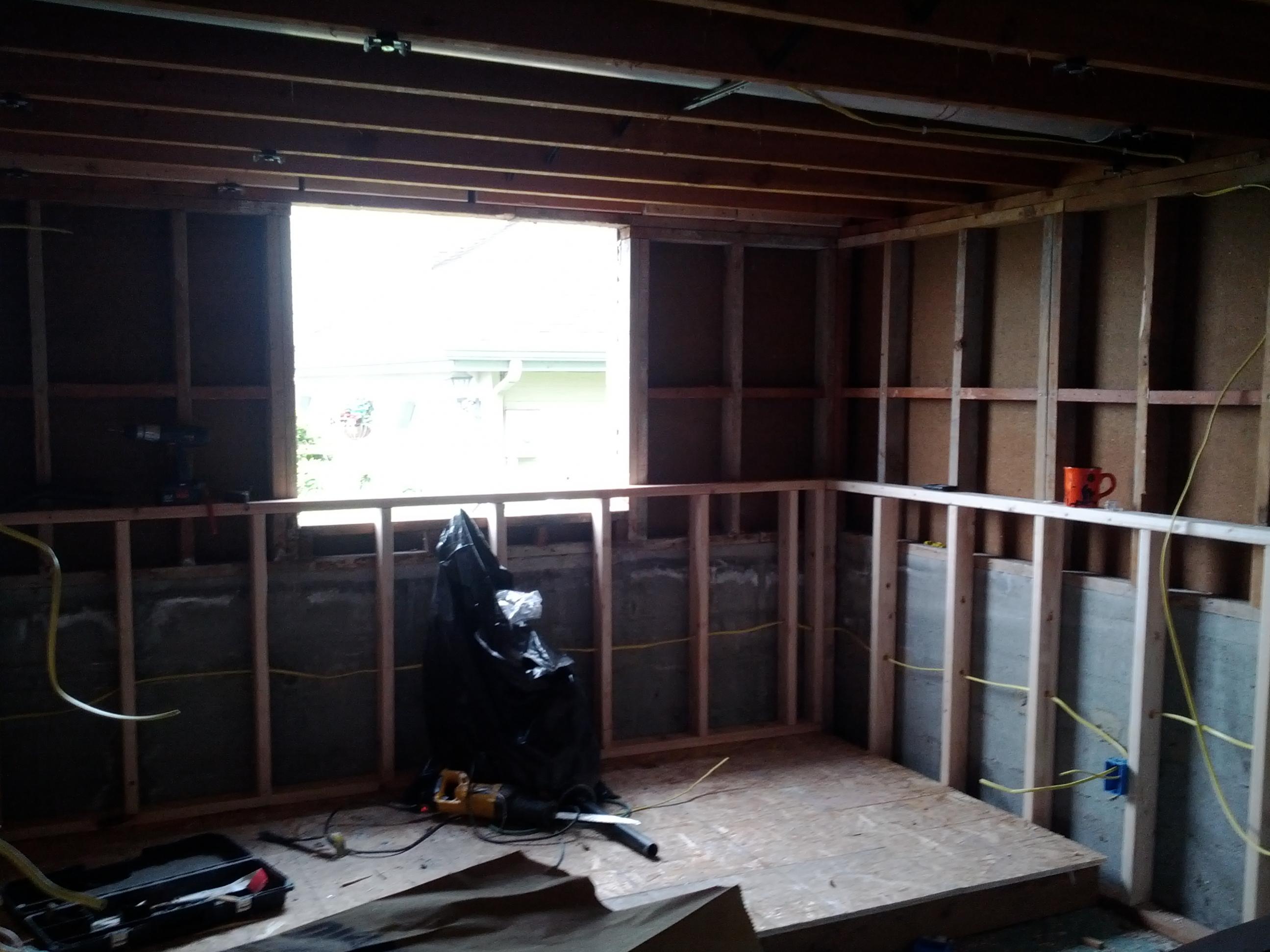

Here is the room before the demo. This photo is taken from a door that has been moved to the left wall. -

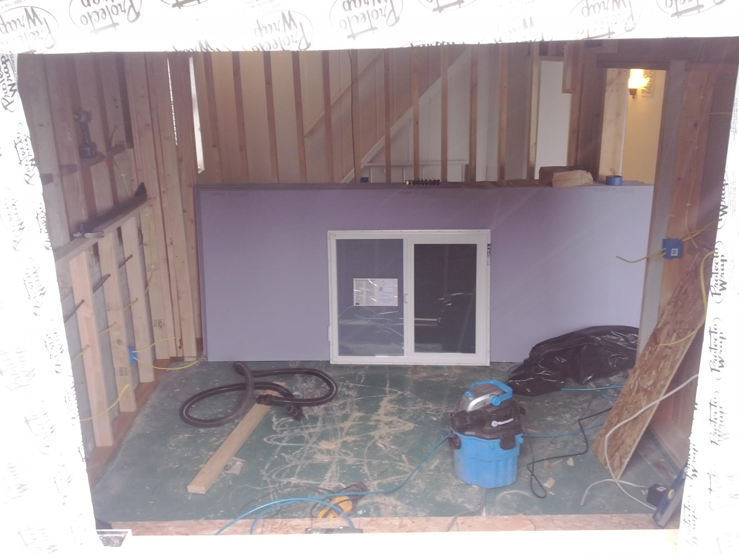

Today we begin encapsulating the room in Sound Fx Drywall today I will post more tomorrow.
