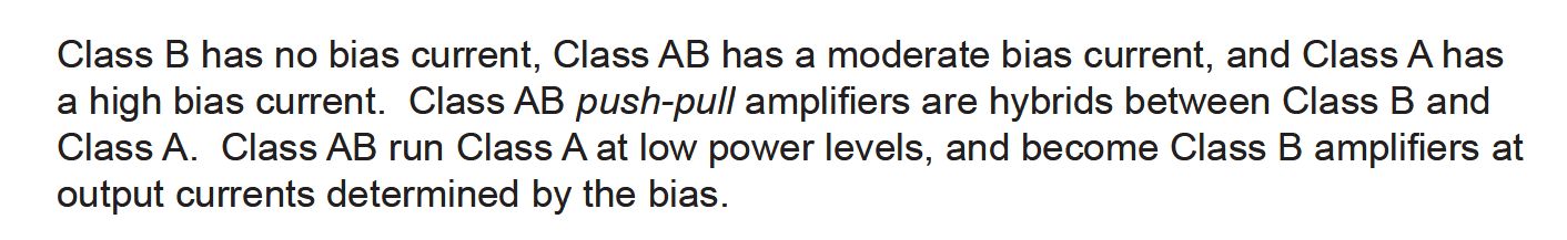

  • PreCd
    PreCd Posts: 786
    edited May 2012
    Read the link FGTV and it was informative. Thanks.
    I do understand the correlation between current and the operations of A, AB and B type amplification. There has to be a cutoff in current to have ideal linearity at some point. For instance we cannot keep adjusting the current upward and expect the circuit to perform better just because we are feeding it more. If that was the case the manual would not have a spec for bias voltage. I have spoken with Chris many times in the past and this is what he has said about setting bias current for the GFA-555. The procedures in the manuals are flawed! The procedure he outlined for me a few months ago took more than an hour to complete and even that did not net me the results that listening and adjusting has. It got me close though.
    Again I would like to state that with age components degrade over time and the bias current spec also changes. Tube guys can attest to this fact for sure, more so that transistor users.
    My two cents worth.

    heiney9 Posts: 25,492
    edited May 2012
    This is the first time I have heard anyone recommend lowering bias in a push/pull circuit. If it's because of worn components, replace the worn components. If after reading the article by Nelson Pass you still don't think it's a poor idea then I don't know what to say, except if you like it that way, great.
    But, I wouldn't go around telling people to "check their bias" and recommend lowering it unless it's way too high out of spec or too low out of spec.
    edited May 2012
    PreCd wrote: »
    Read post #6 where I stated that I am not recommending anyone lower their bias. However I am recommending that for anyone that has not checked the bias of their amp needs to do so. In agreement there?
    Do I trust Nelson Pass more than I do my knowledge......you betcha. But when is the bias current too much? You must agree that there is a limit no? I am sure he would too. Being a tube guy surely you adjust the bias on your amps when the tubes get some age on them don't you?
    Too much is usually when you don't have the hardware to dissipate the heat and/or the output devices can't take the heat, again speaking in very general terms as the complexity of the design has something to do with it as well.
    I have one tube amp that has manual bias, in two years of using used power tubes in it, I haven't had to adjust it. To be fair I don't play it everyday. Many amps have bias compensation up to a point, but the more complex and the more gain stages utilized it becomes complicated and yes, bias should be checked on an older, well used amp. But I DON'T agree with adjusting the bias to compensate for worn components, if they are worn replace them.
    Have fun, tweaking and messing around can be fun. I just don't recommend someone who has little knowledge going in and twisting dials/pots, etc. And it is rare that reducing bias improves the sound, both objectively and subjectively. In fact, IMO, I'd go as far as saying it shouldn't be done. But in the end they are your ears, in your rig so turn away.
    edited May 2012
    I don't agree with the John Broskie quote. It's worded very vague and general vs. the specifics of the NP article where he explains what's going on both graphically and verbally.
    Have fun, that's all that matters, we can agree to disagree about the fundamentals of what's going on.
    It's your rig, do what you want to make it sound good to you.
    I was simply reiterating that people who don't know their way around the inside of an amp shouldn't try this--we agree on that :biggrin:

  • FTGV
    FTGV Posts: 3,650
    edited May 2012
    PreCd wrote: »
    Your welcome it is a good tutorial on the subject.Also I'm for the most part in agreement with the Broskie quote having essentially covered the same points in earlier posts.The main take away is that there is an optimum bias level for each amplifier.
