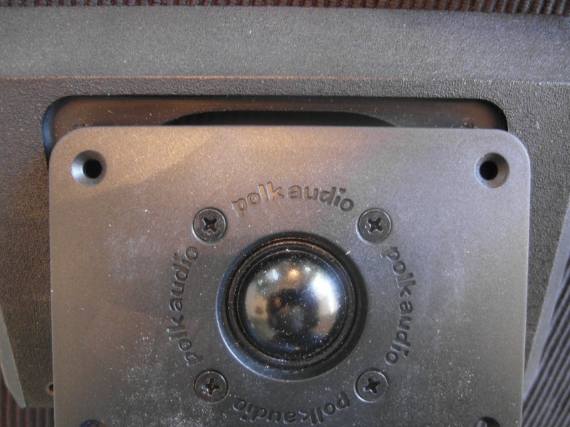

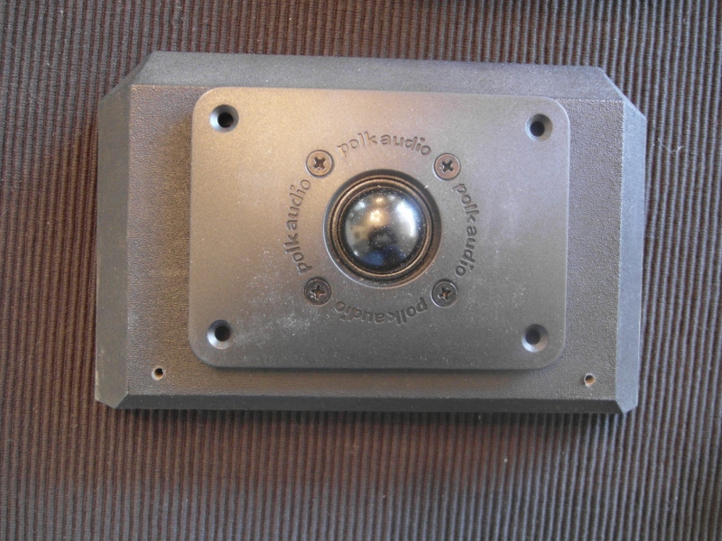

  • techlectic
    techlectic Posts: 19
    edited April 2012
    I see now from the RTA12C upgrade thread that geoff727 didn't bother with the fit of the tweeter into the routed-out part of the tweeter bracket. When I read it before, I thought the "snapping into place" was referring to the tweeter going into the recessed area, but now I think it's just referring to the magnet going into the hole that goes all the way through the bracket. As I mentioned, the magnet of the RDO194 is wider than that of either the SL1000 or SL2000.
    Attaching some pics of the Monitor 12b tweeter situation.

  • geoff727
    geoff727 Posts: 546
    edited April 2012
    techlectic wrote: »
    Now, what you just showed in picture 1 doesn't look anything like what was on those 12's I did. If your 194's really fit like that, then ya it's time for some handy work. And, the magnets fit just fine for me, with room to spare. It was the faceplate back lip that had to snap into place.

  • geppy1
    geppy1 Posts: 3,076
    edited April 2012
    They set up like this
    Late RTA 12B late 1983- early 1984 use 6600X drivers and SL1000 tweeters
    Look like a Peerless and are the same size. RD0194s will not just drop in the plate and it needs to be modified
    Early RTA 12Cs Same as above
    Late RTA 12Cs Late 1985 to 1987
    Uses 6501 drivers and SL2000s . The late 12Cs use a different and larger tweeter mounting plate then the RTA 12Bs and the RD0194 drops pretty much right in in place of the SL2000
    As for the sound difference betweeen the 194 and the 2000. The 194 is a more mellow tweeter.. You have to decide if you like that or the 2000. I would give it some time.
