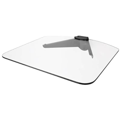

Hey everyone, i just recently purchased Monitor 40 Series II Bookshelf Speakers as my surrounds and i need a place to put them! I heard you dont want your surrounds at ear level...this true? if so i want to put the speakers high on the wall. the problem is that the speakers are pretty heavy and i cant seem to come up with some sort of solution for this problem! any advice will help! thanks

They should be above ear level, yes. Rule of thumb I think is 3 feet above the listening position. Just helped a friend install the very same speakers as surrounds, and we simply used a pair of glass shelves. IMO they look better than they would have using some utilitarian-esque mount. Here's the shelf we used:
http://www.amazon.com/Vantage-Point-AXWG-01B-Glass-Component/dp/B00022OB38
