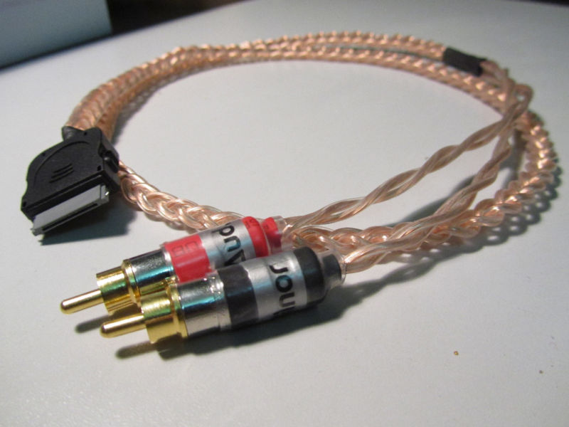

Anyone build a LOD cable?
I may be building one soon.
My sister wanted a cable like the purple one in the pic for her car.
She has a VERY nice game room in her house, with a decent stereo (All Paradigm, powered sub 10", speakers hanging on the walls, 4-Micros), Onkyo AVR, it sounds good (I built it:cheesygrin:).
I started thinking, if she kept the female 3.5mm part (with dual rca's) connected to her audio system in the game room, she could just grab the IPOD and the purple cable, take it in the house, and plug it directly into the female plug and jam in her game room if she wants.
I know these are widely available, but I doubt many are made with 26 ga. 6N OCC single crystal solid core copper wire, Furutech rca plugs, Cardas Quad solder.:smile:
Although it can be made with better plugs/components I am sure.
Not sure about a LOD cable.
Anyone ever make the IPOD plug directly to RCA plugs?
I have never seen one.
I have seen the IPOD plug to 3.5mm, but never to dual rca's.
I haven't really searched it, but if it is possible, I may go that route.
I understand it bypasses the internal DACS, and allows something like the ONKYO AVR to do the conversion instead.
Anyone?
After listening on My Atoll pre amp, I don't think I am loosing alot as far as a second connection goes.
Its pretty damn sweet!:cheesygrin:
Naturally I am going to finish it exactly like the purple cable in the pic.

    Like this but to dual rca plugs, anyone ever see one? Built one?:

    pepster wrote: »
    I've never made one, but here is a picture of one from eBay...
    pepster wrote: »
    Anyone?[/B]
    It doesn't bypass the internal DAC. It is just an analog line out, but the internal DAC is still in the chain. You need something like a Wadia dock or modified iPod/cable combination to bypass the internal DAC.

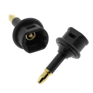

    I just use this little guy and a toslink cable, interested in other options though. Keep us posted!
    How do you connect that to an iPod? I've never seen one with any type of optical connection.

    I use it from either my Macbook or my Apple Airport, you just plug it right in to the headphone jack and it bypasses the internal DACs. I honestly haven't tried it with my iPhone I just figured it was the same?
    The iPhone headphone jack isn't a combined Toslink/analog jack, like the jacks on the Airport Express & Macbooks, so it won't work that way.
    Not to derail, but are you plugging the toslink into your AVR, or do you have an external DAC in an office system? I'm asking because I'm thinking about picking up a DAC for my Macbook, and am wondering what others are having success with.

    Oh it's nothing fancy, I literally set my laptop next to my receiver in my HT and plug in a toslink cable, or i'll just play it wirelessly and use a toslink from my airport to receiver. I'm not a big 2channel person I just enjoy hearing some tunes in my HT, it definitely could sound better.

    To add to the confusion, I thought B Run was talking about a mini Toslink adaptor.
    I know my B&K Ref pre-amps take this type of plug.
    Same size as a 3.5mm I believe, but digital (Optical).

    Hey Pep- Did you ever make one of these lod to rca cables for your sister?
    I'm asking because I still need a cable to play my iphone in my car. I originally wanted a cable with rca to mini plug ends, but then I realized that it sounds better coming out of the lod vs the headphone out.
    I'm checking around for prices right now and just sent an email to Blue Jean to see what they would charge to build one.
    Let me know if you can build one.

    Just found this thread on HeadFi on tips on making an ipod to rca cable :)Here.
