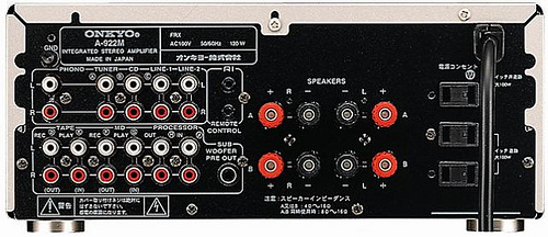

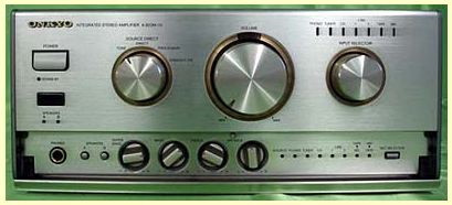

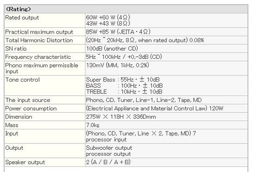

    my HT is an onkyo htib which is hts5300. the rti and dsw are hook in integrated stereo amp(onkyo a-922m)
    here are some pics i barrowed from the net.
    hope to hear you again guys.
