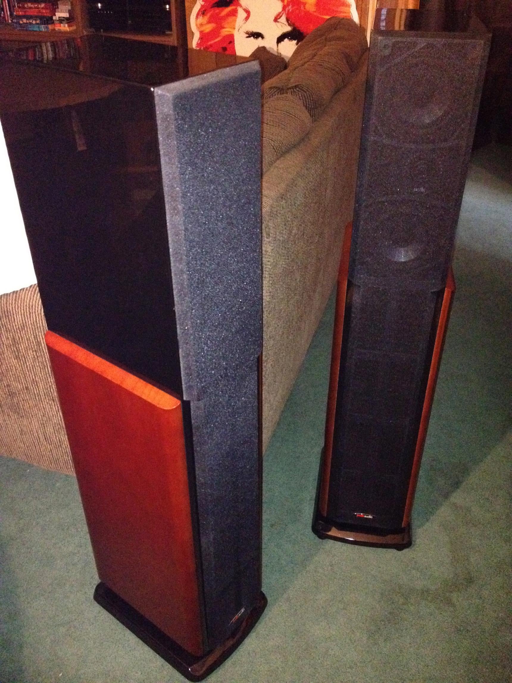

    Just got the Lsi15's! Look great! Have some minor light scratches on the top, but other than that they look great!

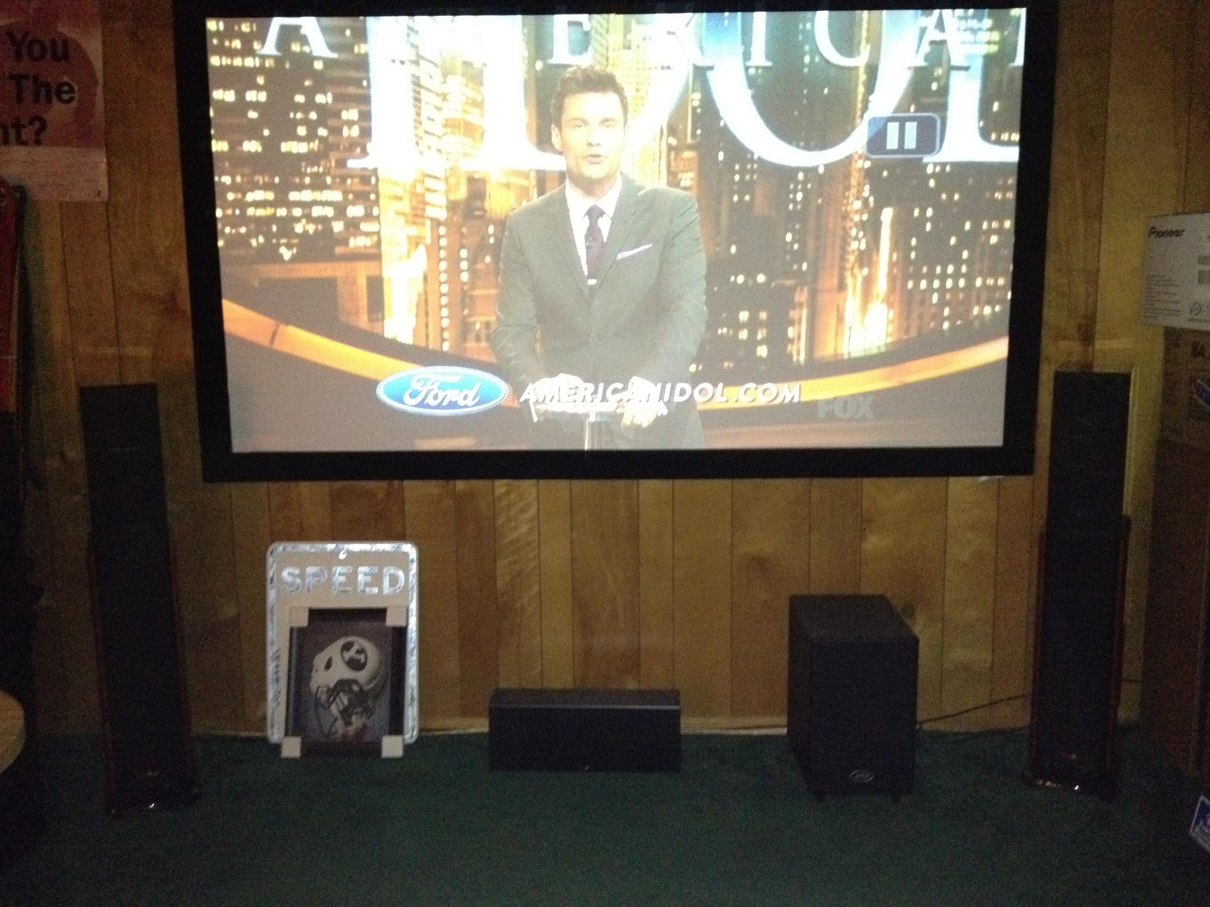

    My new speakers and amp hooked up. Love them so far!
    edited April 2012
    Looks nice, gonna throw out a suggestion on that center. Maybe get it on a stand or at least put something under the front to point it towards your head in the listening position. Also play around with the toe in on those LSI's, seems a tad extreme to me but it's hard to figure where your sitting by the pics.

    I actually did get a stand for the CS2...just waiting on it now.
    What do you mean by "play around with the toe" on the LSI's? I'm about 7-8ft away from the LSI's on LP, but in the picture it was only about 3ft or so.
    edited April 2012
    Good man on the stand for the center. By toe in, I mean the angle at which the speakers are facing. Seems like alot to me just off the cuff given the pic. The front speakers angle, if you drew a line, should intersect at your listening position. This of coarse is not written in stone as each room varys along with taste but it's a good placement to start with.

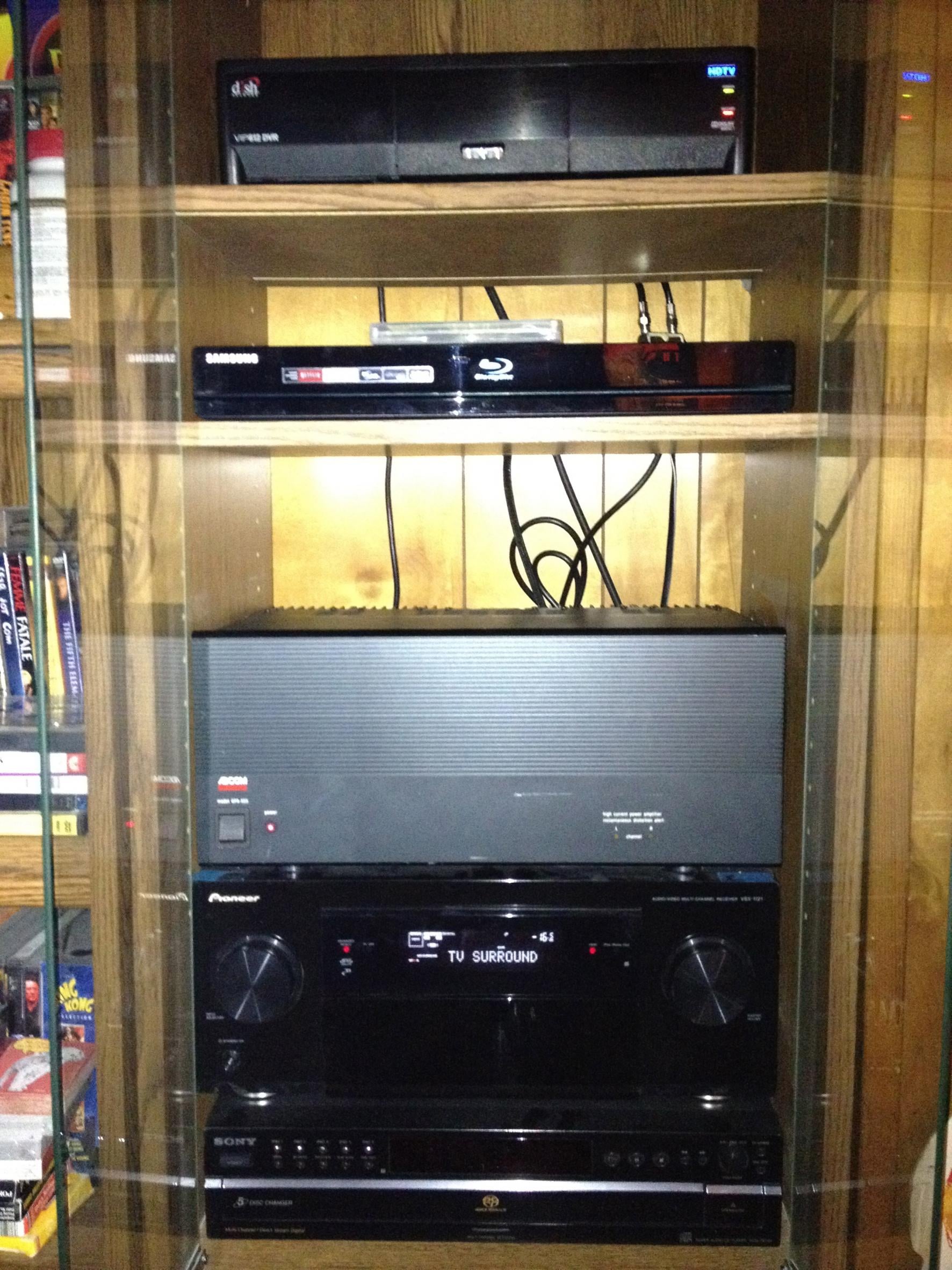

    my 555 also cost $300 w/ shipping thrown in from Audio Classics.It's a quiet amp w/ no thumps when turned on or off. One thing I did notice about your stack I think I would reverse the set up.My amp doesn't get even warm and is heavier than my Yamaha RX-V665 which needs some room to breathe.You did very well w/ that set you got,good luck.
