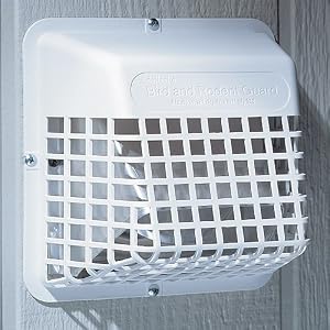

    Maybe consider a critter guard over the exterior vent. Like this.
    Shortly after we moved in our house, we had a Grackle that hung off the siding and opened the flap door and crawled in the vent pipe looking for a new home. After evicting it I installed a guard.
  • Joe08867
    Joe08867 Posts: 3,919
    edited March 2012
    critter guards are a real good idea.
