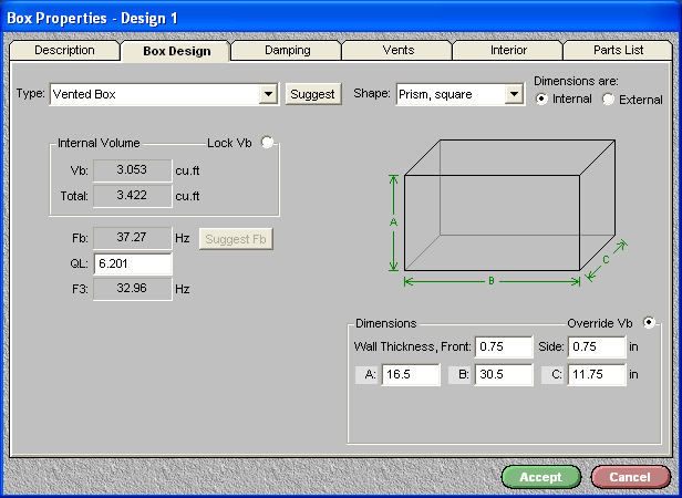

    i modelled it on bass box 6 and changed the shape slightly and tuned it lower to my liking. heres the box they sent me

    i'm surprised that they told you ported. However those specs are specific for the mm subs. Double check if everything will be ok for the Type R subs. The volume of the box might be different for the type R.
    Sealed almost always sounds better. Its easier to integrate with the mids upfront and has a more even frequency response. However as you lower the tuning frequency the ported box approaches the SQ of a sealed box.

    yep the type r's show almost an almost identical curve just slightly louder due to the higher power, they also play slightly lower too. this box is within spec for most 12" woofers. i think ill go with the r's for peace of mind. after a second listen of both subs the sq isnt far off the polks imo so ill get the type r's. thanks for your advice

    i just found polk db 1240's for sale in australia so i modelled them in my enclosure. interestingly they showed a nicer response curve.
    should i trust the software and get db's or follow my ears and get mm's.
    keeping in mind that on the sound board theyre both sealed and im using ported

    The db subs are designed for ported, sealed, and bandpass boxes. The MM and SR both do better in sealed boxes. So I'm not surprised that the db looked better in a ported box. All in all I would go sealed with the MM, they are significantly better.
