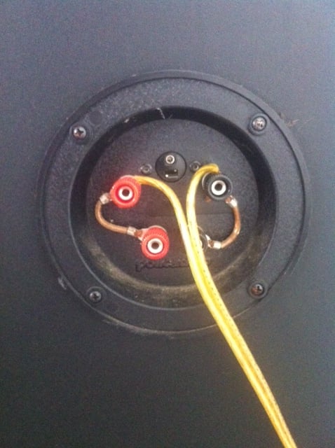

Hi,
I am going to be looking at a pair of what I think are SDA-SRS 2.3, and would like some advice on hooking them up. These have two sets of terminals on each speaker in addition to the pin-blade interconnect cable. The current owner has the two sets of terminals jumpered, which I assume needs to be disconnected when the interconnect cable is attached. Can anyone suggest which pair of terminals should be attached to the amplifier?
Also, is there a manual for this model anywhere to be found? I downloaded the SDA manuals from Polk, and none depict a model with two sets of terminals.
Thanks!
Post edited by Crashdot on

    The jumpers stay no matter if using the cable or not, unless you are bi-amping/bi-wiring them.

    You onlu disconnect the jumpers if you plan on BiAmping them. It is needed even with the interconnect. So don't remove the jumpers. Connect them like you see in the pic and add the interconnect.
