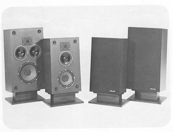

thank you for posting these very much I do have a question. am I misreading your dimensions for the pedestal as 5 inches square? I have this photo that seems to be a factory brochure which appear to be m10's and 7's on stands . the pedestal part appears to be rectangular not square in dementions. I am goind to build a pair of stands and was just trying to match the originals. Thanks

As far as I know Polk made three different variations of stands. The ones you have pictured I did not know about, seem to be a very early variety. The ones I have are the, now, second generation maybe. The third that I know of, and owned at one time, were taller according to the speaker used. I.E. - If you had smaller monitors they were taller, bigger monitors shorter. This third style didn't have one big pedestal in the middle. There were two or three thin ones depending on which model monitor it was. It would be interesting if someone actually had all three variations of the stands though.
Yes, each side of the pedestal is 5 inches, for a total of 4 sides/5 inches each. Sorry about that, I should have specified it more clearly.Remember, when you're running from something, you're running to something...-me -
U were quiye clear these picts confused me. Didnt know they were diff. Models. Knowing polk i should have expected the variences. Lol.Main Rig:
