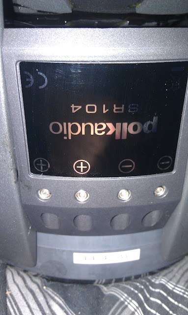

Ok so my sub came in today. I ordered the regular SR104, single voice coil, but it has two sets of terminals. It didn't come with any kind of manual or literature, and the info on the box doesn't touch on the subject. Did I get a DVC by mistake? And if it is the right sub, what's the proper way to hook it up? Two outside? Two inside?
Thanks guys
Post edited by ocharlas on
  • ipartywhenuhurt
    ipartywhenuhurt Posts: 130
    edited February 2012
    Its right they put the extra speaker terminals so u can daisy chain the sub, as long as where u look into the back part of it and you only see two wires going too it then its a single coil if u see 4 wires then a dvc
    If u hook it up that way ull fry the amp i did on when i got my sr124
    Just place one positve speaker wire on one positive and one negative on one negative u choose which ones i belive , since both + go to one wire and same for the -
  • ipartywhenuhurt
    Beautiful sub by the way :)
  • ocharlas
    ocharlas Posts: 61
    sweet, thanks a bunch...I checked the wires I thought it was a single, I just wanted to make sure so I didn't wind up with a fried amp.
    And yes, she is certainly a thing of Buty(L). Going over to my buddy's house right now to grab my old box and pop her in. Pretty sure it'll be too small (I think it's a .8 or so) but I ain't waiting! I'll grab one at best buy or something tomorrow.
