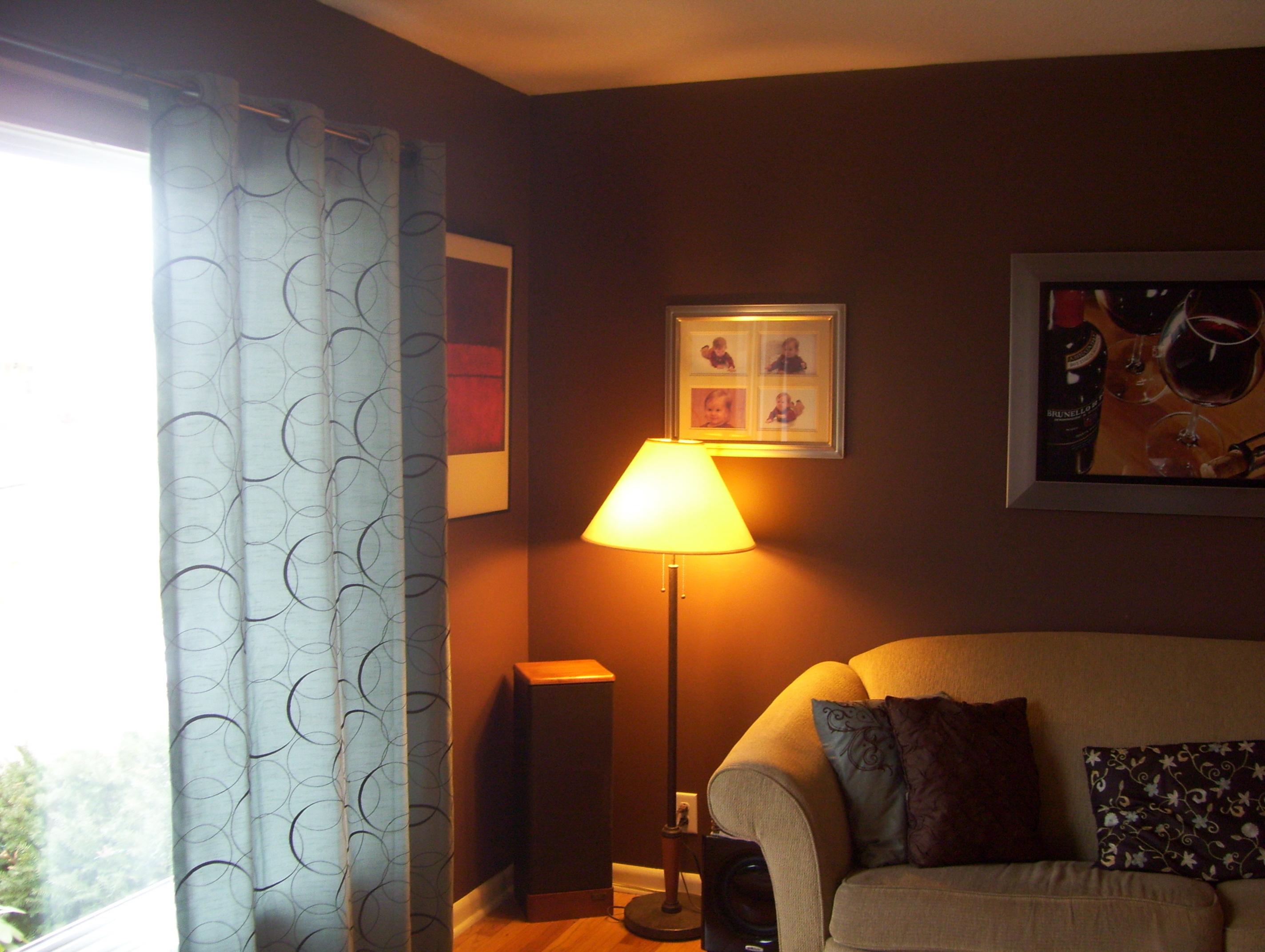

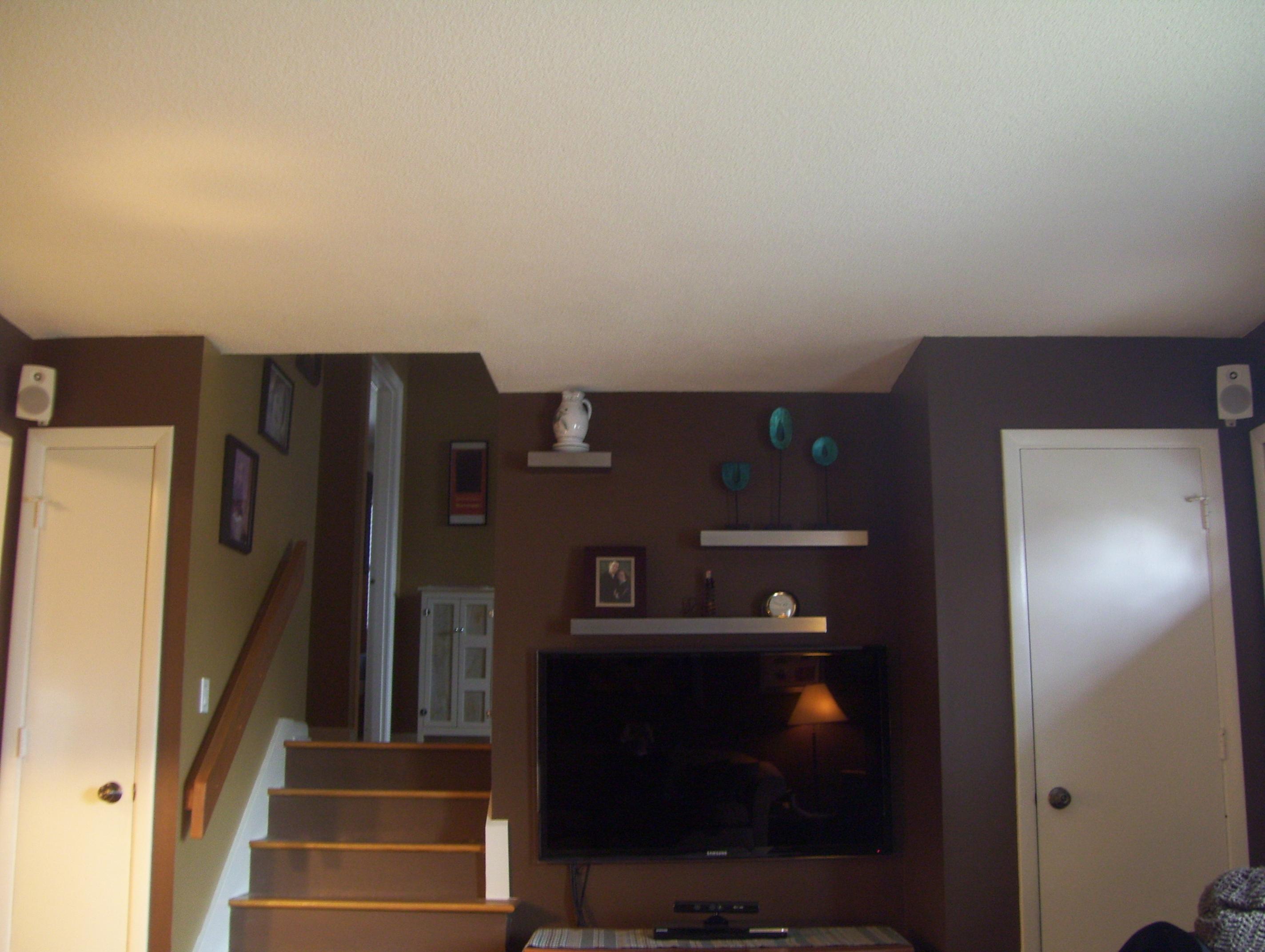

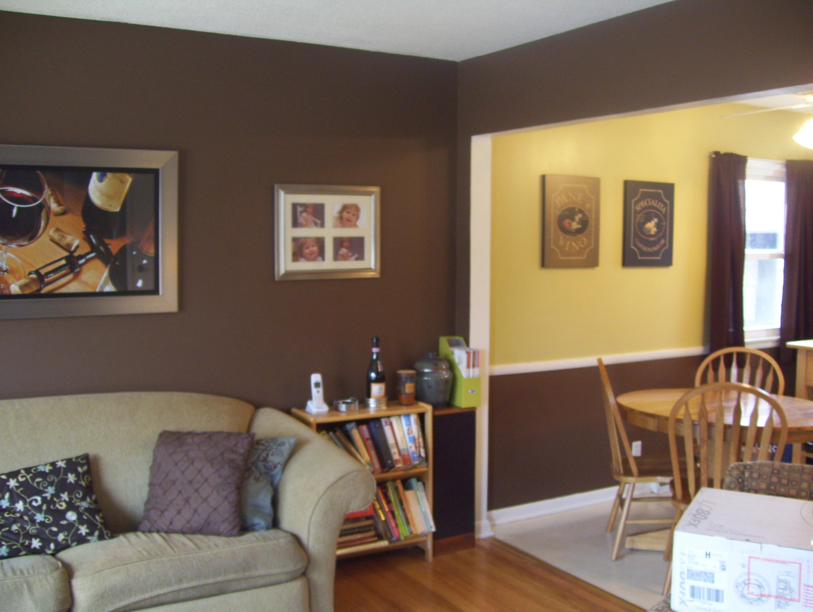

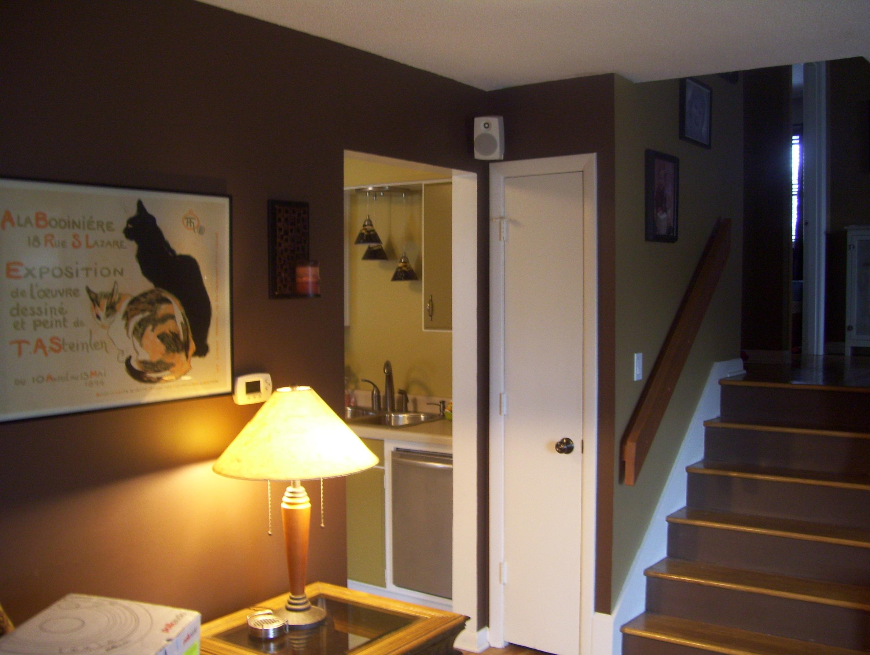

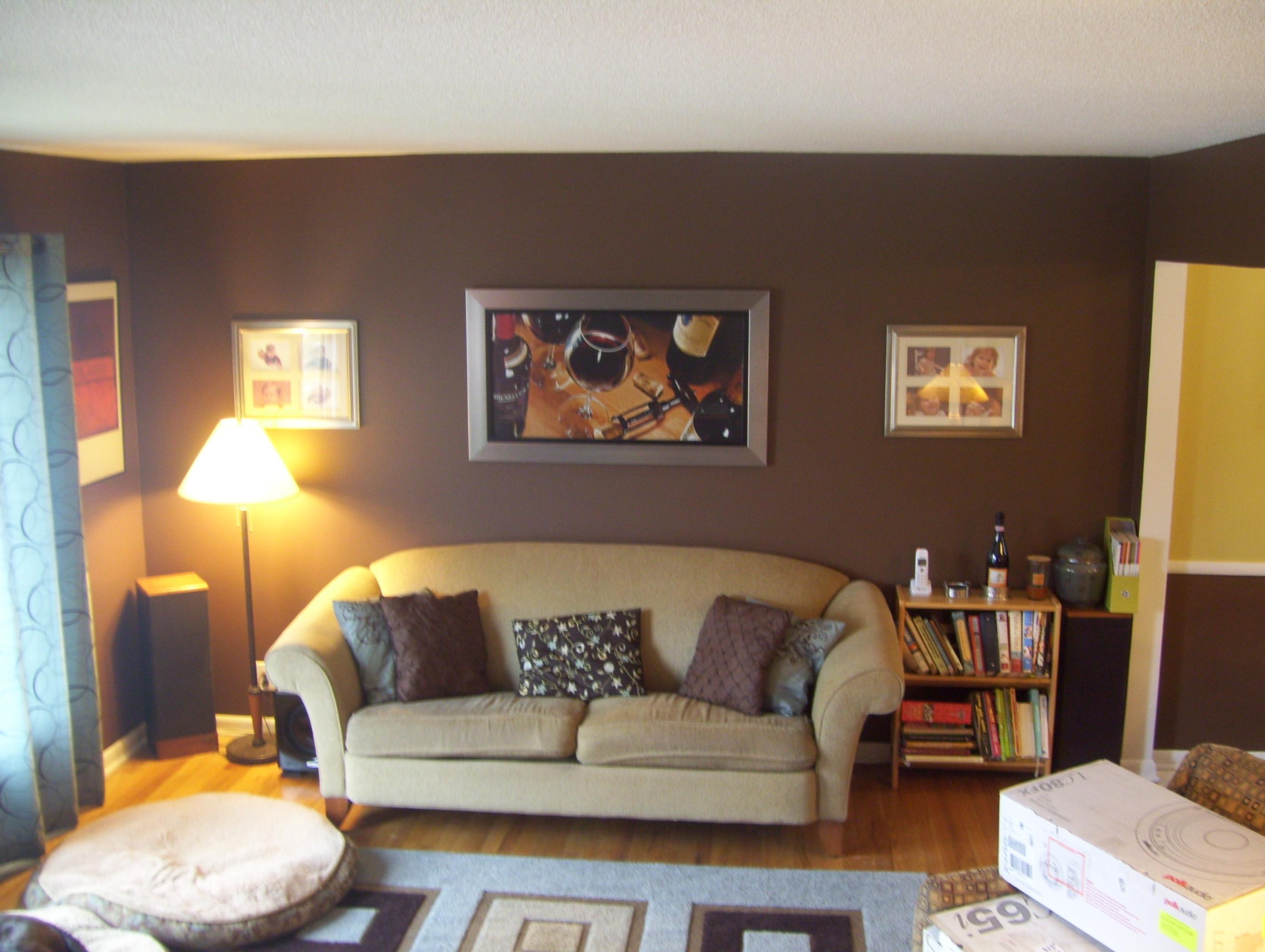

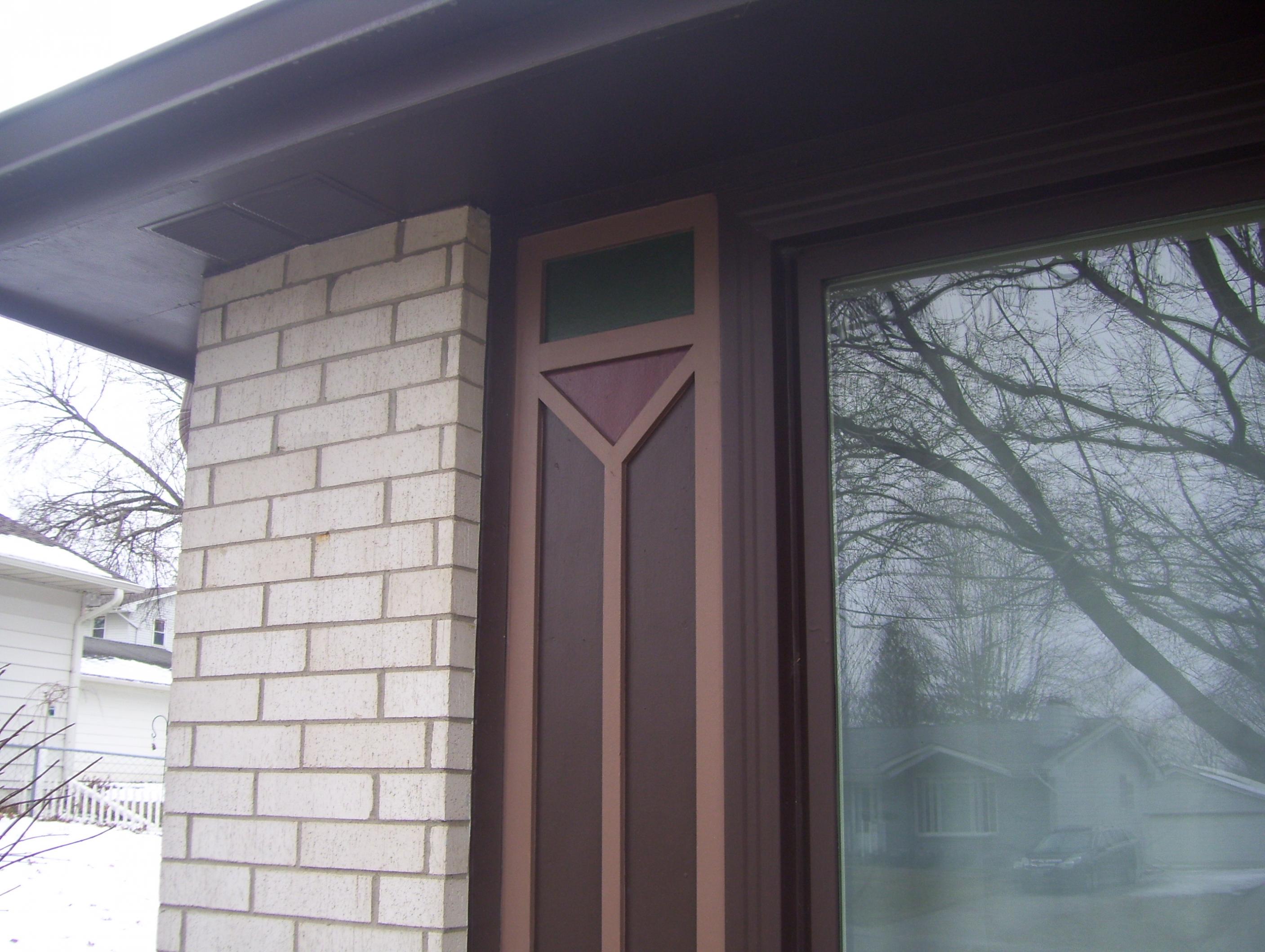

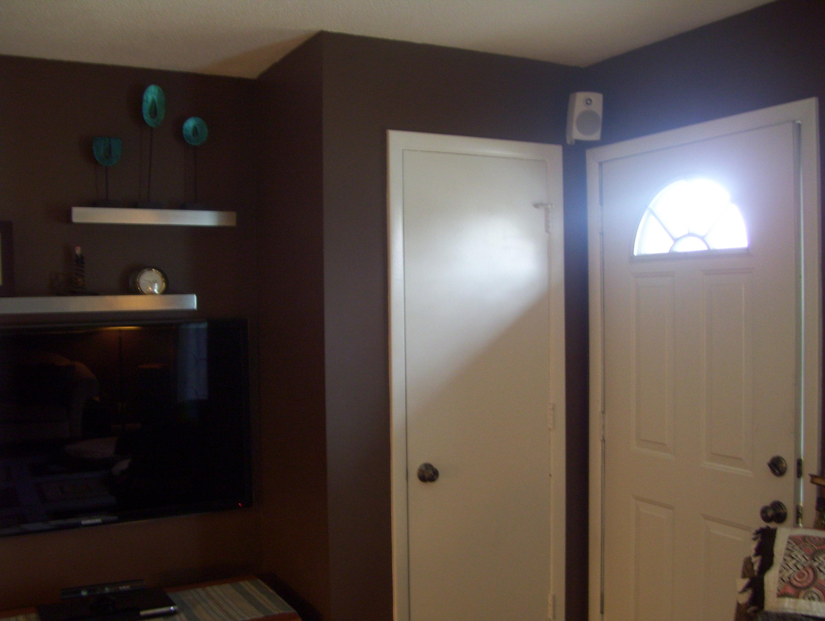

    So this is the layout of the livingroom. I am putting LC265i's over closet doors in front of the room. A LCic center below the TV and then trying to decide what to do in the rear of the room. I also took a pic from outside the house, where the speaker would be mounted (mounted in that wall inside of course...) if I were to go with the 65i's mounted on the sides. The room is 18' deep and 15' wide.

    Hmm.... If you're still wish to mount speakers in the wall, I would like to know the space between the brick and the wall. Knowing that you will know if that even possible. Perhaps you could push a metal shirt hanger to hit the brick wall, to tell you what is the space.

    Thanks for the help and the compliment, Steve. I enjoy doing home improvement projects and not without checking with a pro first, love to tackle things like taking out the wall between the kitchen and living room. I was pretty proud of that one. Took a long time to convince the wife that it wasn't going to bring the house down or cost an arm and a leg. Two hundred dollars later and some close attention to detail I left that argument feeling pretty good! Wish I had some before pics. I have made a lot of changes. Anyway, I can find no reason to not mount both pairs of speakers in the ceiling. Unless someone has an argument against it, I think I will do that. LC80FX's back close to the corners (out 2' or so, facing the couch) and the LC65i's above the couch. Being that the tweeters are adjustable, I had thought I might fire them towards the walls (like the Bose concept). Any thought on that?

    The brick fascade(sp) is always set off 1" from the houses framing structure for moisture / condensation control after exterior sheathing has been applied and covered by some form of moisture barrier wrapping.. From picture 7, I think his wall is 3.5" studed framing. But pic. 7 is vague so....
    If somebody bricked it and then firring stripped it, they were shiester carpenter con artists. It could've happened for sure.
    A cinder-blocked wall could've easily just been firred with 3/4" strips and or thicker and then styrofoam sheet insulation between. That would suck for sure but in a tight squeeze an inwall could be installed. Vermiculite insulation used in some cinder-block construction could spill out of a hole punced into an older wall. that should be replace through puching another hole up top after the install was done and sealed from future insulation replacement. Or leave the cinder-block walls insulation property violated and forget about it.
