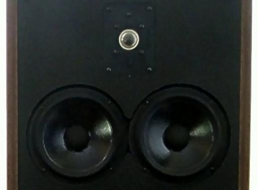

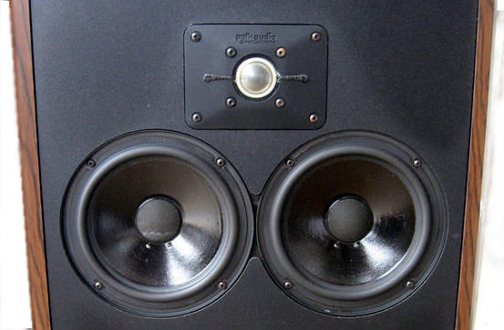

    I may not be fully understanding what I should about how the driver offset of the drivers will effect the outcome. Sometimes things take a while to soak in.
    I realize the 10 and CRS have different spacing between the drivers. But, the SDA-2 and CRSs use the same tweeters, crossovers and drivers in the '87 versions so they are the same parts in different cabinets, excluding the PR of course.
    As you can see in the photos below, a monitor 10 on the left and a SDA-2 on the right, the drivers are located with the same spacing. I looks like they could have used the same template to cut all the holes. With that in mind, how would the driver offset be a factor in the sound when putting SDA drivers in a monitor 10 cabinet? I know there are a lot of other factors to consider but right now I'm wanting get a good understanding of the driver spacing.
    Again, I don't mean to sound argumentative. Keep in mind that I'm a newbie at this stuff and I'm just gathering information I need to know before starting on this. Thanks for all the input so far.

    Well guys, after sleeping on it last night I changed my mind again. I'm now the owner of a set of CRS+10Bs. Possibly the first set of them in existence. I know what every one says, "if there are no photos it didn't happen", so I posted a couple of photos below.
    I can lay to rest all the talk about different driver spacing between the CRS and the 10s killing the SDA. It didn't. In my room the SDA effect is as good today as it was yesterday before doing the CRS+10B swap. I will say that I may not have the best room for SDA according the reviews of others about how there SDAs sound. I don't get sounds from the rear and only rarely from 90* to the sides. I covered what SDA effects I hear in another thread if anyone whats to read about it.
    The bass of the 10Bs, that I missed in the CRS+, is back in the CRS+10Bs. Some like the bass of the 10s, some say it's bloated. To each his own. I happen to like it. This configuration seems to give a little more punch to the music over the stock CRS+.
    I'm not going to get into a debate about whether or not the CRS+10Bs sound better than the CRS+. I like my CRS+ speakers and I like the CRS+10Bs really well so far. I'm probably bias due to this swap being my idea. I have only listened for a couple of hours so far but at this point I have no regrets on the CRS+10B swap. I want to wait for someone else to do the swap and then report their results and they can recommend for or against doing the swap.
    I intend to do a lot more listening tonight. I like to listen in the dark when everything is quiet. I think I'm going to like what I hear.
    The swap can be done without doing any modification to either speaker with the exception of drilling one hole in the brace behind the drivers in the 10s cabinet to mount the crossover. If you don't care to drill a hole in the back of the cabinet that would be a better choice. Since I didn't know the outcome of this project I didn't want to drill a hole in the back.
    A 1/4" hole in the braces is needed for the screw. I didn't have a 90* angle drill so I had to drill the hole in the brace by hand, using a drill bit with a hex on the end and a 1/4" drive socket and ratchet. Not all that hard. Just takes some time. The hole is drilled in the center of the brace up 3-3/4" from the bottom surface. I had to scrape off some hot glue from the brace to allow the crossover to mount flush against the brace.
    I did discover that the CRS+10Bs didn't like the tilted stands that I made for my 10Bs. The speakers sitting straight up works the best.
    If anyone has questions feel free to ask. If anyone does the swap I recommend throwing on ZZTop - Cheap Sun Glasses first thing. You will know right away if you made the right decision.
