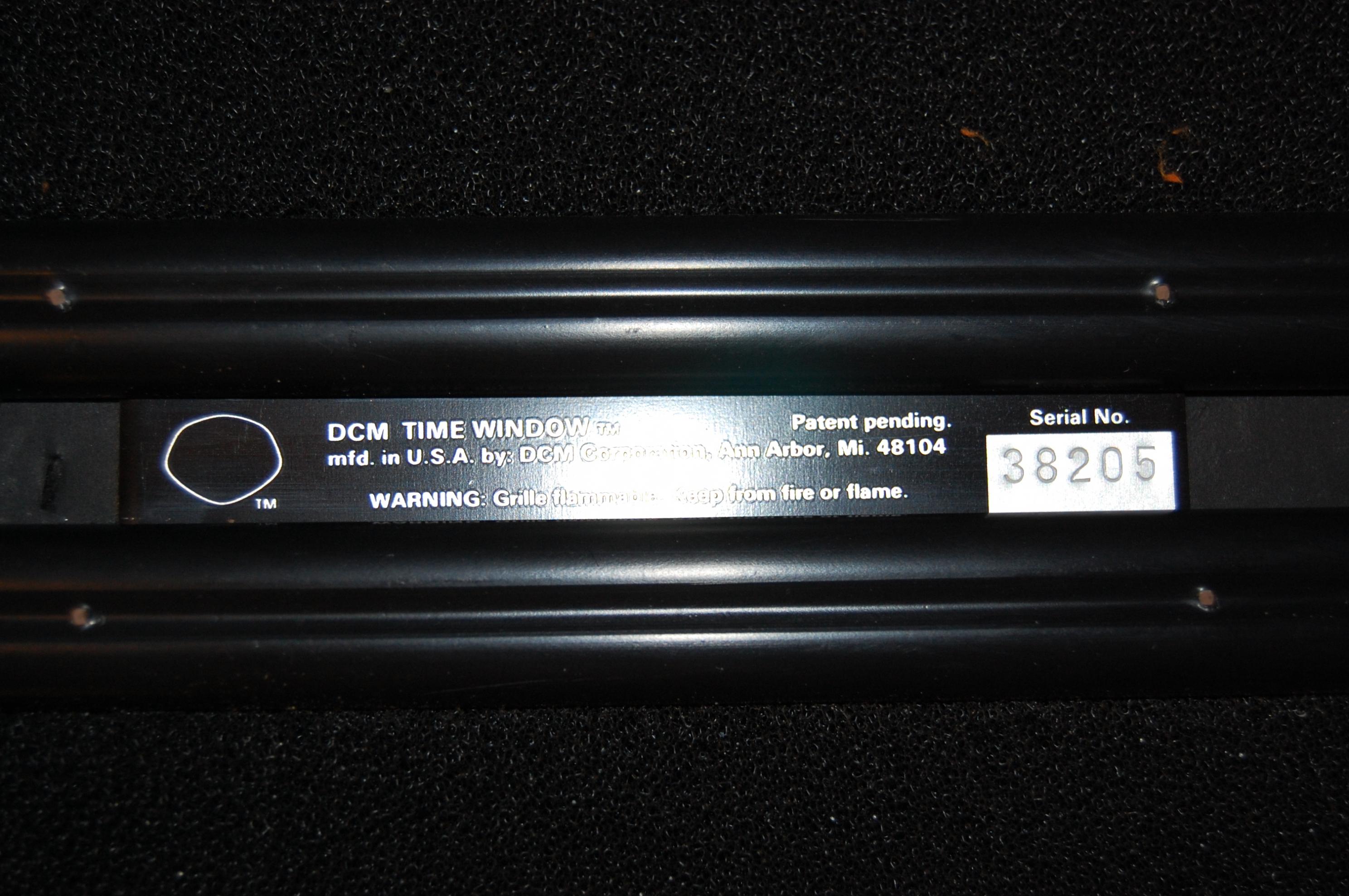

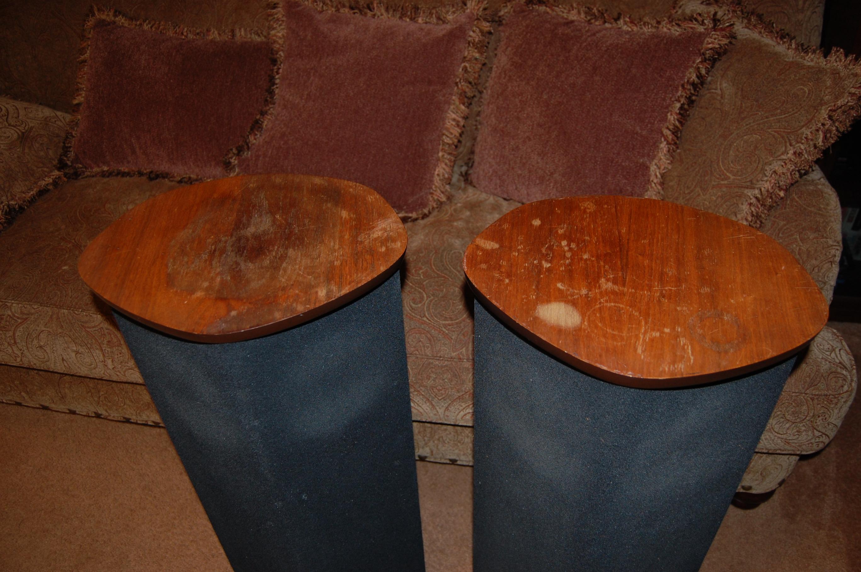

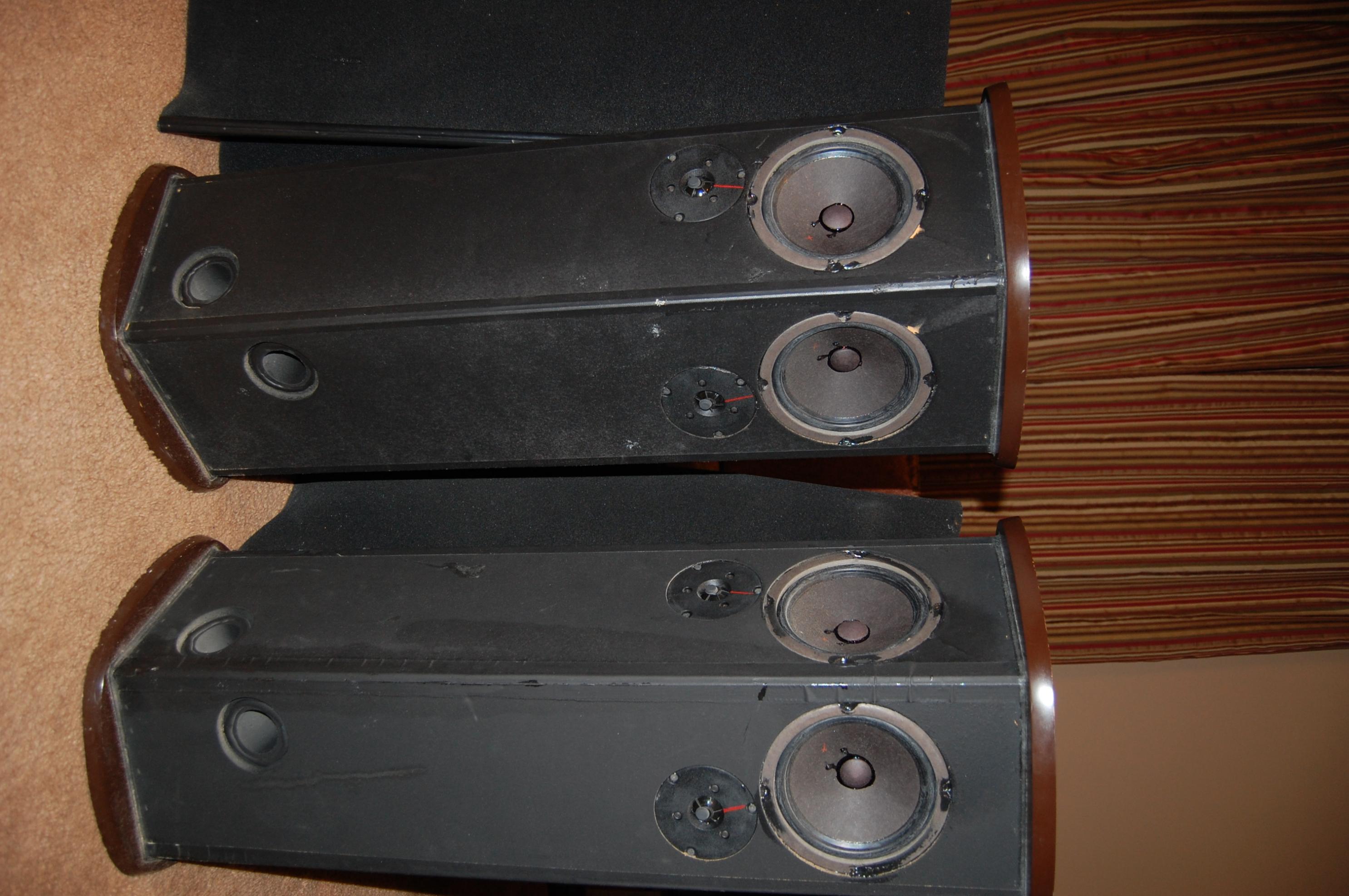

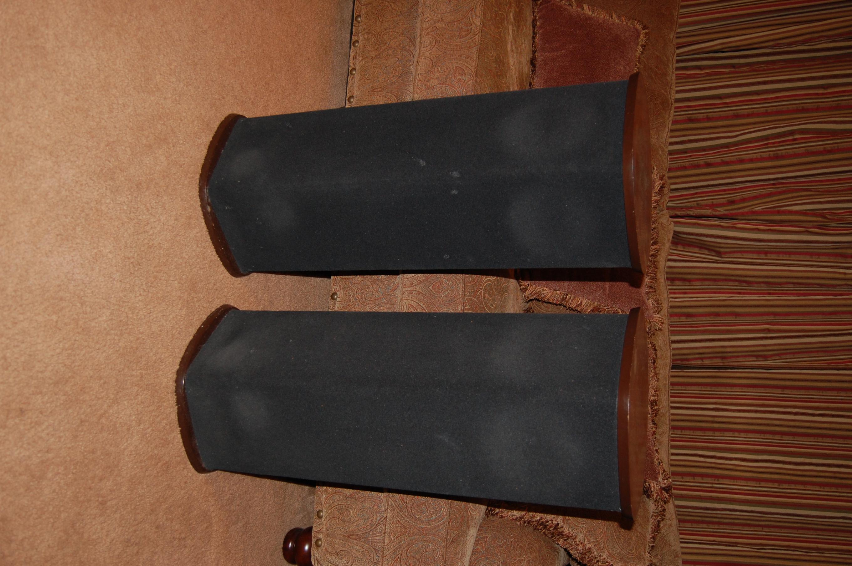

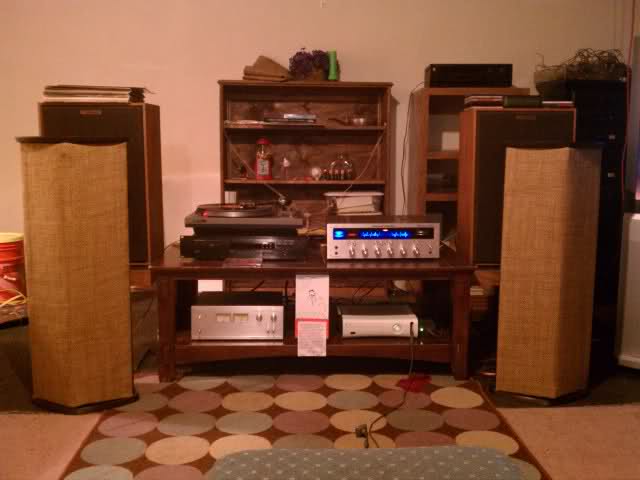

I have been a DCM fan for a while but until this weekend have never heard any version of the Time Windows. I picked up this pair at what seemed to be a fair price (current prices for these on E-bay are all over the place from $100 to $400) at $130. Normally i would say plus travel but this time it worked out that my wife and I were taking our girls to an exhibit right down the road from where I met the seller. So the travel worked out as a plus towards the purchase.

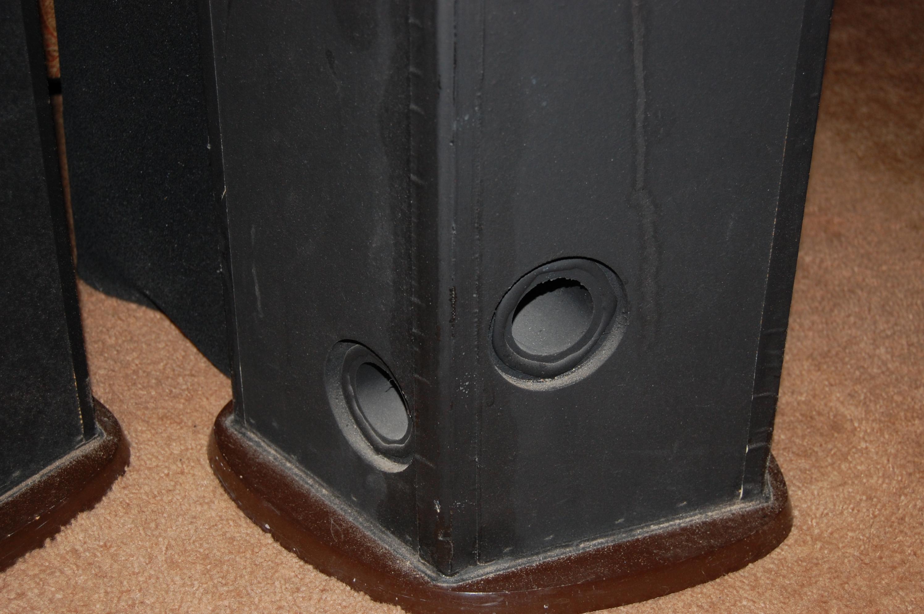

Anyway, on to the details. The cabinets are in good shape with the original foam covers in pretty good shape as well with nothing more than tiny pits in the foam. The wood top and bottom plates leave something to be desired with the stains on them. However, even the wood is not chipped or dented, etc. Only bad to the eye but not to the touch. Consecutive serial #'s, all original drivers in great shape, the drivers all have matching factory markings and show no signs of ever being replaced or tampered with. I believe I can sand and re-stain the wood, clean the cabinets and foam well and turn the foams inside out where they are perfect, and have a beautiful pair of Time Windows. In fact I have stain left over from the SRS restoration/ rebuild.

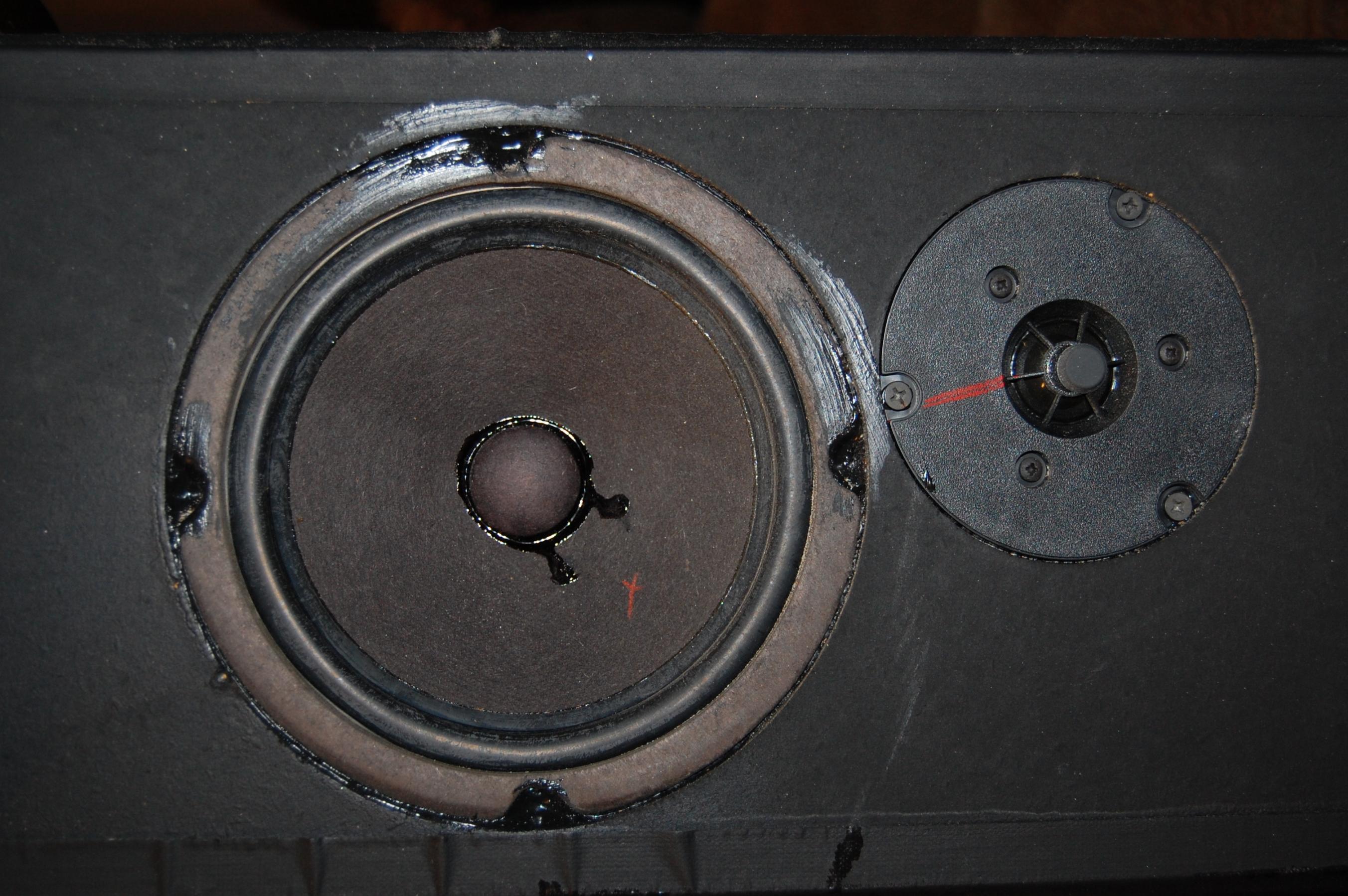

Next, for the very bad points. These look as if they will be horrible to take apart. Everything looks to be glued together. I see no way to easily remove the wood. The speakers even appear to have a good bit of glue around them and even the screw heads on the mid/ bass drivers. The only thing easy to remove on these is the foam covers.
Now the sound; AMAZING, better than any other speaker I own besides maybe the SDA 2A's (At least from the listening I have done so far). Though not the deep, wide sound-stage of any of the SDA's, much better than most other speakers I have heard. Right up there with the open baffle Infinities and 180 degree Mirage's, they seem to fill the room with sound. The full spectrum detail is much better than any of the SDA's (please note that none of mine currently have the RDO's so I can't compare to speakers using those). Less bass than the SDA's but seemingly just as deep. All this with what i assume to be the original crossover components. I am sure recapping and new resistors will improve the sound dramatically, but I want to get some more listening in first. Since these are so hard to dismantle, I want to be ready to restore them completely when they come apart for anything.

    If you need to get the drivers out? Unless they are bad i would leave them alone. You need to use a razor and get them separated from the goop they used to seal them to the cab. I helped a buddy with a pair years ago and we got the goop off and used thin foam to seal them instead. It worked just as well and if he needs to get in he can.

    The end caps are not too difficult to get off. They use glue and pressure dowels. If you use a block and a rubber mallet in small strokes upward around the bottom (with the speakers upside-down), it will come off with no problem. That tar-like goop that is used around the drivers is the sealant and I have found the amount to be highly variable on different units. Some were more gooped up than others, and that stuff is not fun to remove. If you can get to the screws easily enough, remove them first then pry gently and evenly around the frame of the woofer or tweeter and you shouldnt have too much of an issue. I have owned a lot of DCMs and the TWs are one of my favorites. You cannot purchase the original grill cloth anymore because it was found to be highly flammable, but the replacement that was used on the 1a's and up is still available. the originals are the easiest to reupholster because it is just a sheet rapped around and held on the aluminum rails with those rubber channels rather than the "sock" of all the other versions. Even though these are not easy to work on, they're worth it, IMO. DCM made an even bigger erpair challenge called the Macrophone. It was an awesome speaker but getting into it was a real PITA.

    Mine do not have aluminum rails or rubber channels. they have a plastic strip that is simply nailed on with tiny finish nails straight into the tube part of the enclosure. I'm not sure if this tells anything about the production of these or not.
    mhardy6647 Posts: 35,289
    edited February 2012
    Mine are like yours (one of the strips has been lost to the ages). I believe mine to be the original series Timewindows; I think that yours are, too.

    Good luck with yours, BTW, jamie talks about using a hair dryer to loosen the goop to help get it loose to remove drivers and or end caps.

    Those are almost positively TimeWindow 1's. The wood is slightly darker than the 1A, and they do not have the threaded rod running down the center and the nut on the bottom. They also have 2 ports on the front, as opposed the the 1A which has only 1 port on the front. The 1A also has a 'flap' of sorts that covers the top 1/4 or so of the 6.5" driver. Wonderful speakers, the 1A sounds almost indistinguishable from the 1. I will reiterate other's suggestions for giving them some serious powers. I have run then with 35wpc Harman Kardons with good results, but they really show their stuff when you get into the 80+wpc SS arena. I have heard of people running 200+wpc into TW's comfortably.

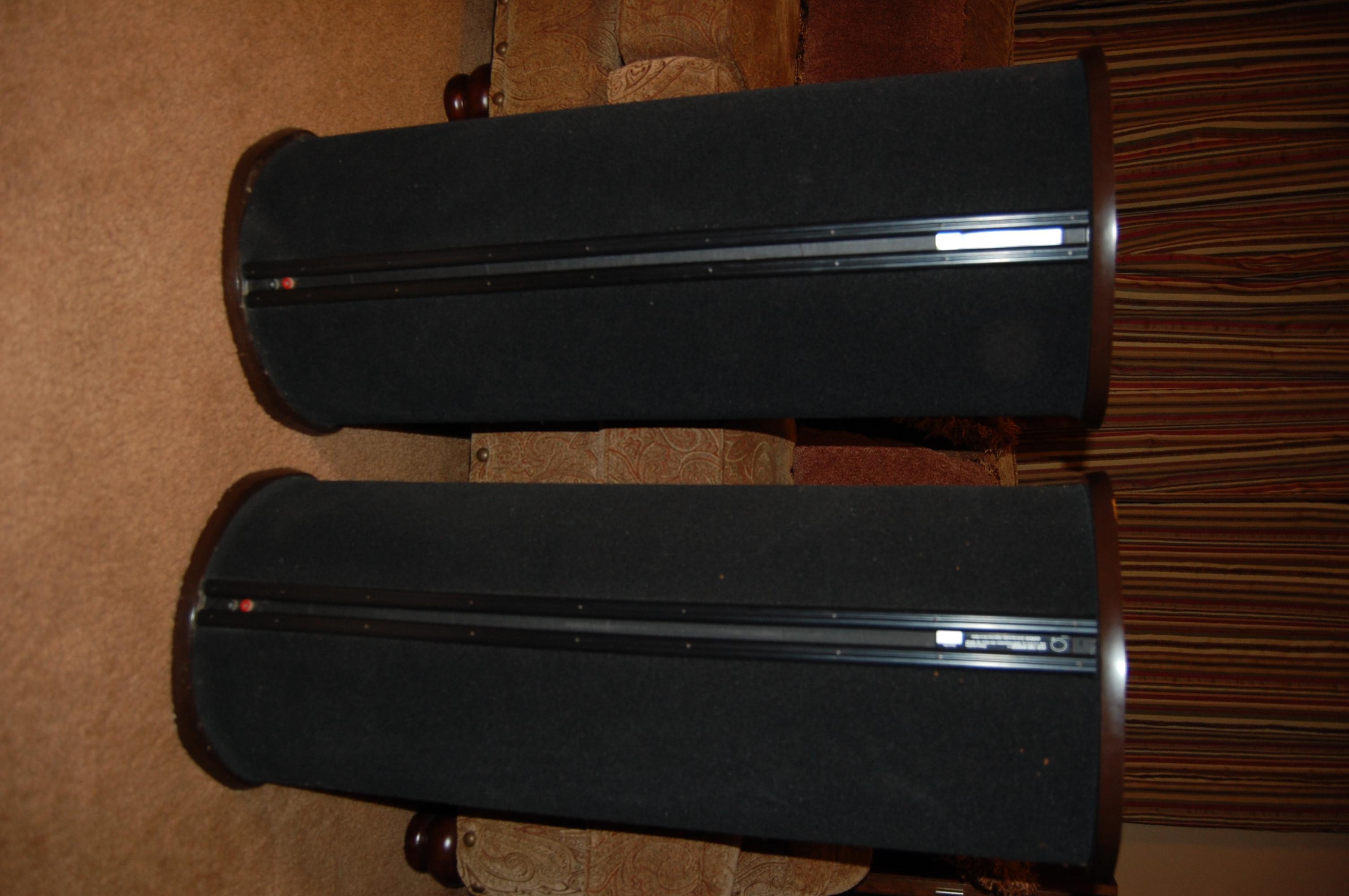

    Those are def. the originals.
    the 1as have that felt "eyelid" over the top drivers, the model 3s go even further, with an anti diffraction lens with felt sandwiched between.
    To look at the speaks, even through the felt, you can clearly see what looks like a plus sign instead of the round driver.
    Also, the model 3s (pictured below) were the first to use the adjustable pots on the back for customizing the sound to the room.
