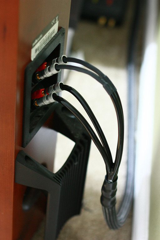

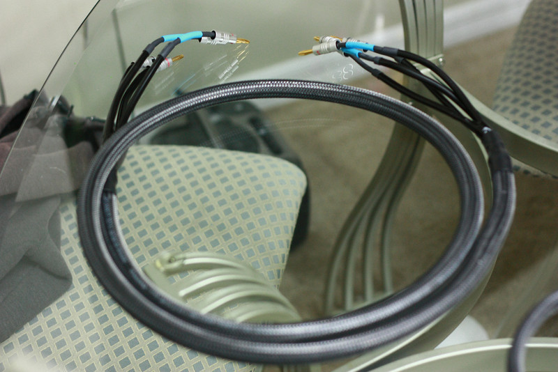

I used some how-tos and made my own cables. I got so tired of ugly looking wires running behind my tv stand and out to my speakers, and what made matters worse was that I bi-amp my mains. So i upgraded. I purchased some 12/4 stranded wire, techflex, heat shrink, cable pants, and some new nanner plugs. I dunno if the sound improved over the 12 awg i was using before but these look so much more professional, the look alone was worth the effort.
I used the Namakachi plugs from ebay and I was very impressed with the quality for the price. The clamp down tight on the wire and dont let go and they lock into the speakers very nicely too. They also look pretty slick IMO. I like them alot more then the monoprice ones i had. I took heat shrink and covered the set screws so that they wont back out. I figure it cant hurt.

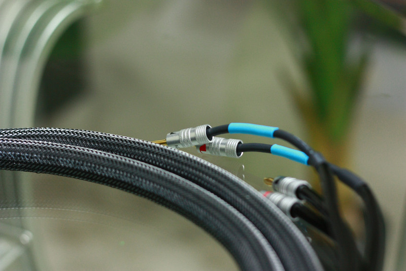

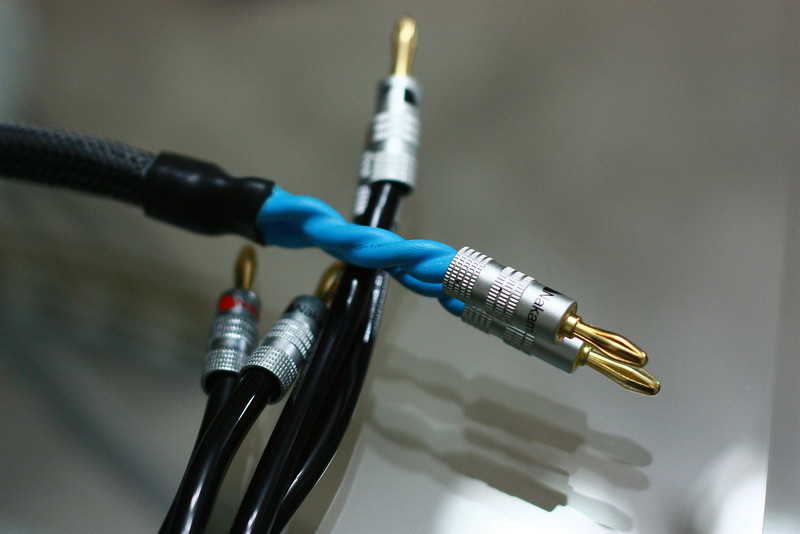

    Nice job, and good call on the Nakamichi plugs. I prefer them over the Monoprice too. If I may make one suggestion, it would be to put some heat-shrink around the base of the banana plugs to seal them to the rest of the cable, like this:
    The more air and moisture you can keep away from the copper, the longer it will last before it corrodes.

    Yup or if your handy you could always tin the ends of the wire like this:

    Funny what a little techflex and a bit of heatshrink can do. Those are some handsome cables! Great job :)
    Just out of curiosity, where did you get your wire? Mine is Canare 4x14AWG and I'm very happy with it, especially for the price.
