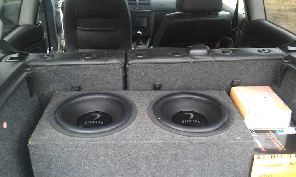

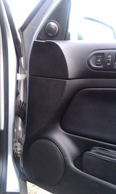

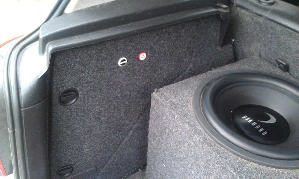

    Ok, system is alll done, albeit subs are temporary. Tried to keep the whole thing pretty low key, I think it turned out pretty well. Here's a couple pics:
    JVC KW-AVX840
    MM6501
    PA D4000.4
    Diamond Audio D1
    I did screw up the driver side sail panel, which is why there are no pictures of that side...it'll be remedied soon enough. The setup sounds awesome, leagues better than any car system I've had in the past. I'm really glad I went with the MMs, I love the silky sweet highs. I'm also really happy with the JVC head, I did have my doubts because of the reputation they've had in the past, but at the price I paid (under $400) this is a great looking, great sounding unit (4v pres) and it has a pretty nice flexible eq section too (even though I tend to EQ really lightly - 1db cut @ 500hz and that's it). The only thing I need now is to get an SR104 DVC and then I'm really done.

  • MacLeod
    MacLeod Posts: 14,358
    edited February 2012
    Umm, that amp install looks pretty scary. Could ya route those wires a little better? Im not a big stickler on wire management that you cant see but right there at the connections, Id want it a little more high and tight. All scrunched up like that and one could pop out and could literally catch that trunk liner on fire. Granted thats a worse case scenario but it could happen.
    polkaudio sound quality competitor since 2005
    MECA SQ Rookie of the Year 06 ~ MECA State Champ 06,07,08,11 ~ MECA World Finals 2nd place 06,07,08,09
    08 Car Audio Nationals 1st ~ 07 N Georgia Nationals 1st ~ 06 Carl Casper Nationals 1st ~ USACi 05 Southeast AutumnFest 1st
    polkaudio SR6500 --- polkaudio MM1040 x2 -- Pioneer P99 -- Rockford Fosgate P1000X5D
  • ocharlas
    ocharlas Posts: 61
    I'll check it out, but my mounting options are actually pretty limited. The amp is mounted on the same plate that the factory amp was attached to, the only difference is that the factory amp was about half the size. This amp is, to about 3mm, the exact same size as the plate it's mounted on. So if I move the amp up, then the top won't be secured to anything, it'll just be the two bolts at the bottom keeping it secure. And they're not that big. And unfortunately I don't have any play as to where the plate goes since it bolts right into the car. I don't think it's going to (the wires are clamped down really tight), but if the ground or battery popped out, wouldn't the amp just turn off?
  • BeefJerky
    BeefJerky Posts: 1,320
    ocharlas wrote: »
    Sure the amp would turn off. However, if the battery cable touched any ground point directly, that would be a short, which could start a fire somewhere along the wire. It could also spark which could start a fire at the point where it touched ground. Hopefully your fuse would pop before anything bad happened. You did install a fuse on the amplifiers battery cable right near the battery, correct?
  • ocharlas
    ocharlas Posts: 61
    BeefJerky wrote: »
    Sure did
  • KaosTsoc
    KaosTsoc Posts: 372
    It is not the position of the amp, but more of how the wires look. Mac like myself are really picky about how the wires should be. We like to zip tie, or tape lets say all speak wires together, then tape or tie the ground, power, and remote wires together. One good reason to do this is like what was mentioned above. The other reason, is it just looks better, and easier to maintaine if you had to get in there to do repair work or what not. There is nothing more frustrating then when you try to pull out a piece of equipment or try to make repairs, than having a bunch of wire all over the place. Just gets in the way, and boggs you down. Like I said I am just picky like that. Plus when you get to Mac level, and doing compitions, they look at the install as well, and this could mean the difference in winning by a landslide, a few points or a fraction of a point. Also really happy to hear you put in a fuse as well, this will help when needed.
    Thanks.
