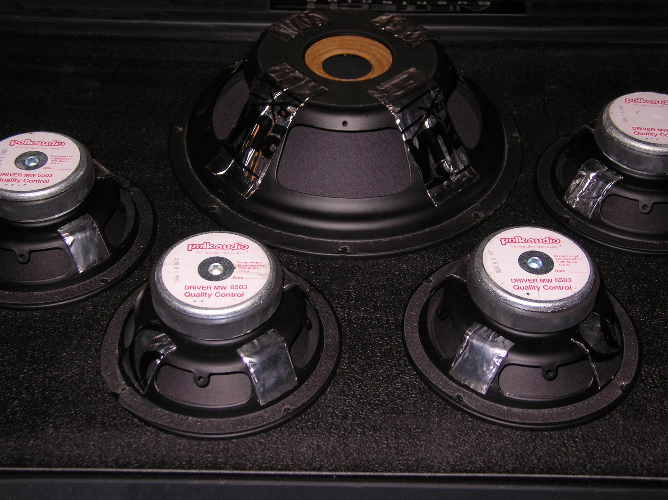

Finished the x-overs last evening. While I had the drivers out I decided to follow thsmiths advice and Dynamat the baskets. I must admit that at first I doubted this would make much, if any, difference. However, it is amazing how an untreated basket "rings" when you tap it. Once Dynamatted, it makes a nice dull "thud" which I'm sure must add to the sonice accuracy of the drivers.

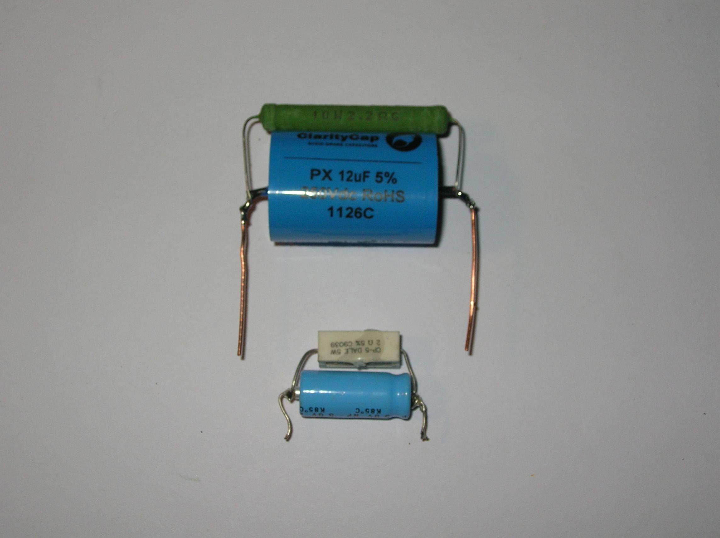

In my rush and excitement, I neglected to take a "before" pic so I can't provide the dramatic side by side comparison, but here's a pic of the same 12uf cap with 2 ohm resistor, stock (bottom) vs replacement (top)

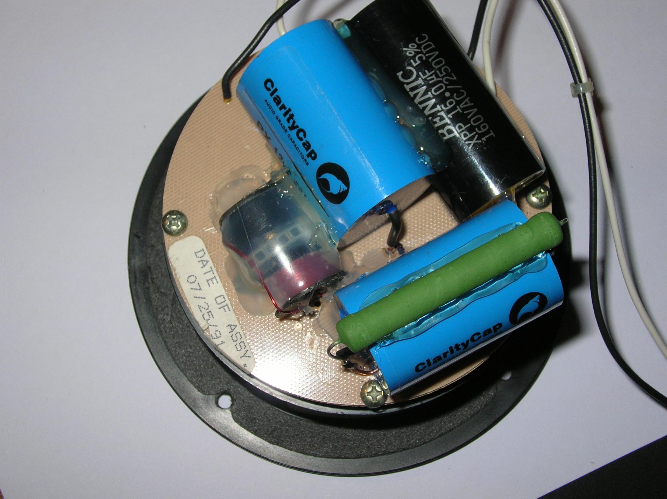

Finally, the finished crossover:
So how does it sound? It only has a few hours on it but already I can hear much more hidden detail and a much wider and open soundstage. The tweeters still sound a bit flat to me. I'm wondering if they may be at less than 100% and hoping that the next upgrade, RDO 198-1 tweeters, will open up the top end. Anyway, for less than $100 (caps, resistors and Dynamat) it sounds much better and a lot fun to do!Life's too short too listen to bad speakers
