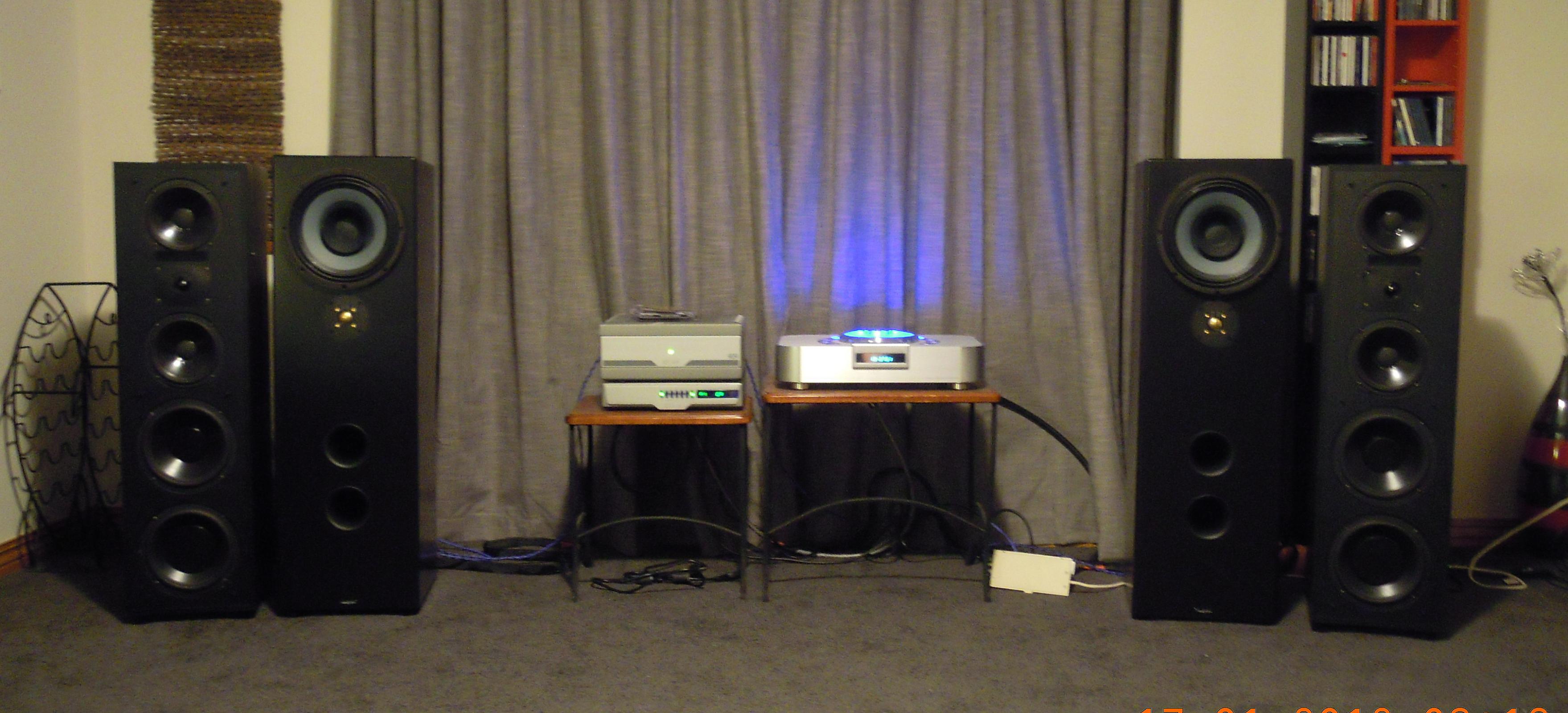

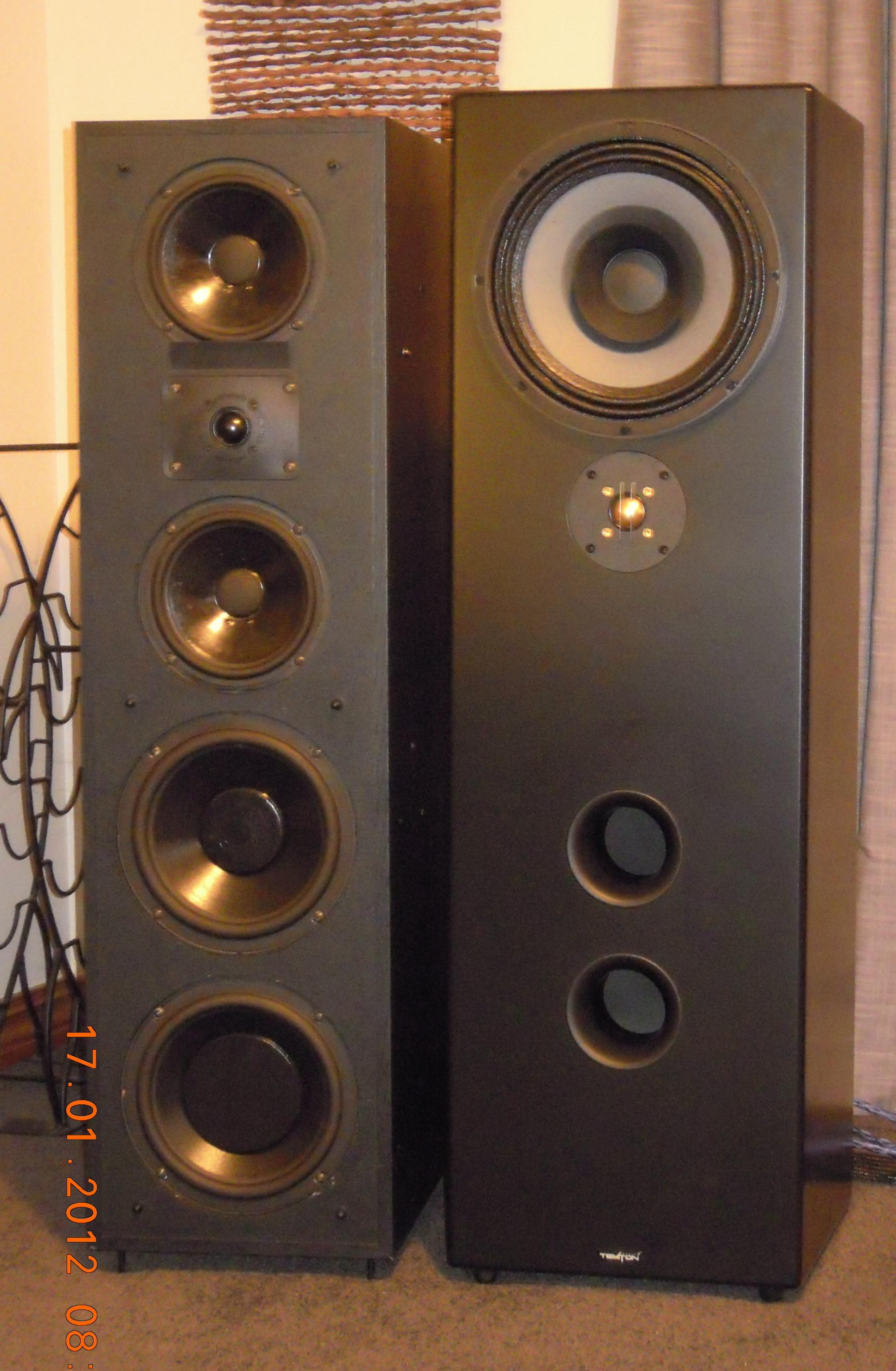

Here is why i ask.
I currently have some Tekton Lore speakers to try. http://www.tektondesign.com/
They are listed at 98db while my RTA11TL at 90db.
You may have seen in another thread that ive updated the xovers with Gen1 sonicaps and mills.
I expected with the sensitivity difference between the speakers to have to adjust the volume a bit but this isnt the case. They are pretty much the same output at the same volume. (by ear only)
I know that specs listed but maufactors can be a little out some times but 8db?:question:
anyway i just thought i would ask.
Cheers
Brad
Amp - Jas Audio Bravo 3.2 set
Power Cord - Tunami GPX
CDP - Marantz cd6002 - Audio gd Ref 5 Dac
Speakers - Tekton Lore,Polk Audio RTA11tl completely refreshed.
