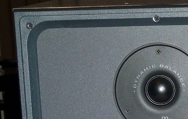

Hi Polk experts,
Just got another pair of Polk monitors but these are little different than my 5's and 4.6's.
Differences:
1. The tweeter has 'Dynamic Balance' on it along with 'Polk' instead of 'Polkaudio'.
Are these SL series tweeters or something older/newer?
2. There are two 6.5" woofers and not sure if both are active or one is passive.
The dust cap is the same in both so I suppose, these are both active.:idea:
The PR in 5's have larger flat dust cap.
3. The speaker connection is push in tabs instead of binding posts in 5's.
4. The black plastic front goes all around the front cabinet and grill flushes inside the black plastic front.
My 5's have grill that directly go on top exposing wood front cabinet.
What do I have here? 2 or 3 ways?
Attached are few pictures.
Thanks for ideas.

    DSkip wrote: »
    Google RTA-8 and see if that's what you got.
    RTA-8 has tweeter in the middle and one woofer above and another below as in the following thread:
    http://www.polkaudio.com/forums/showthread.php?22220-The-new-Polk-Rta8-s-pics

    DSkip wrote: »
    You added pics after I responded. Those are S8's.
    Sorry, I was trying to embed pictures in between lines instead of all at once in the bottom.
    Thanks for info.
    So these are S8's.
    Hmm... So is it okay to assume these are better than 5's I have? :)

    Yep S8's. And no, IMO the Monitor 5 is a better speaker. I have (had, just gave them to a friend) a pair of S10's. Same set up as yours just a larger passive in the bottom. To me they are not as refined as the Monitor 5 and the bass is boomy. And my S10's have real binding posts.

    halo71 wrote: »
    I see.
    Thanks for info.
    From S8 product manual, S8 are virtually identical in all specs except these go to 28hz and 5's go to 30hz.
    So 5's are still better.
    Hmm... need to test them side by side.
    I was in the impression that S8's are better since they use SL5000 tweeter and larger mid than 5's. :frown:

    Purely personal taste. But to me the 5's are nicer. But then again I've not heard the 8's. And I'd pay little attention to what the specs say on paper.

    Mystery wrote: »
    ...So 5's are still better.
    What makes you think the SL-5000 is better?
    What makes you think that a larger mid is better?
    They sound different. Listen too them and see what floats your boat.
    If you're looking for a cheap improvement for the 5's, you could replace the tweeters with their new replacements, the RD0-194.

    If they have 6.5 inch driver and passive, you have a pair of model S6.

    They look like S6, possibly S8. I can't tell the size of the PR. The S8 is actually very pleasant playing speakers. The S10 is boomy. The design engineer said that they were designed for folks that like "mucho bass" and not as well balanced as the S6 and S8. I think the biggest drawback is the plastic fascia which is easily cracked and the plastic bezel around the tweeter that has plastic tabs to hold the magnet in place. I have a pair of S8's that I hope to do a shoot-out with against my Monitor 5A's and 5B's.
    Specs are attached.

    stubby wrote: »
    Actually, I was incorrect. The drivers are 7.5 inches from outside the basket. I was measuring the surrounds before.
    So these are S8. :)
    Specs are attached.
    S_Tech_Info.pdf
    Thanks. I have regular 5's (no A or B) and 4.6's that I can compare these S8 with.
