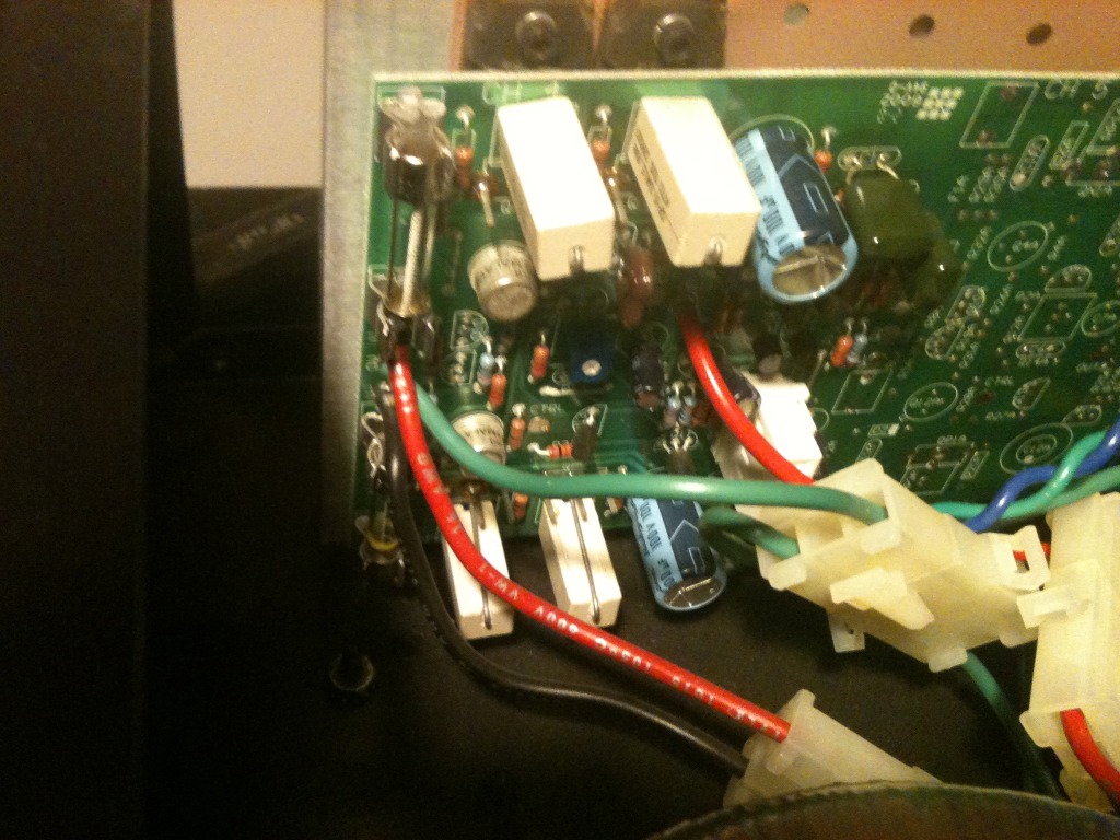

    OK, so i have a B&K AV5000 amp; in the owners manual, it states the following:
    "Replacement fuses:
    Line -12 Amp/250 Volt Slow Blow
    Rails - 4 Amp/250 Volt Slow Blow"
    My question is what is the difference between the "line" fuses and the "rail" fuses? I am linking a schematic as well if that helps (it is from diyaudio.com). There are a pair of fuses for each channel; one on top and one on bottom. Just not sure the differentiation and I don't see the fuses marked that I want to replace.
    Thanks in advance,
    Shawn
    Thanks in advance,
    Shawn
    Shawn, they are not line or rail fuses but part of the circuitry in you amp. Line fuse is for the line side of your amp, ect..

    thsmith wrote: »
    OK, this is not computing......:redface:
    Maybe I can take a picture of the guts and you can explain it? I just want to replace the actual fuses, which I think are all 4A/250V slow blow fuses. Am I not correct in assuming this?
    Thanks (and picture forthcoming),
    Shawn

    Picture as promised; thanks again for the help. To the left of the picture, you can see two fuses - one on top and one on bottom. Are both of these considered "rail" fuses?
    Shawn

    Yeah; they all had 4a/250v stamped on them, but i could tell some had been previously replaced. Just wanted to make sure they were right and saw the manual listed two fuse types. Just trying to figure out which is which.

    anonymouse wrote: »
    Chances are those are both rail fuses. The symmetry of the components leads me to believe they are there for the positive and negative rails. The line fuse will likely be on the main AC line. I am surprised that it has a value of 12A though. That is some serious juice that thing needs. You cannot have anything else besides that on a 15A circuit if its the AC line fuse.
    Makes sense now; thanks a lot man. Appreciate the input and explanation.
