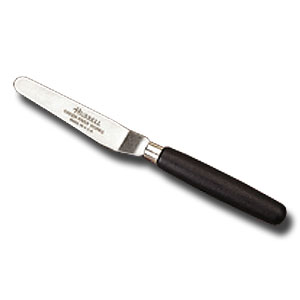

    I use an artist's palette knife to both mix & apply the JB Weld, works very well with excellent control. I use the regular and not the quick setting stuff. And LOTS of paper towels and acetone!:wink:
