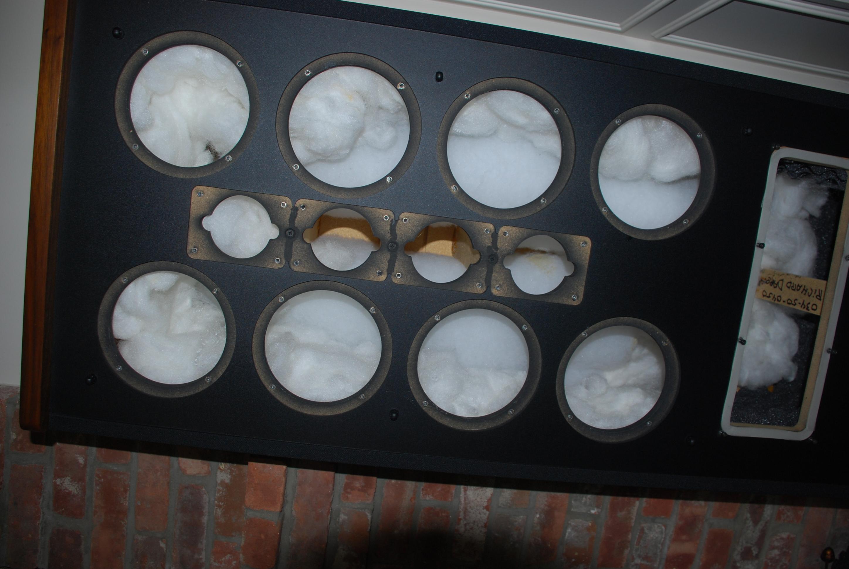

    Here's what the upper part of the cabinets looked like:
    Here's what the lower chamber looked like with the egg-crate foam:
    Here's the egg-crate foam I pulled out of ONE cabinet:
    I apologize once again for the screwy pictures; I couldn't figure out how to delete the "big" picture.
