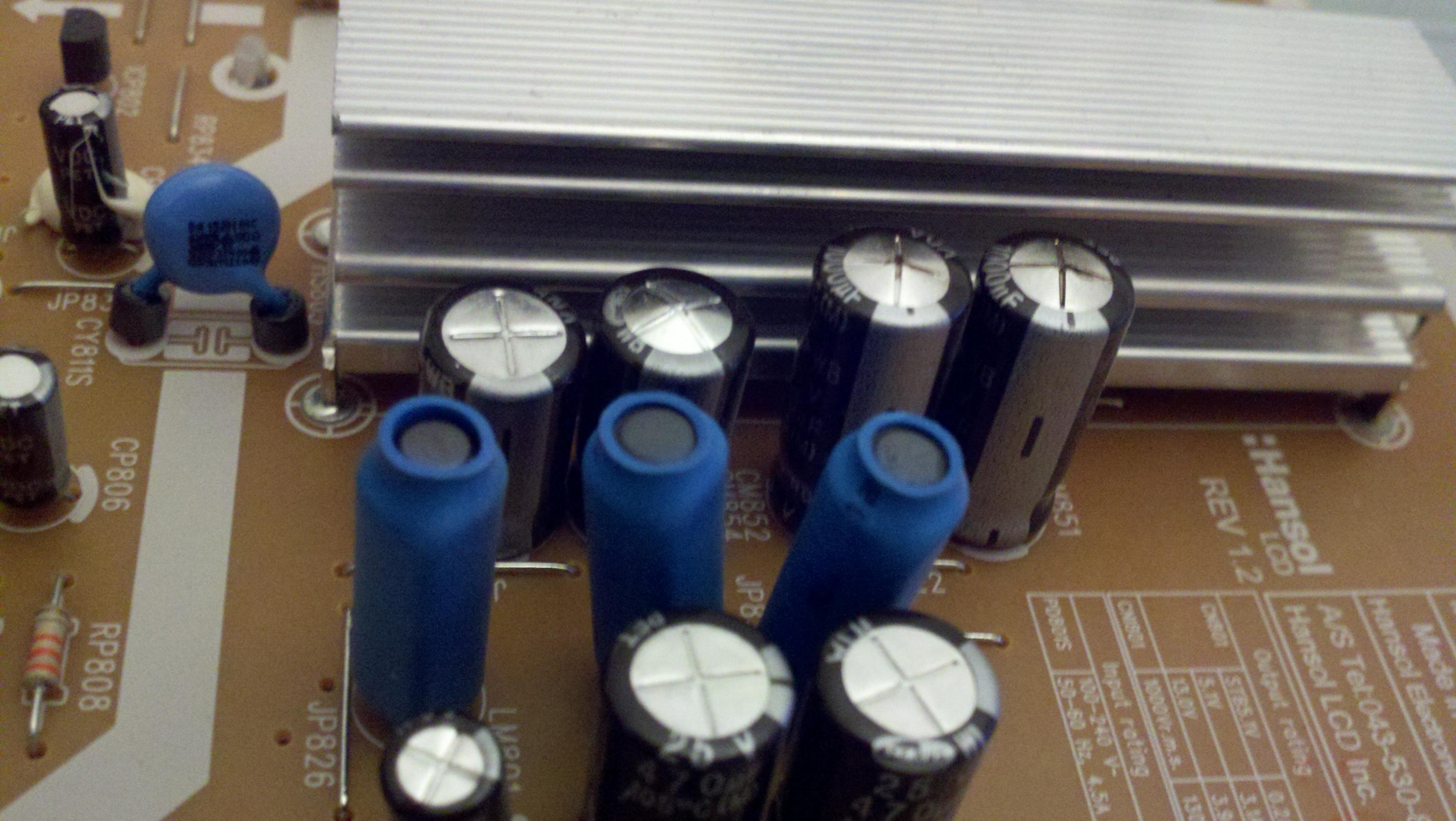

    These appear to look just like the ones you had in your TV.

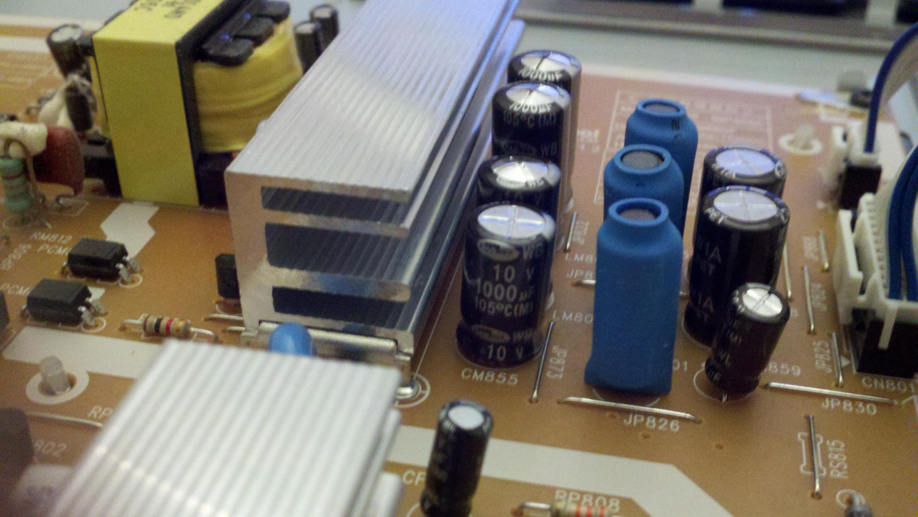

    i see the two 10V 1000uf caps. You say to get 12V 1000uf caps
    Also, the two that are blown are 25V 1000uf caps. Do these need to be upgraded as well?

    Those caps are certainly bulged at the top and are bad. No big surprise is that they are right next to a heat sink.
    That's the cause of the problem. Electrolytic caps and high heat sources don't make good neighbors. The end one in the one pic looks like it says 105 degree C so they did use more heat tolerant caps already.
    Any additional ventilation that you can encourage across that area would help the future life!
    Good luck with the repairs!
