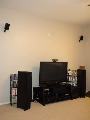

Hi guys,
I recently purchased a Pioneer VSX-1121-K to replace my dead Onkyo TX-SR606, and with some of the great prices lately on the older Polk Audio lines (Monitor, RTi), I've been seriously thinking about replacing my front left and right speakers. For a little (or a lot) background on my setup, here's a diagram of my living room / great room:

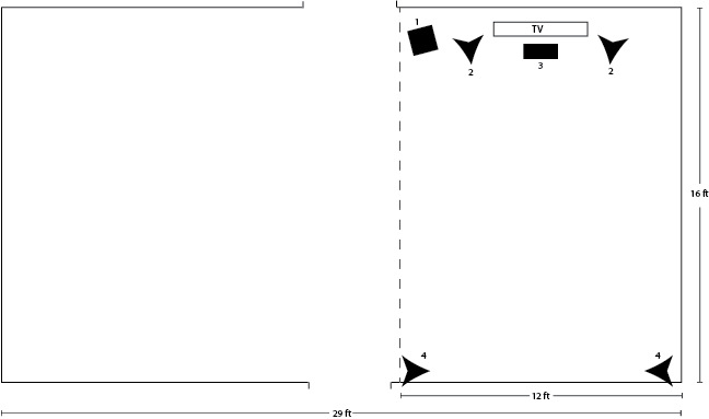

As you can see, it's about 29 feet long, 16 feet wide, and it's divided roughly in the middle by doors going into other rooms. The right side of the room is where the cable hookups were, so I decided to layout my home theater using that half of the room (my couch is against the back wall directly beneath the #4 back speakers). The entire room (29'x16') is carpeted.
From the numbers in the diagram:
  1. Polk PSW505 (specs link)
  2. Monster Streamline 100 Towers (specs link). Bought these for about $80 for the pair about 3 years ago when I bought my Onkyo 606 when Circuit City was going out of business. I knew Monster made overpriced cables, but didn't even know they made speakers. Since this was my first "serious" system, I decided anything had to be better than my old tiny Sony satellites. I can't seem to find a product link on the Monster website, but I linked to a Buy.com page that has the specs.
  3. Klipsch RC3 Center (specs link) - given to me by a co-worker. I don't think either of us realized how decent the speaker was until much later.
  4. Definitive Technology ProMonitor 800 (specs link) - Mounted on the back wall, about 8 feet off the ground, angled down at the listening area.
And again, I'm currently using the Pioneer VSX-1121-K. So, in my very-beginner-opinion, it seems that the Monster speakers are the "weakest" piece of my home theater - mainly because I haven't seen a lot of reviews on them, so I don't know if I really trust the listed specs or the MSRP of $600 on Amazon.com when they sell for $150 at Walmart.
We mainly watch movies (blu-rays), Netflix, and TV (most channels we watch come in w/ Dolby Digital over DirecTV). We do watch the occasional music concert that airs on TV. I'd say about 10% is gaming, and maybe another 10-15% is listening to music streamed from our computers (mp3s, not lossless). Now that we have the 1121-K, I suspect my wife will be using Airplay a lot to stream her iPhone music to the home theater, but again, most of those are 128-192 bit encoded MP3s.
I wouldn't say I'm a huge audiophile, but I have done a lot of reading lately to educate myself. But, if you tested me to see if could hear the difference between 192 and 128 bit encoded MP3s, I'd probably fail - though I don't think I've ever really tried to seriously test myself.

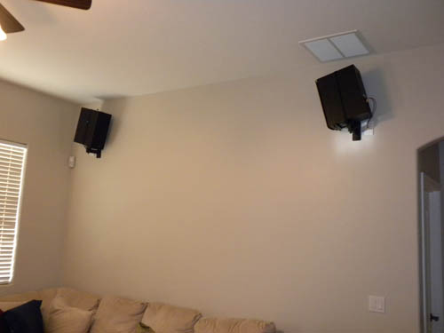

    This is what I'm thinking of doing:
    2 Monitor 70s to replace my Monster towers (incidentally, I just noticed a sticker on the back of the Monster that says their range is 120Hz - 22Khz)
    1 Monitor CS2 to replace my center Klipsch
    2 Monitor 30s or 40s for my front high speakers
    I'm a bit conflicted between the 30s and 40s though. I figure in a HT/movie setting, the 30s would do just fine with all the other speakers in play. However, I was thinking of occasionally using the front highs on Zone 2 to play 2 channel music while we played some family games like the Wii or Kinect (from what I've read, that should be possible?), which makes me lean towards the 40s, but the 40s are so much bigger than the 30s - I'm just thinking of the aesthetics of the speakers mounted to my wall and how far they'll stick out.
    Any thoughts/advice on the 30s vs 40s as front height speakers?

    I decided to skip the Monitor 30s and use my DT PM 800s for the front heights instead. I figure since they provide mostly ambient noise, it won't be too much of an issue, and saves me a bit of cash...... to eventually put towards a power amp :wink:
    I was able to test out the Zone 2 stuff, and it works pretty well - I was able to fire up the Xbox and listen to Airplay out of the Zone 2 speakers. But I was using giant speakers from an old Aiwa stereo system which, from the size, I'm guessing can hit the lows a little better than the Monitor30s or the DT PM 800s would. Also, the speakers need to be connected to the surround back, not the front high terminals like I initially thought. So, it'd be somewhat of a hassle to switch in to the proper config to play 2 audio sources, but at least it's good to know that it's possible.
    Thanks again everyone for your help!

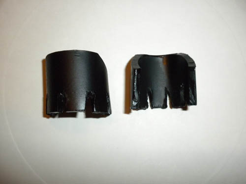

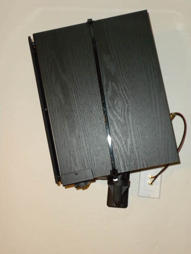

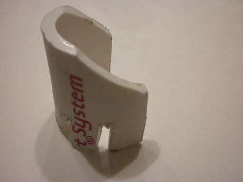

    One last question... From what I can gather, the Monitor40s don't have a keyhole slot on the back and I wasn't able to see if they have any mount holes on the bottom of the speaker. I've seen most people recommend the AM40 Pinpoint clamp mounts, but the problem is that they only tilt 7 degrees. In order for my current surrounds to be aimed in the general area of our ears on the couch, they're currently angled down at closer to 30 degrees.
    Is it a big issue if I can't aim the 40s closer to our ears?
