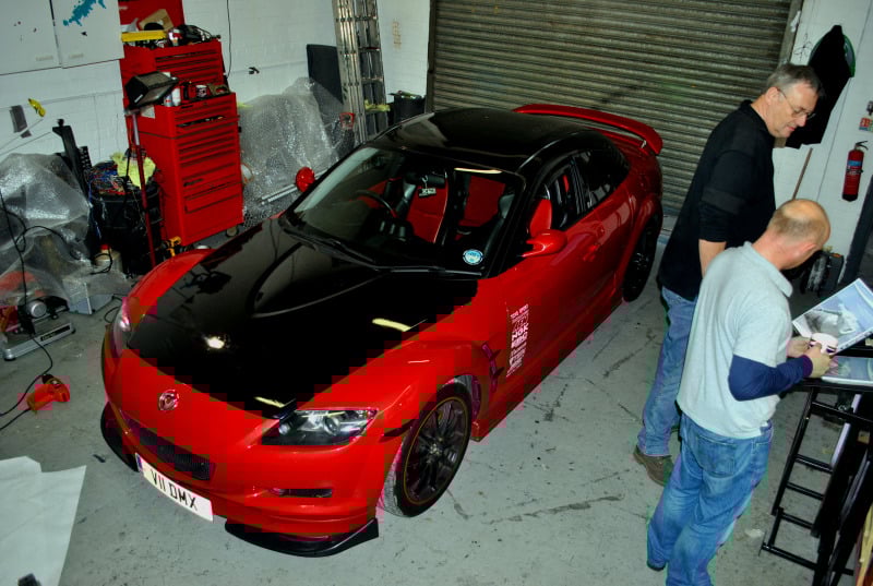

Oh and to wet your taste buds heres the car in question.

    BTW nice car and which one of the two gents, is you?
