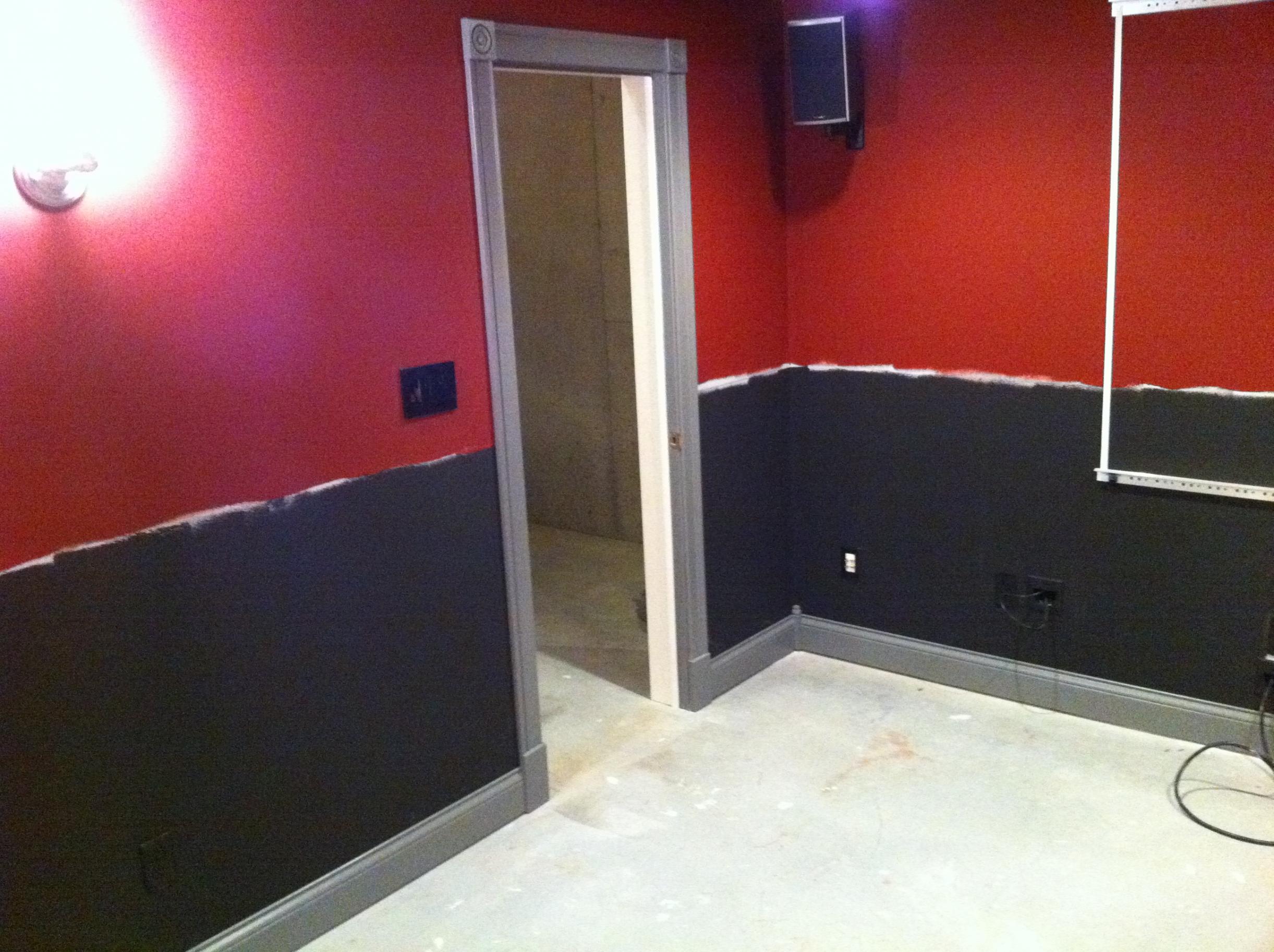

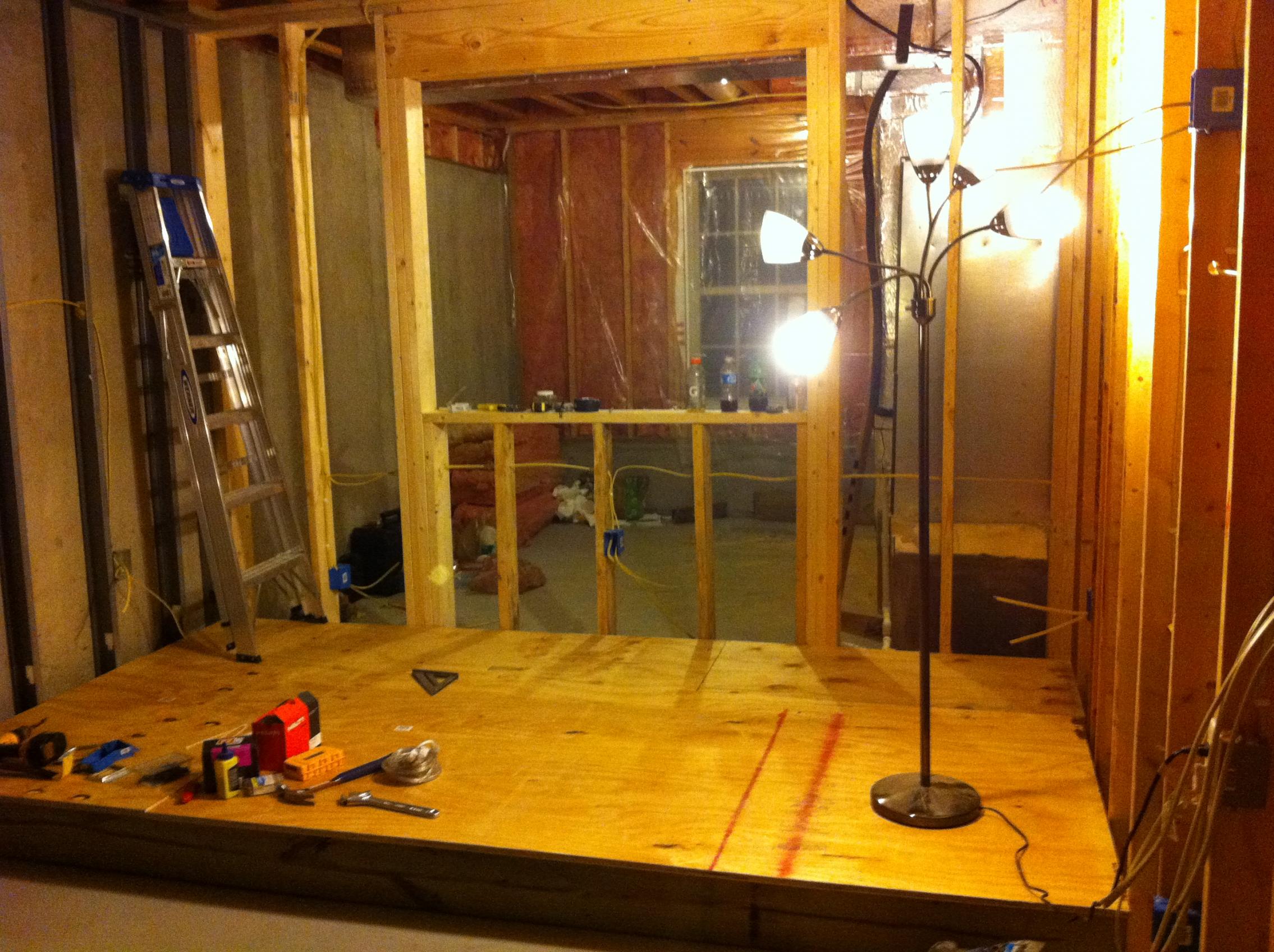

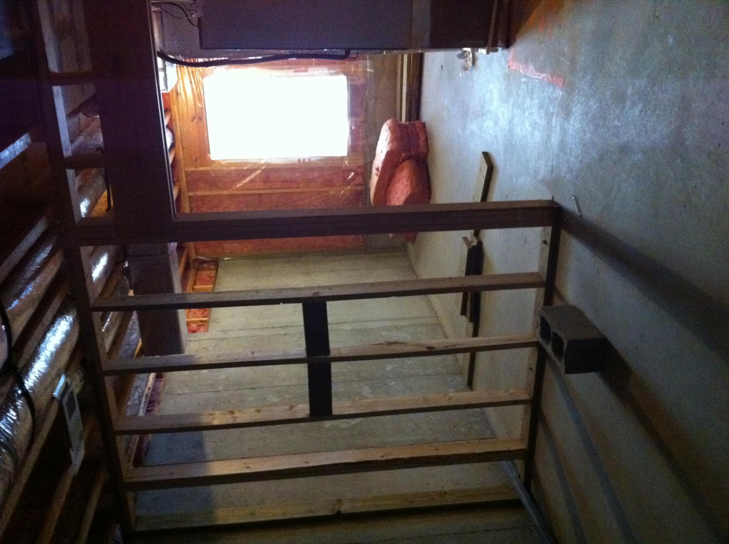

    Finally here are the pics as promised...not sure why they got turned counterclockwise on some since I had saved them correctly...sorry! I will be posting more when the room is all the way completed. Ended up doing all of this in less than a month (4 weekends- 2 very hard weekends and 2 ~ well you know...)

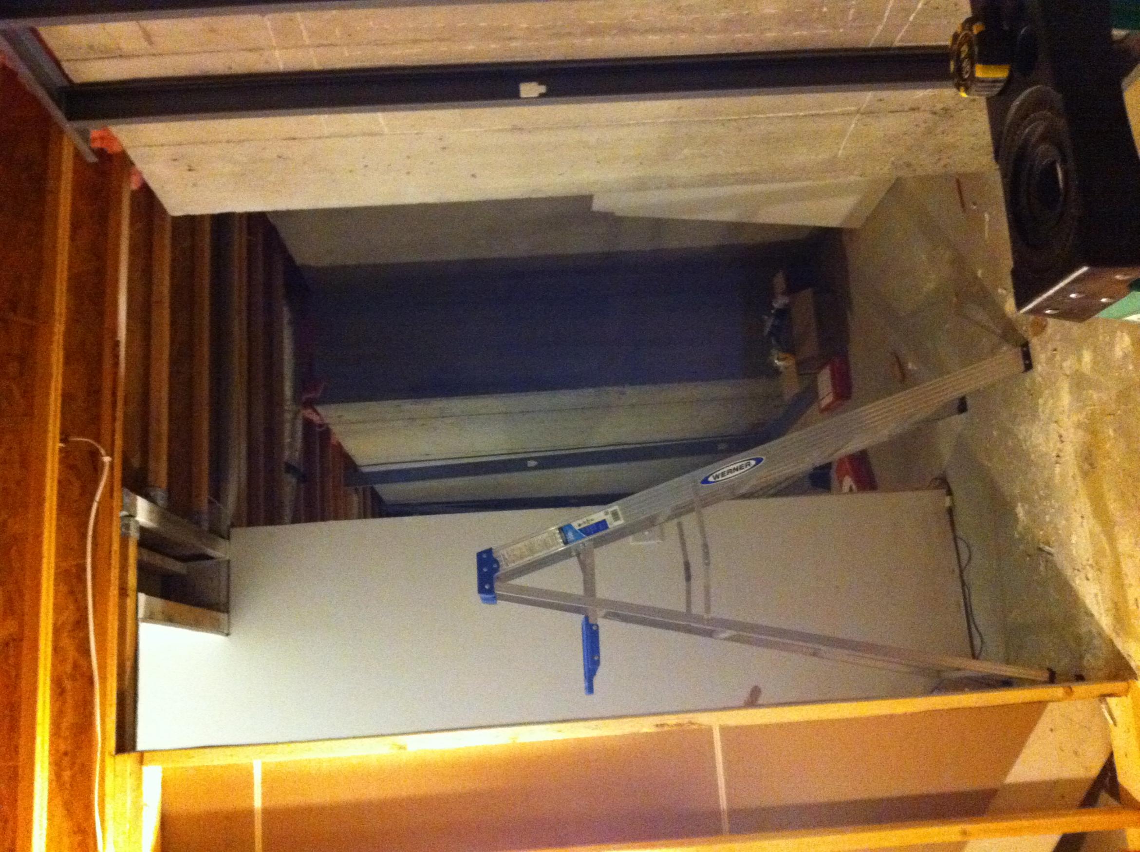

    Start of room-

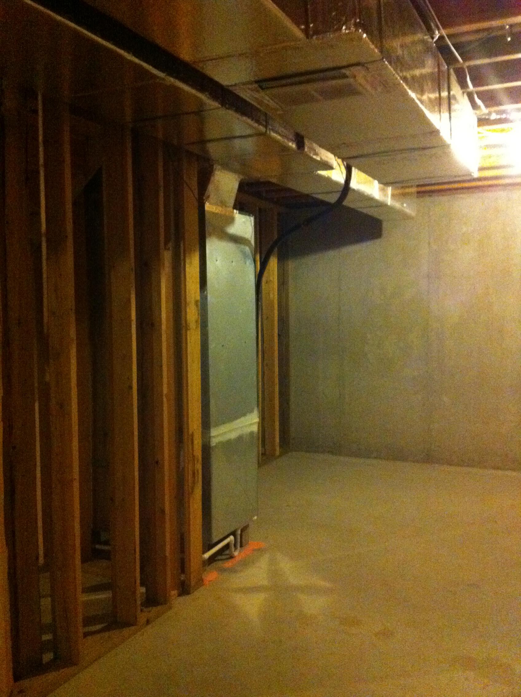

    Old HVAC placement-

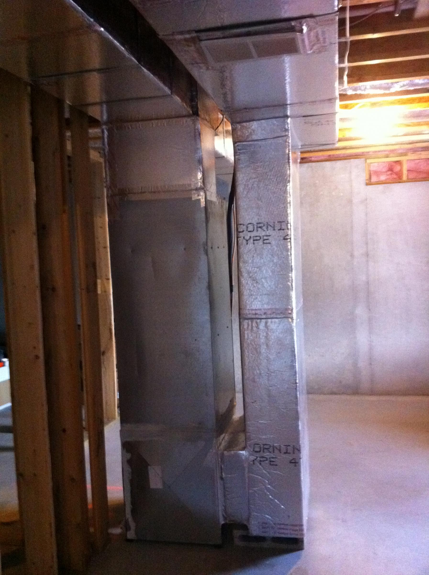

    HVAC unit moved back 3 feet- old placement is now back of room-

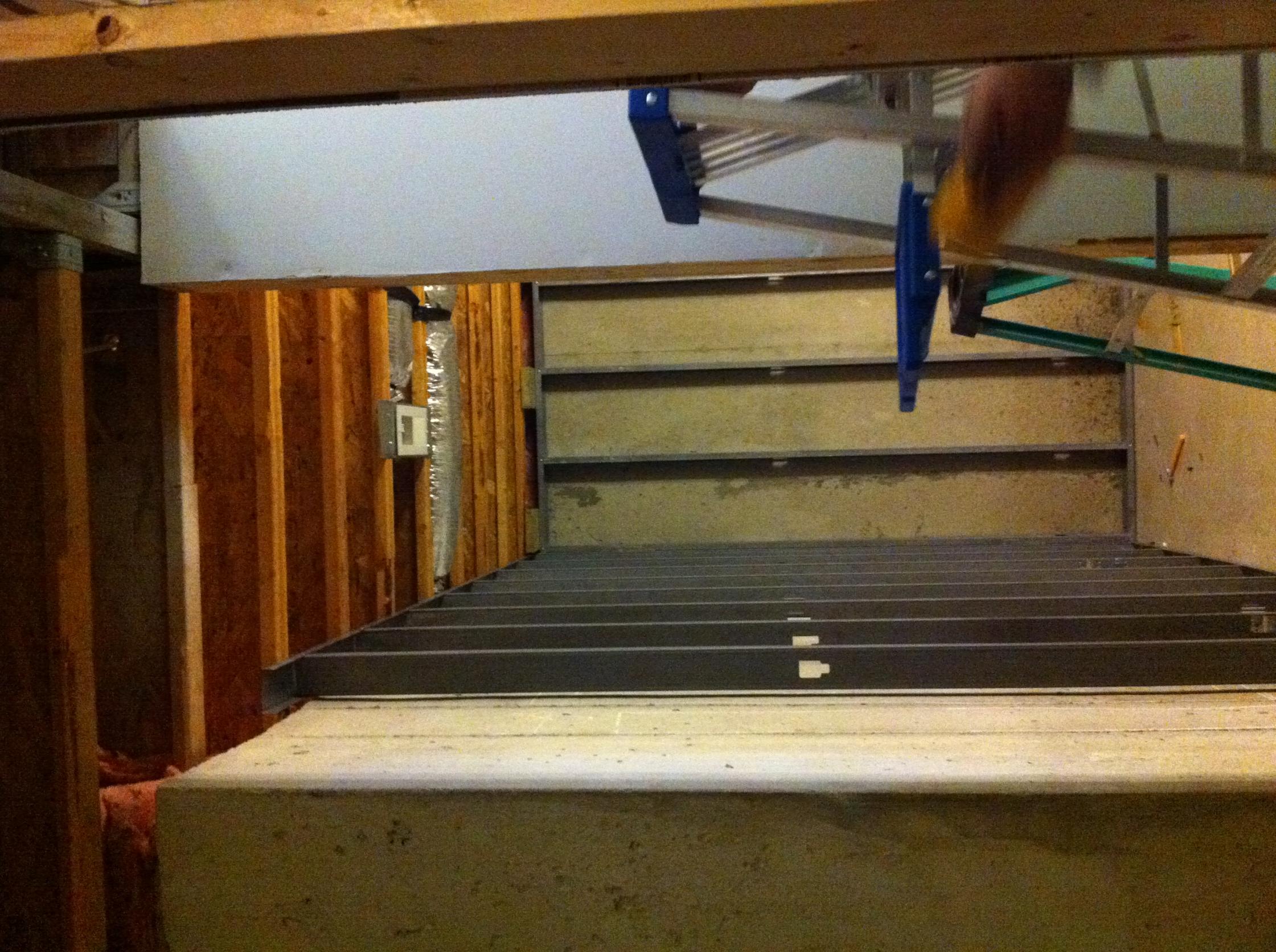

    Old door placement-

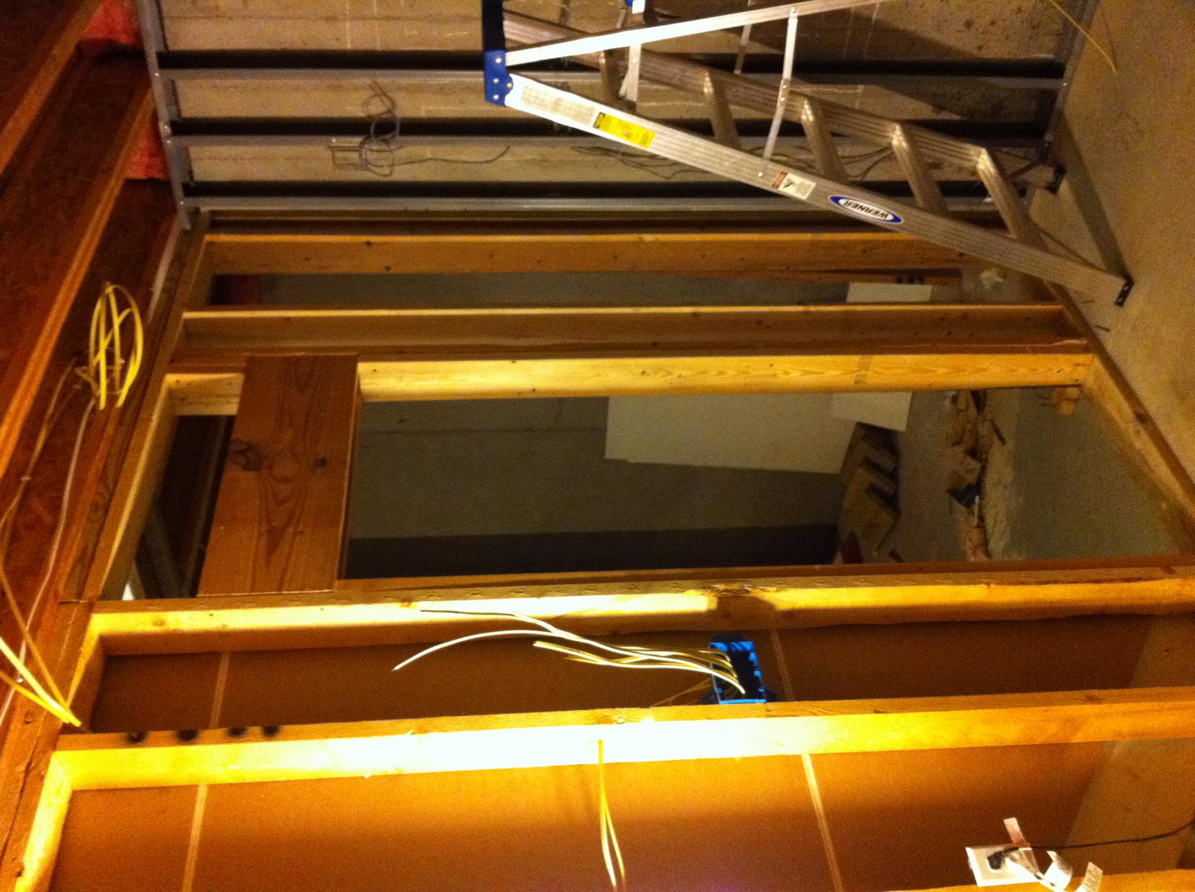

    Open door frame-
    New door framed-

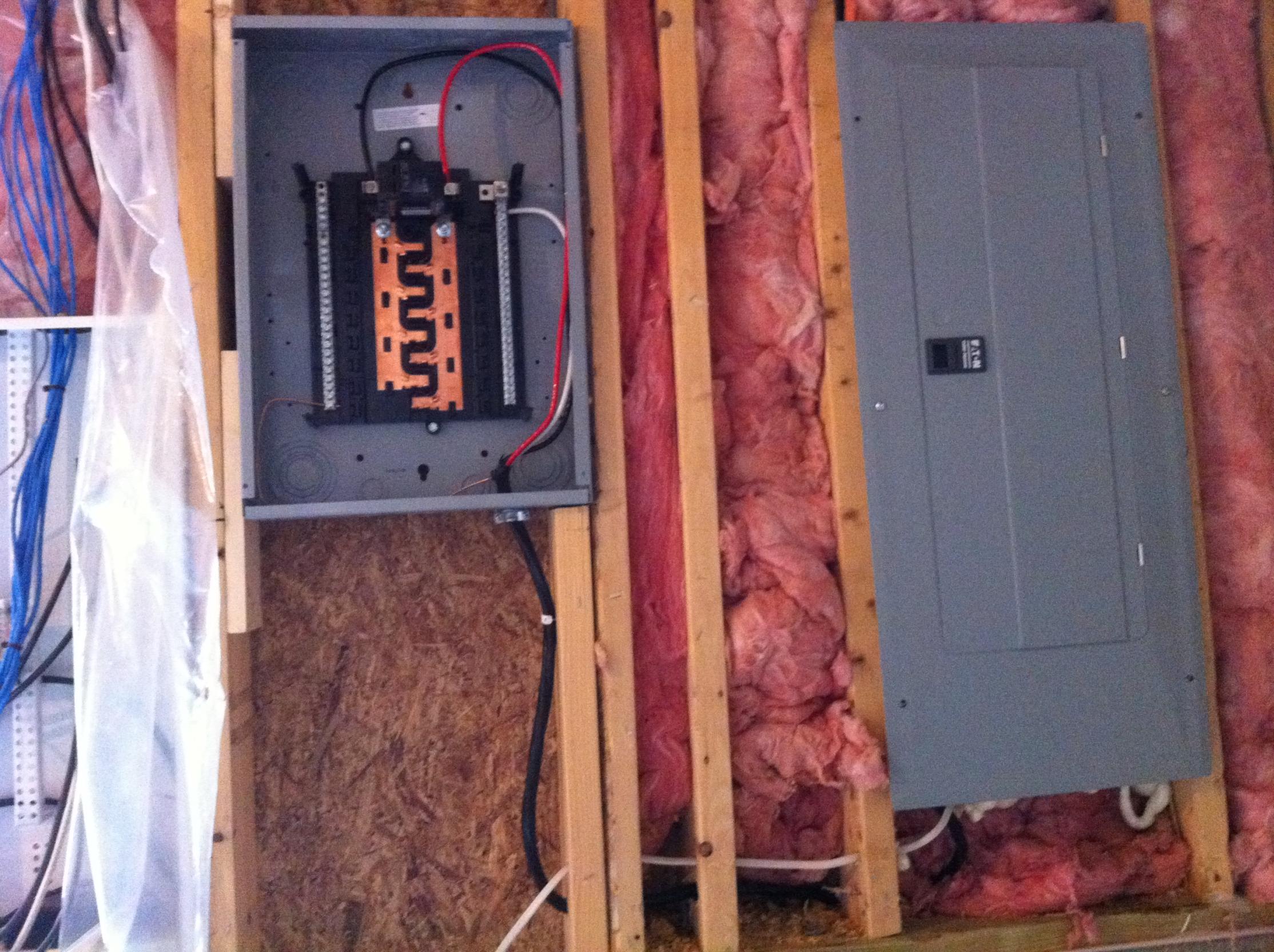

    Added breaker box-

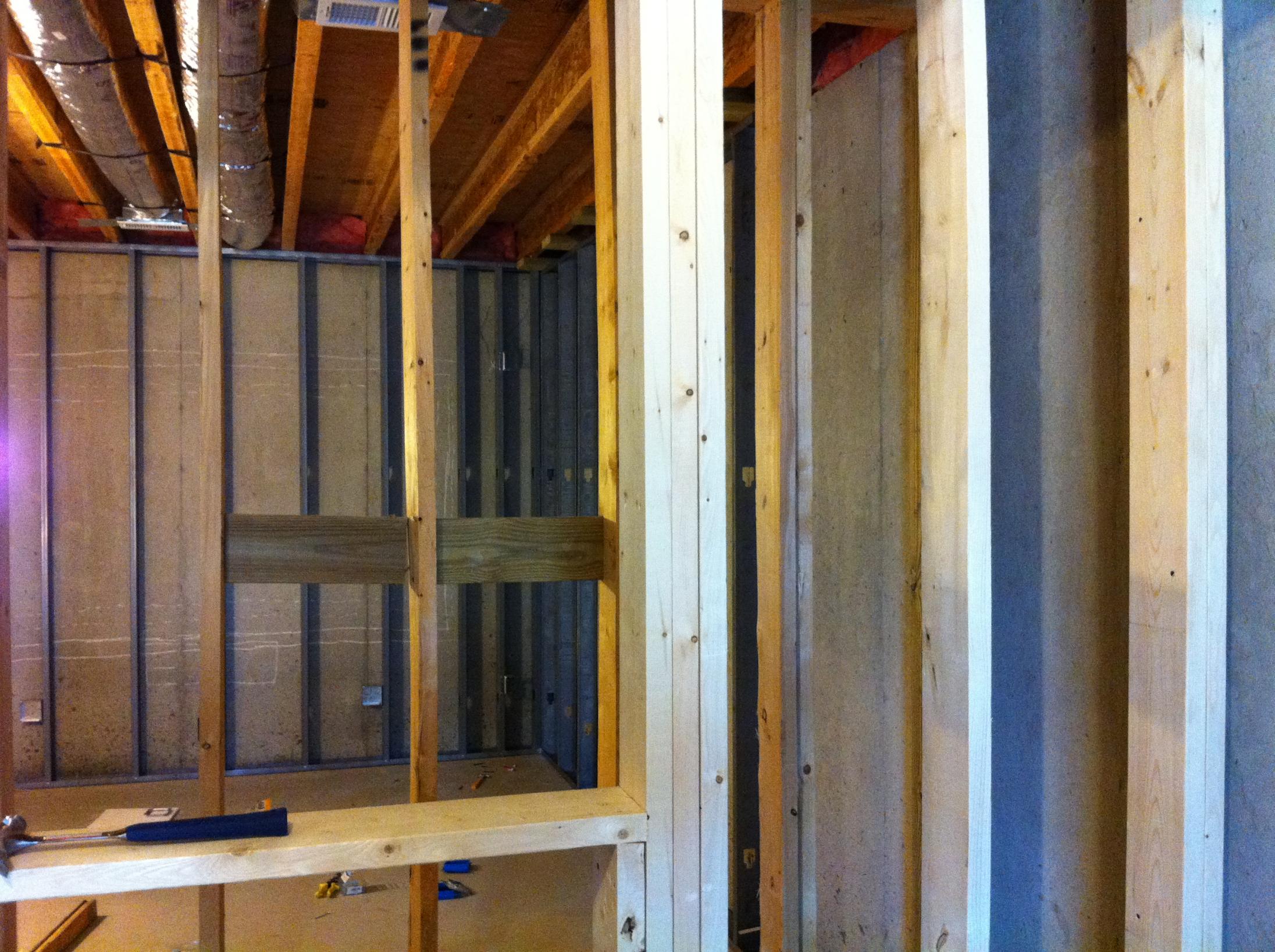

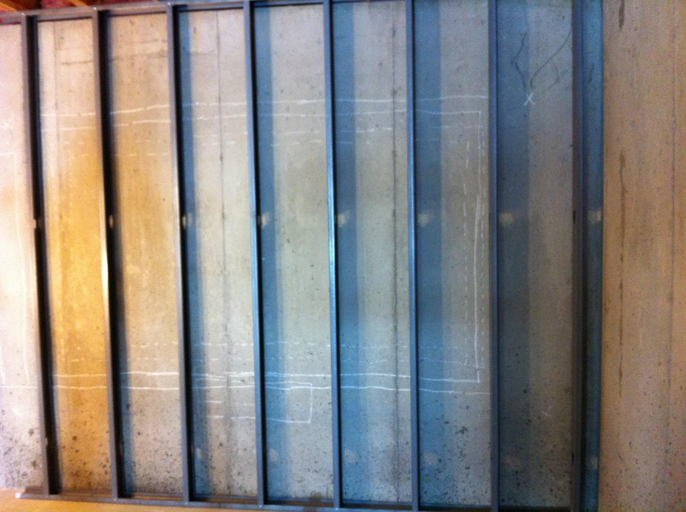

    Steel studs of screen wall in place-

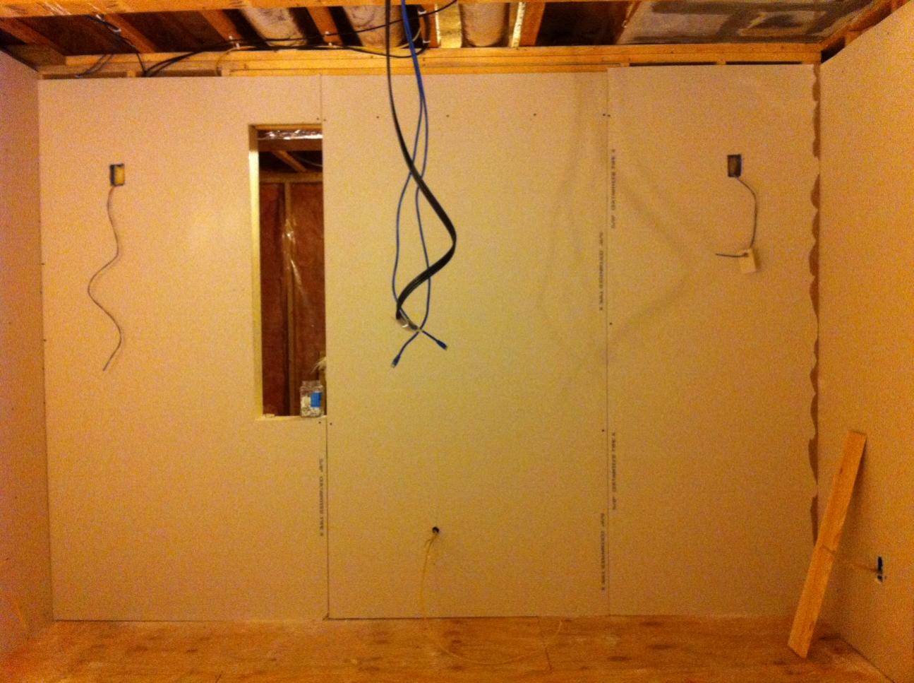

    New back wall up before other is taken down-

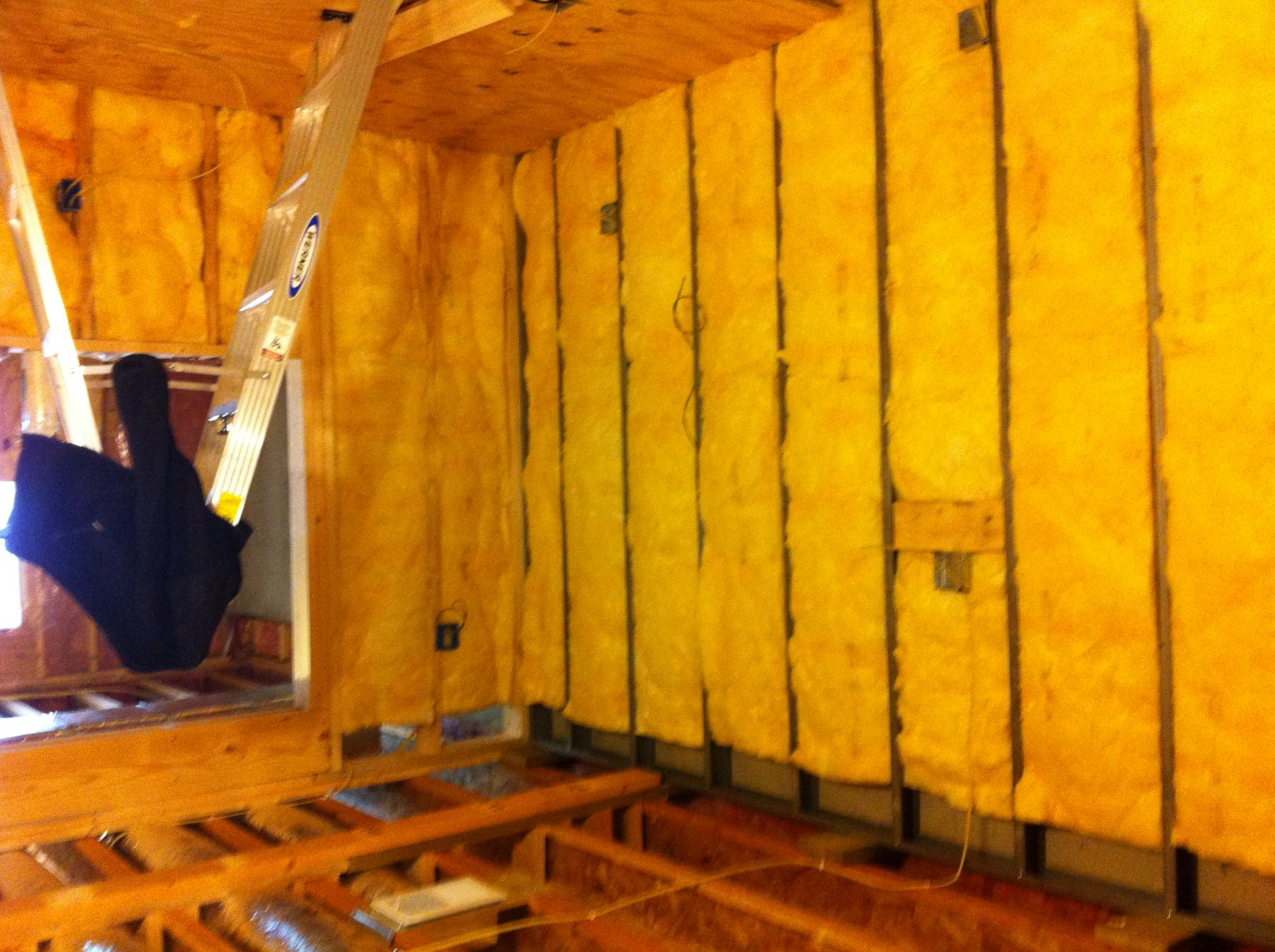

    After the first weekend of work- stage for back seats
    Insulation in place (R19)
    Back view of the drywall-

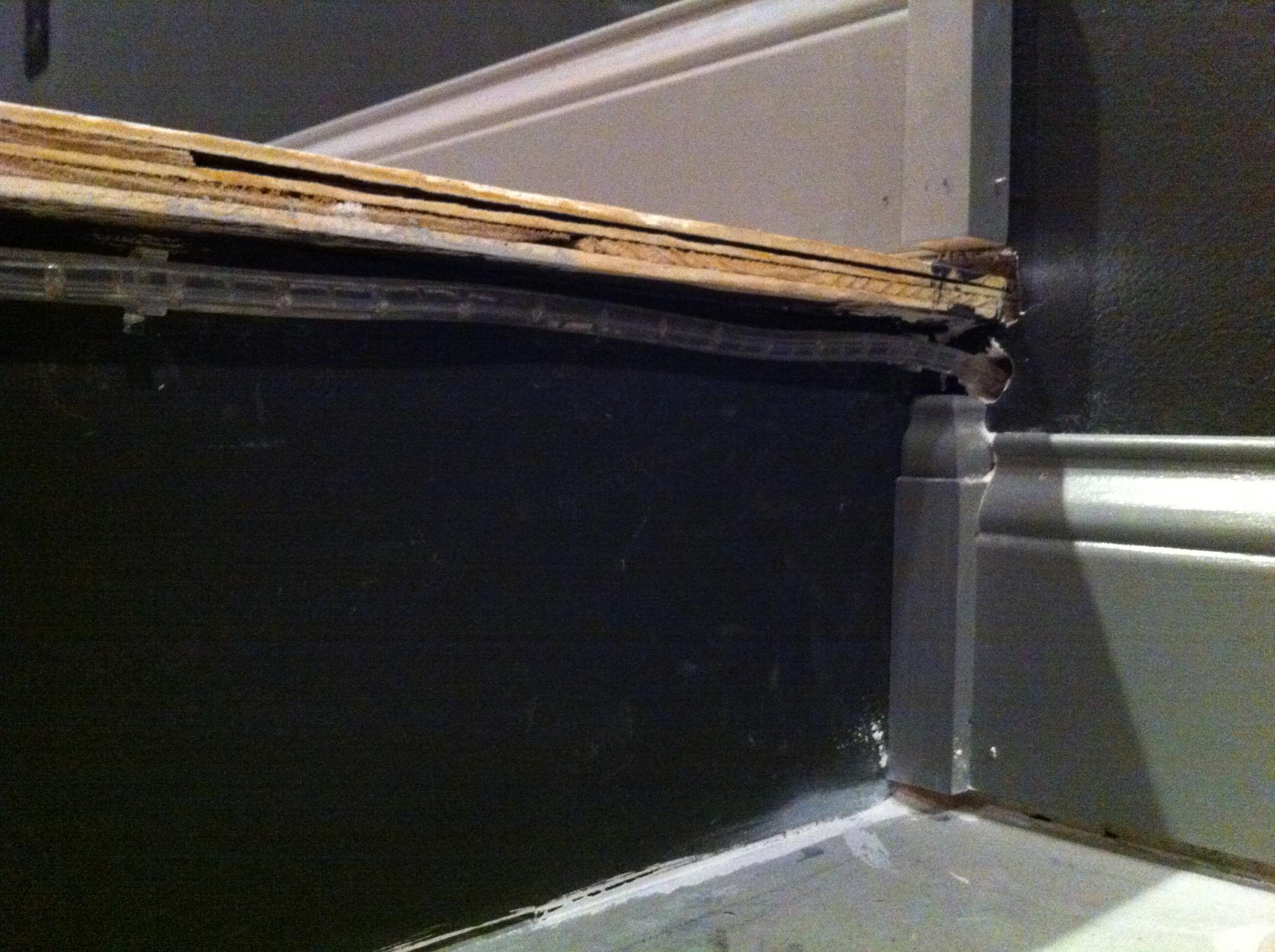

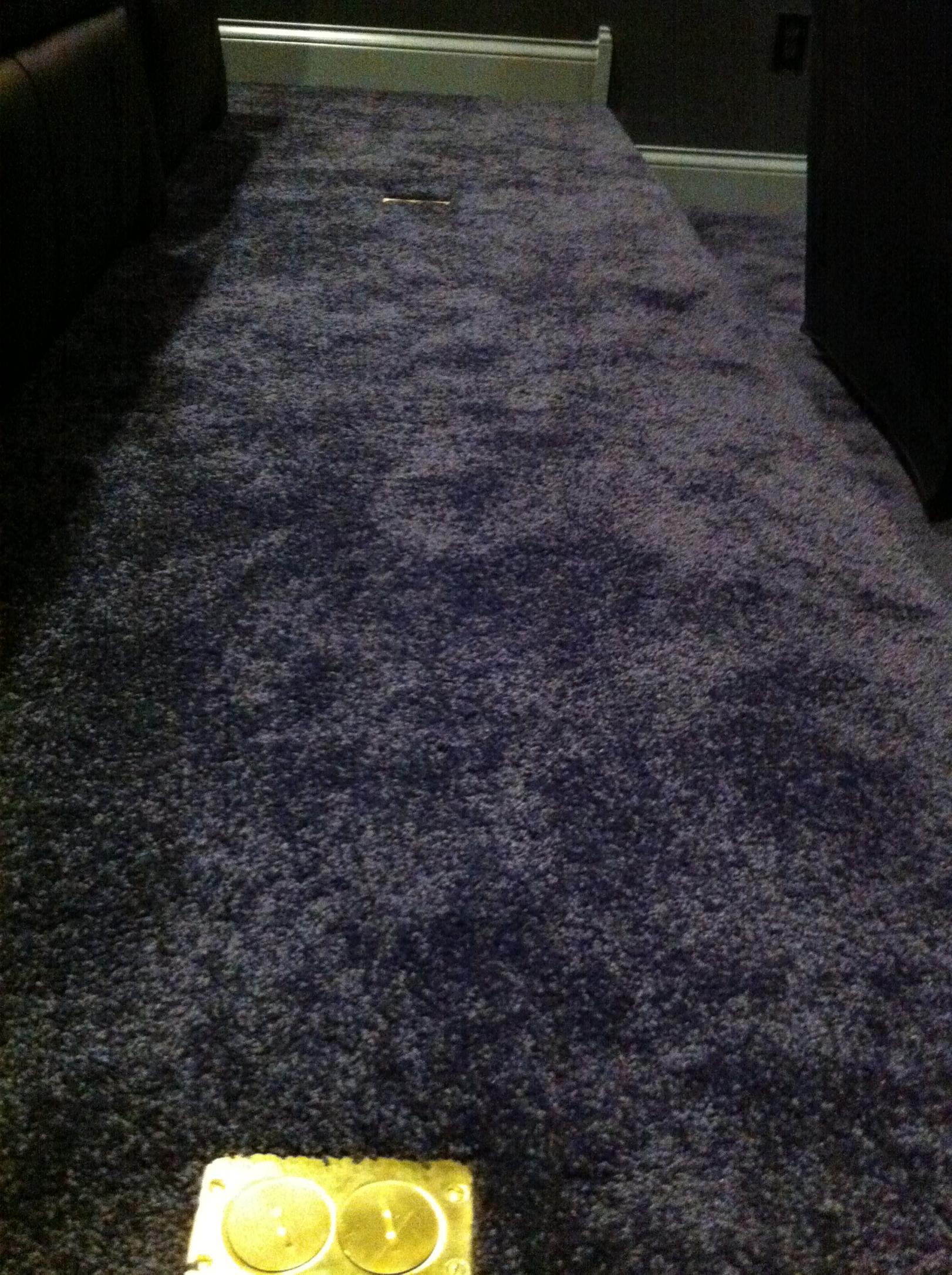

    Trim painted and a nice view of the trim under the stage. Carpet on the stage with 2 elictric outlets to use-

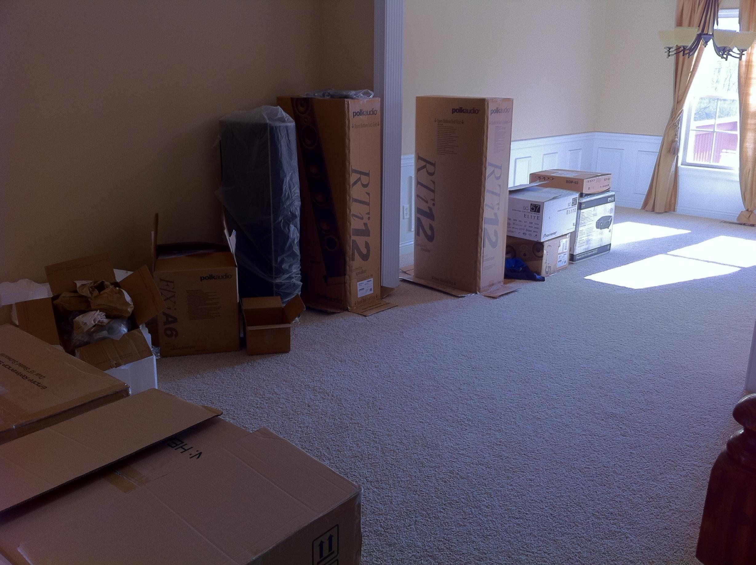

    Living room of my new house...some may say get furniture first...but I like to get the most important things out of the way! haha..

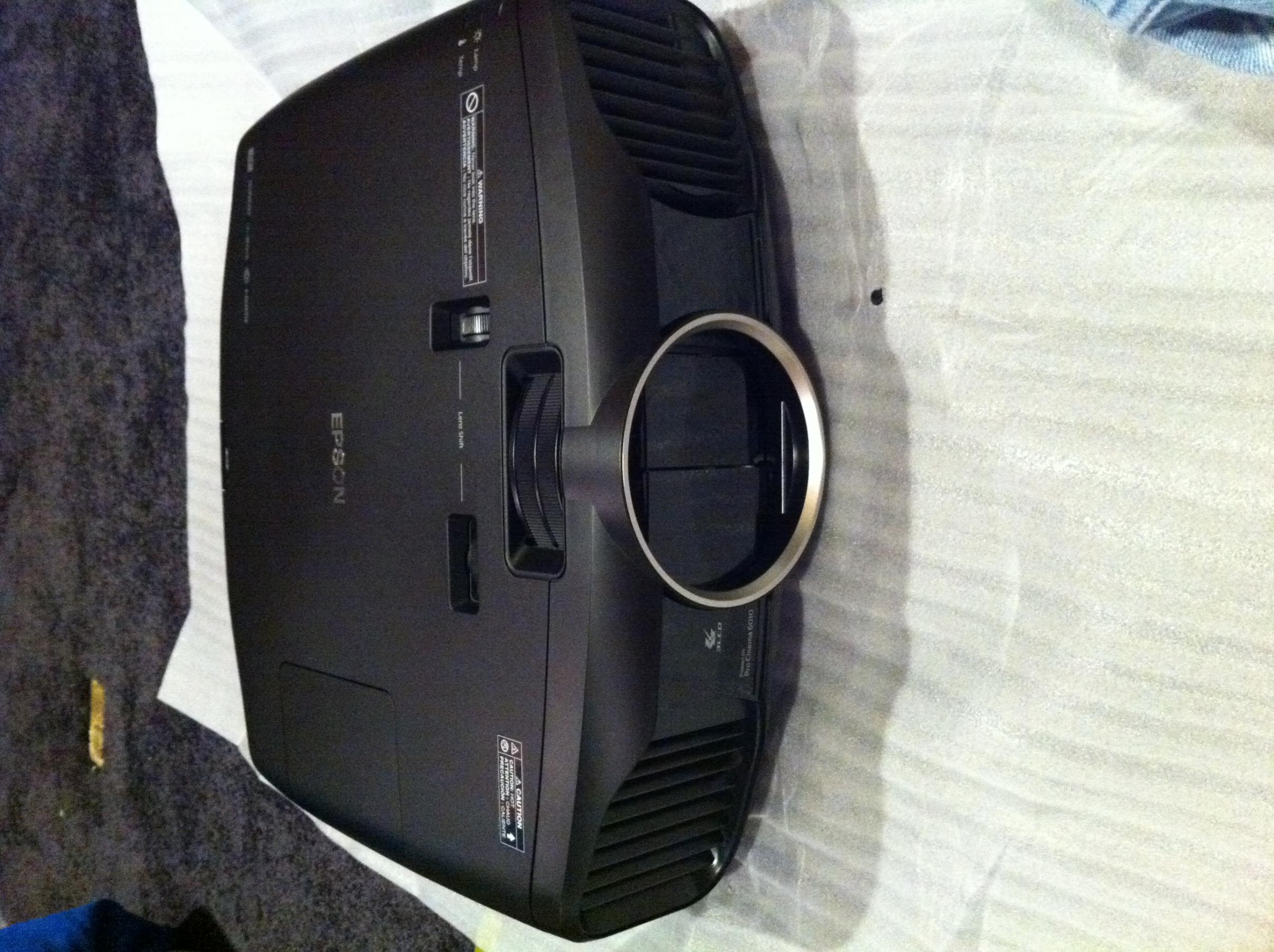

    Make anyone smile any day of the week seeing these 3 boxes...
    Epson 6010!

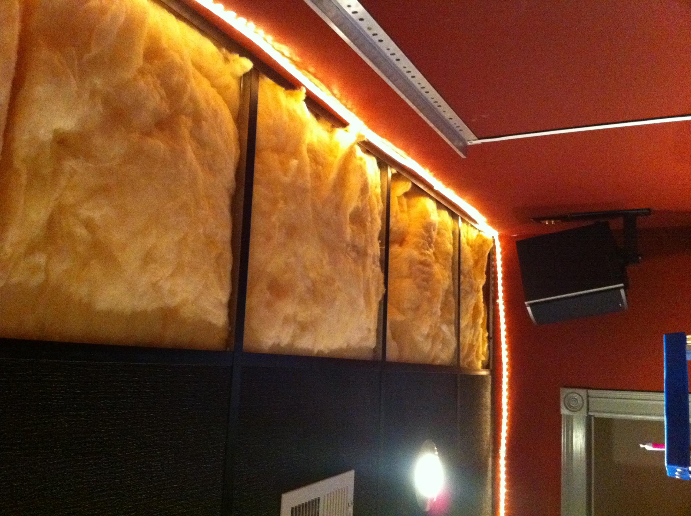

    R30 insulation over ceiling and sound dampening ceiling tiles-

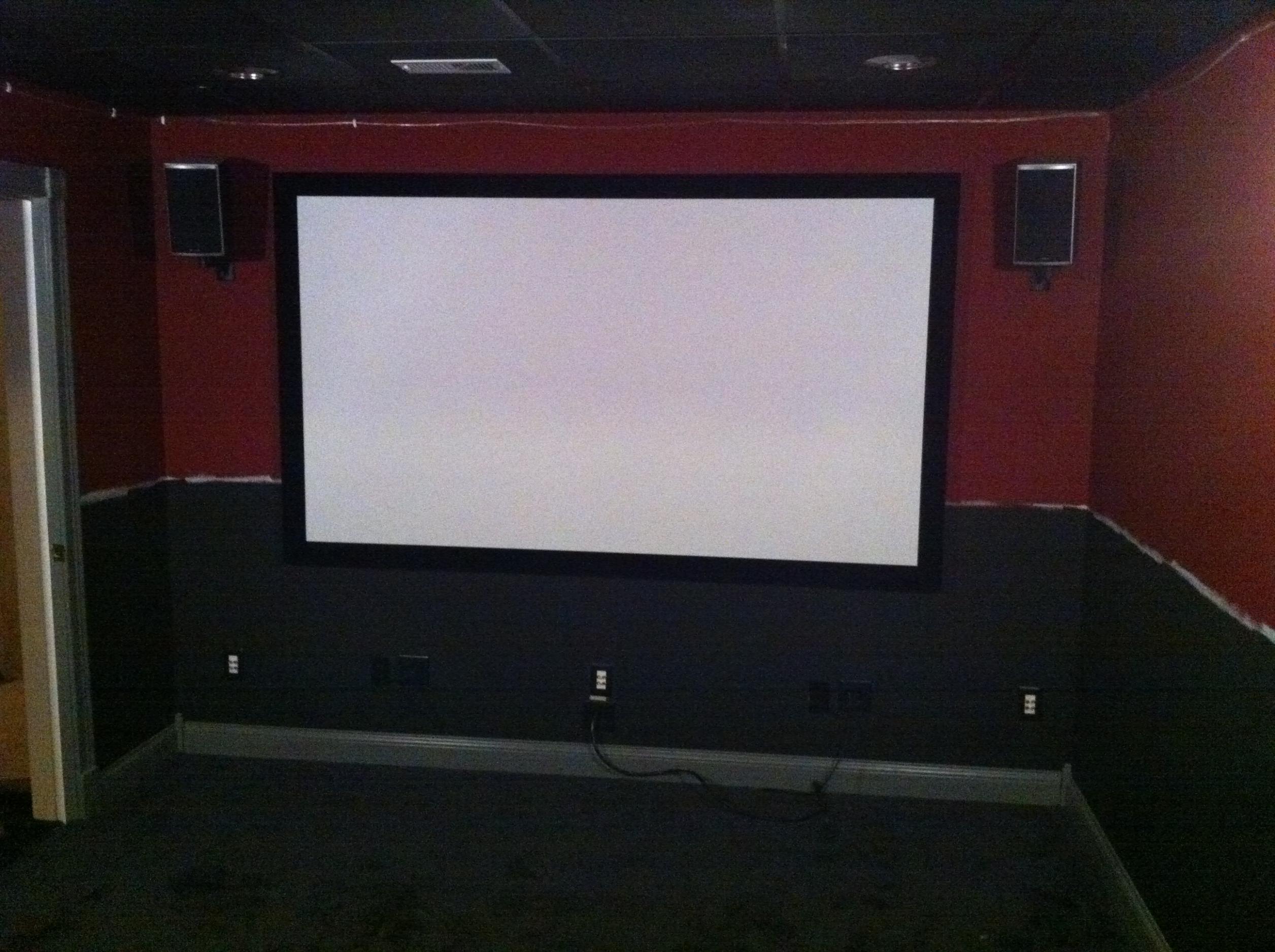

    after screen was up and front heights in place (pinpoint am40 mounts)

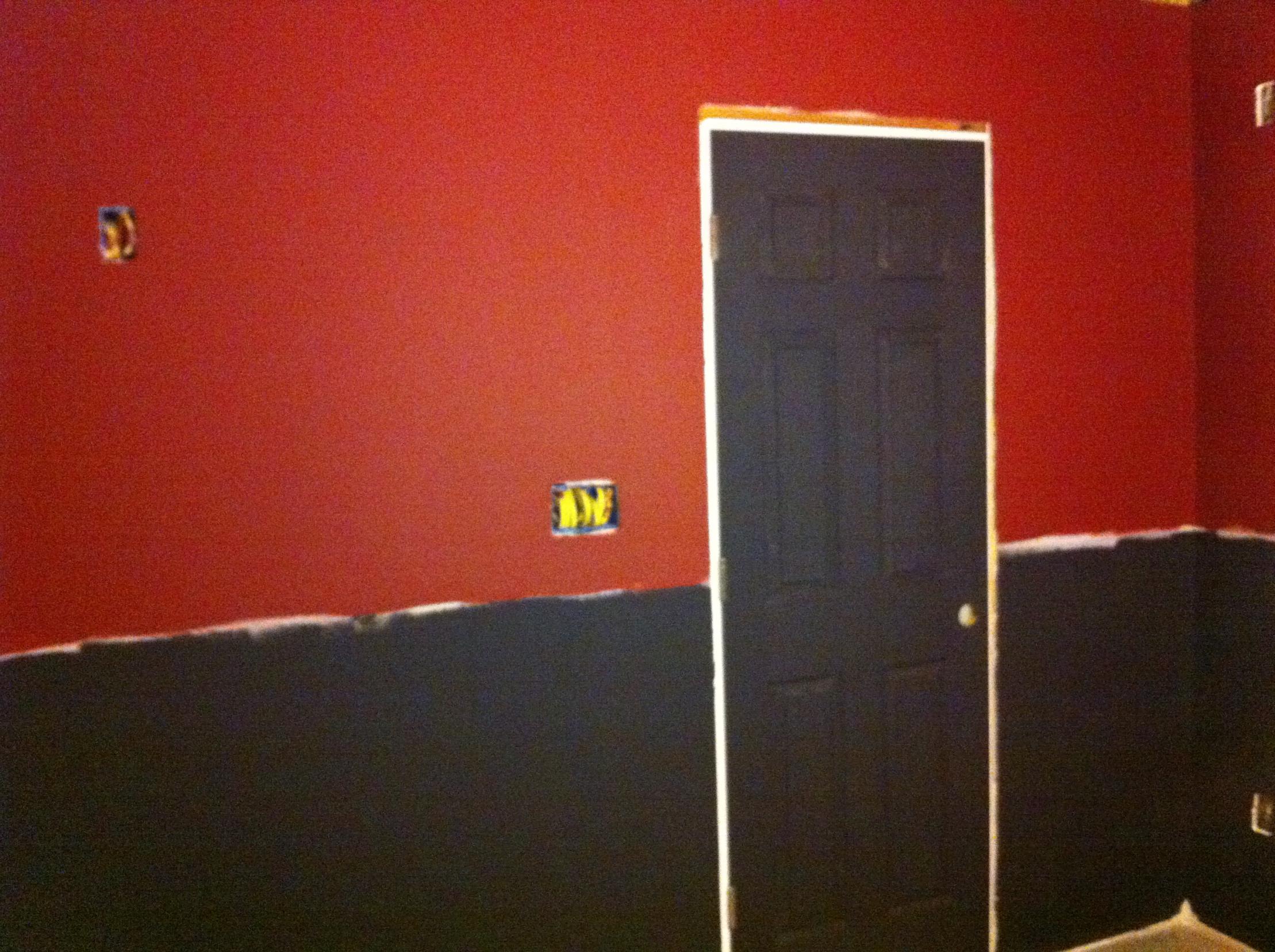

    Door up and in place-
    trim up around door

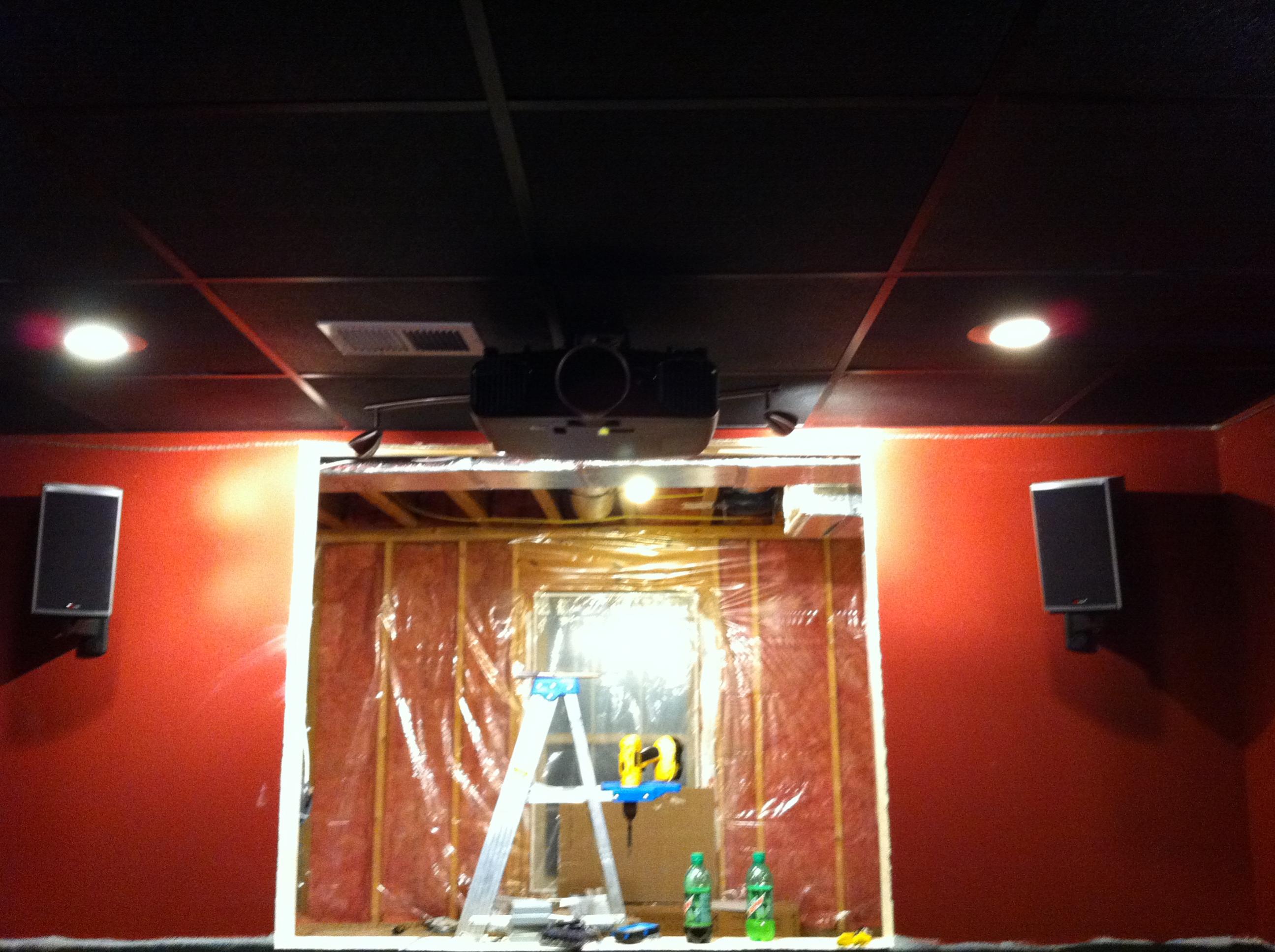

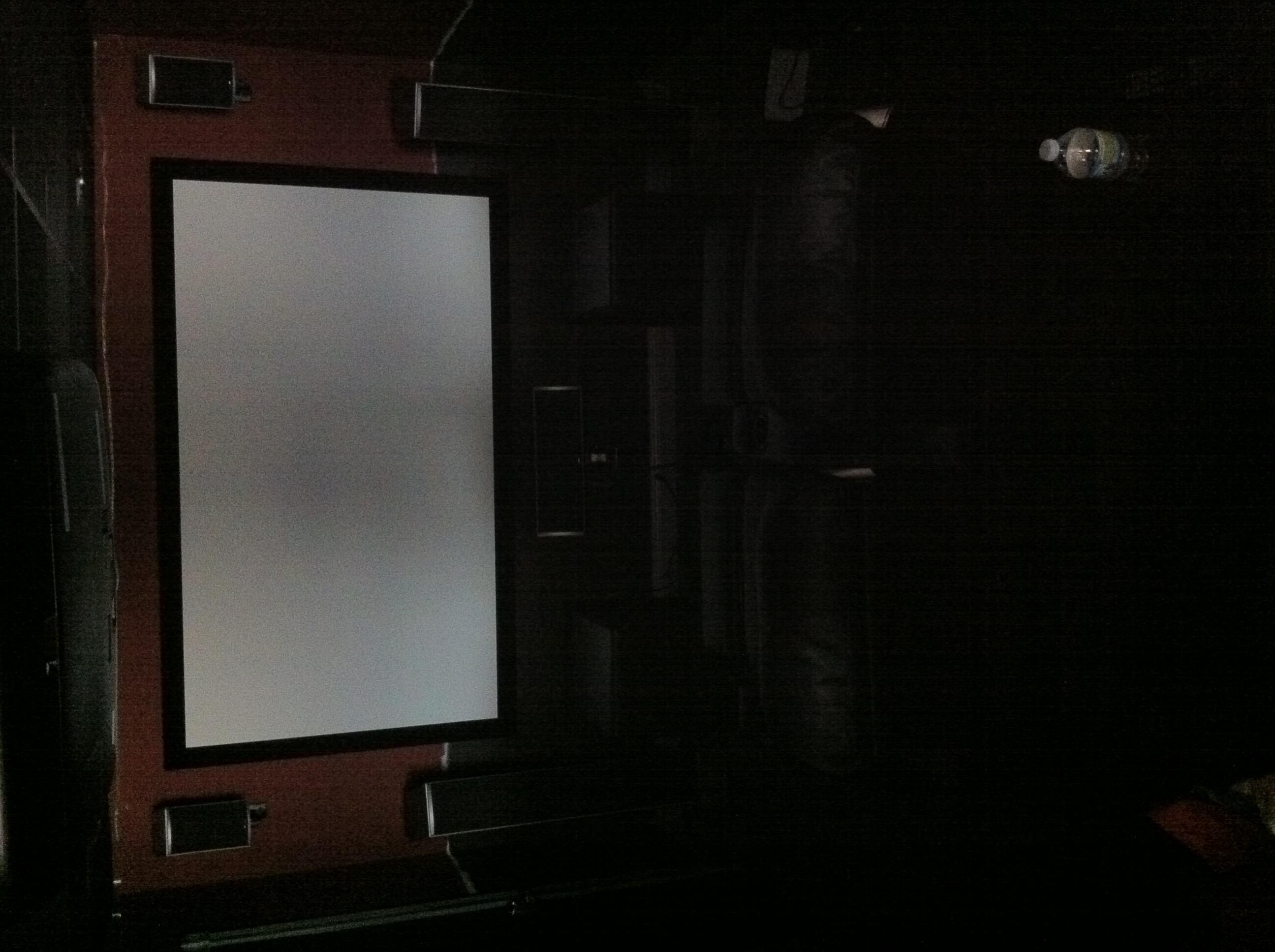

    screen with all speakers in place

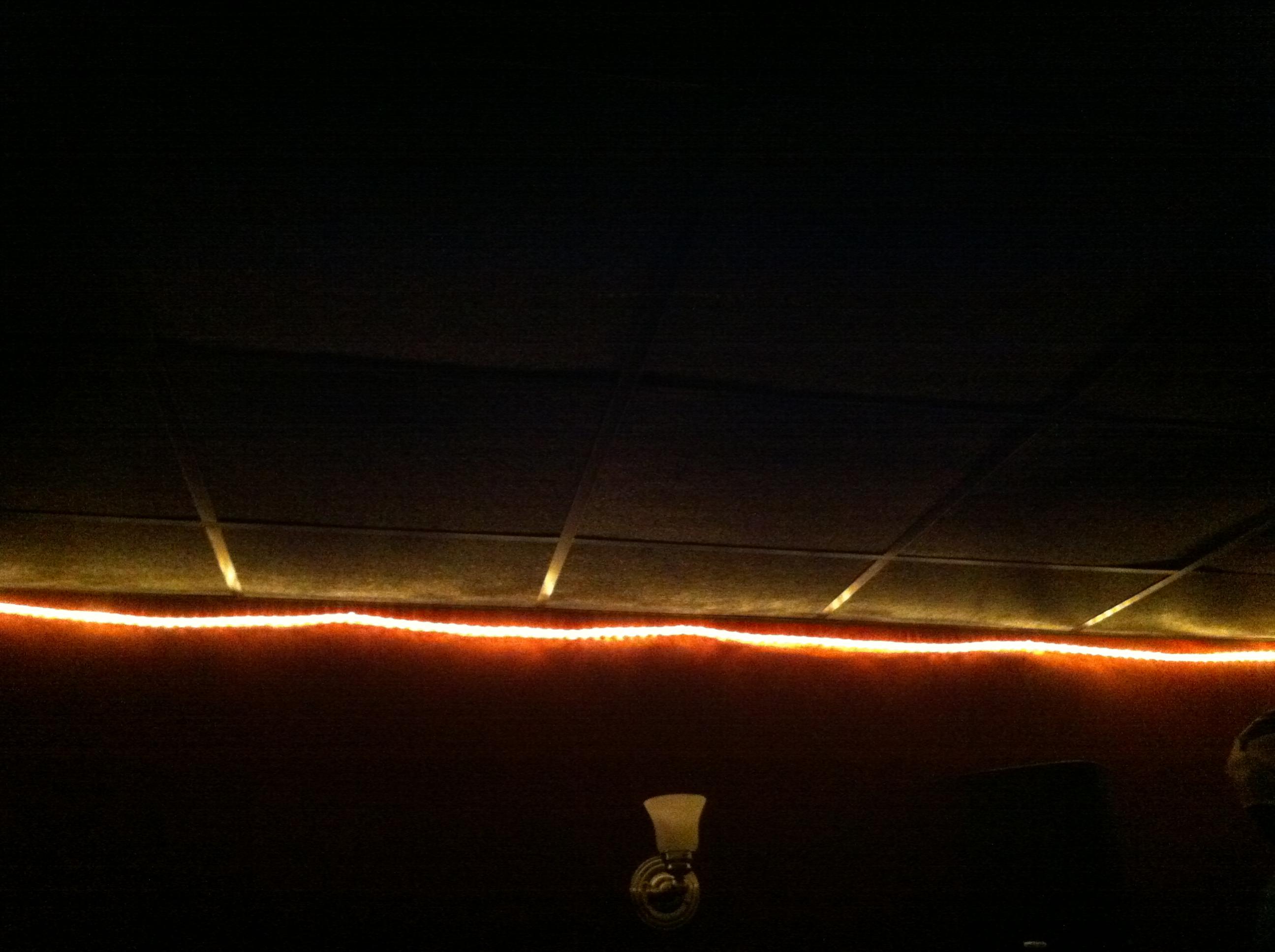

    mood lights up and can see sconces. will be putting up crown molding to hide the rope lights

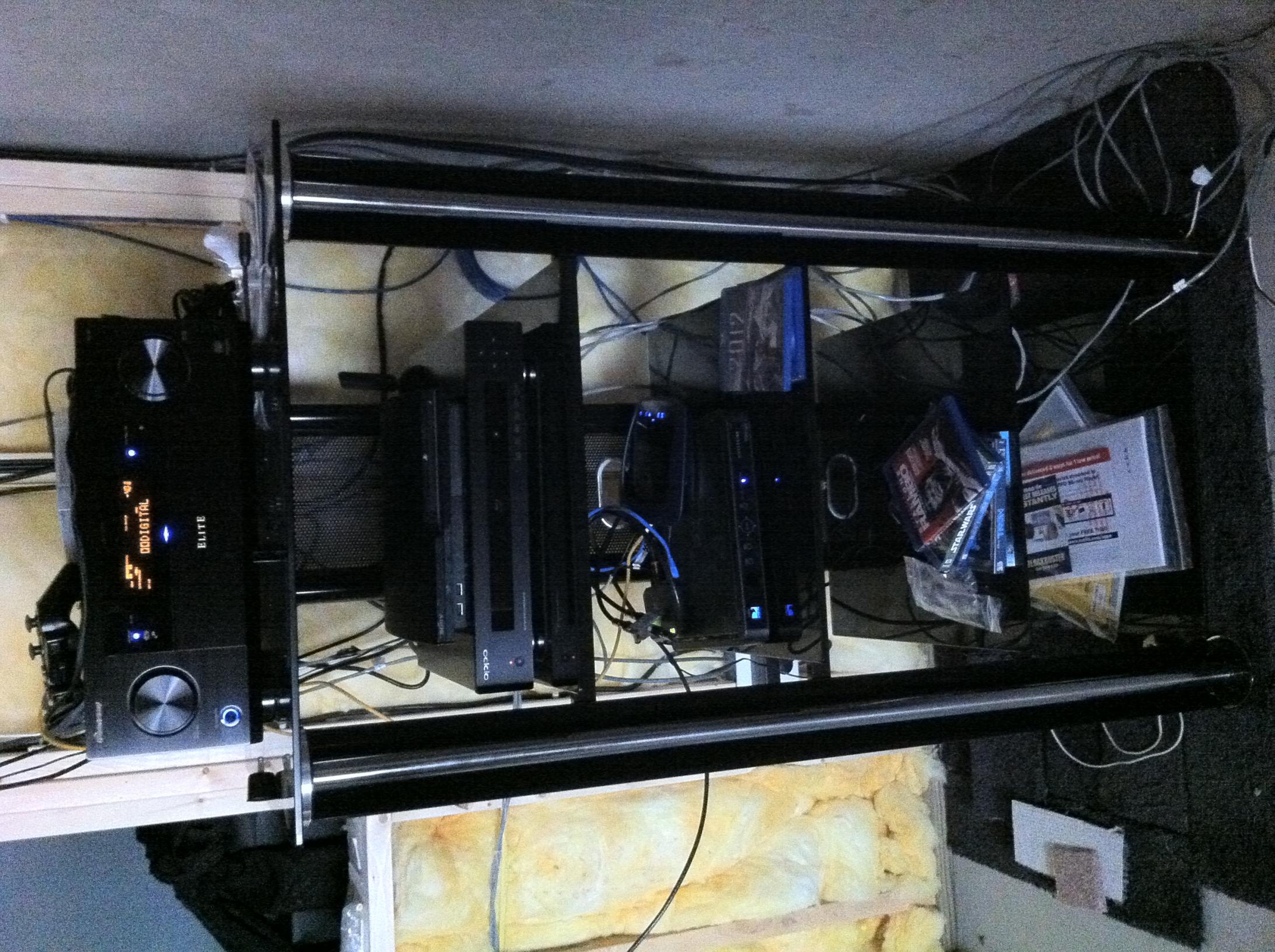

    equipment rack with my other goodies- I will be boxing in the hole seen to the left and making it an in wall shelf for blurays and Oppo-93-

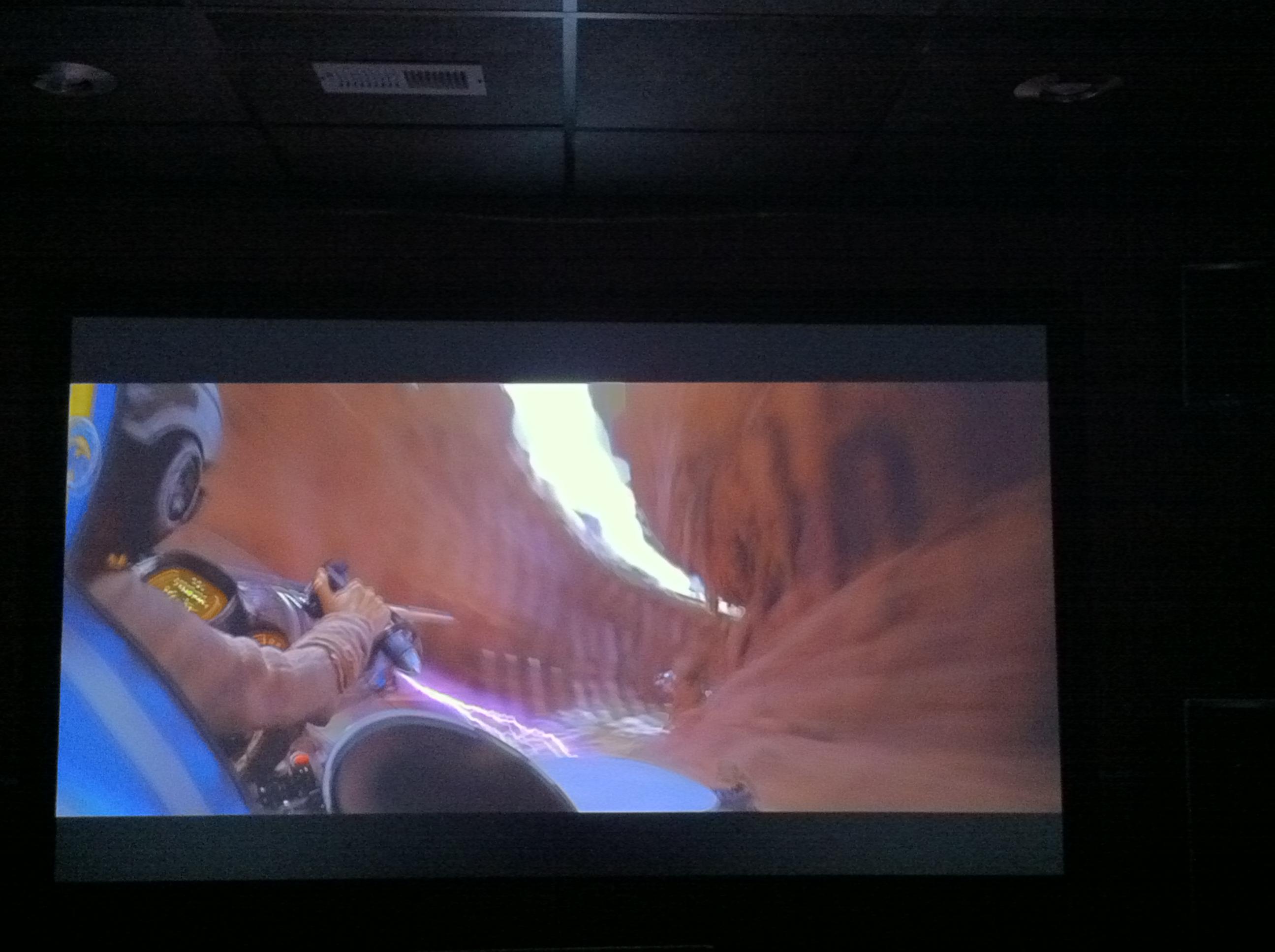

    Star Wars and up and running!

    Have a total of 4 cans and 1 track light, 2 sconces, and 2 rope lights in the room. Each set is controlled by a lutron URC RF dimmer switch (3 total) and a URC MX-880 remote.
    Still need to put up the chairrail and finish the back cabinet and put the trim around it. I also still need to put up the crown molding.

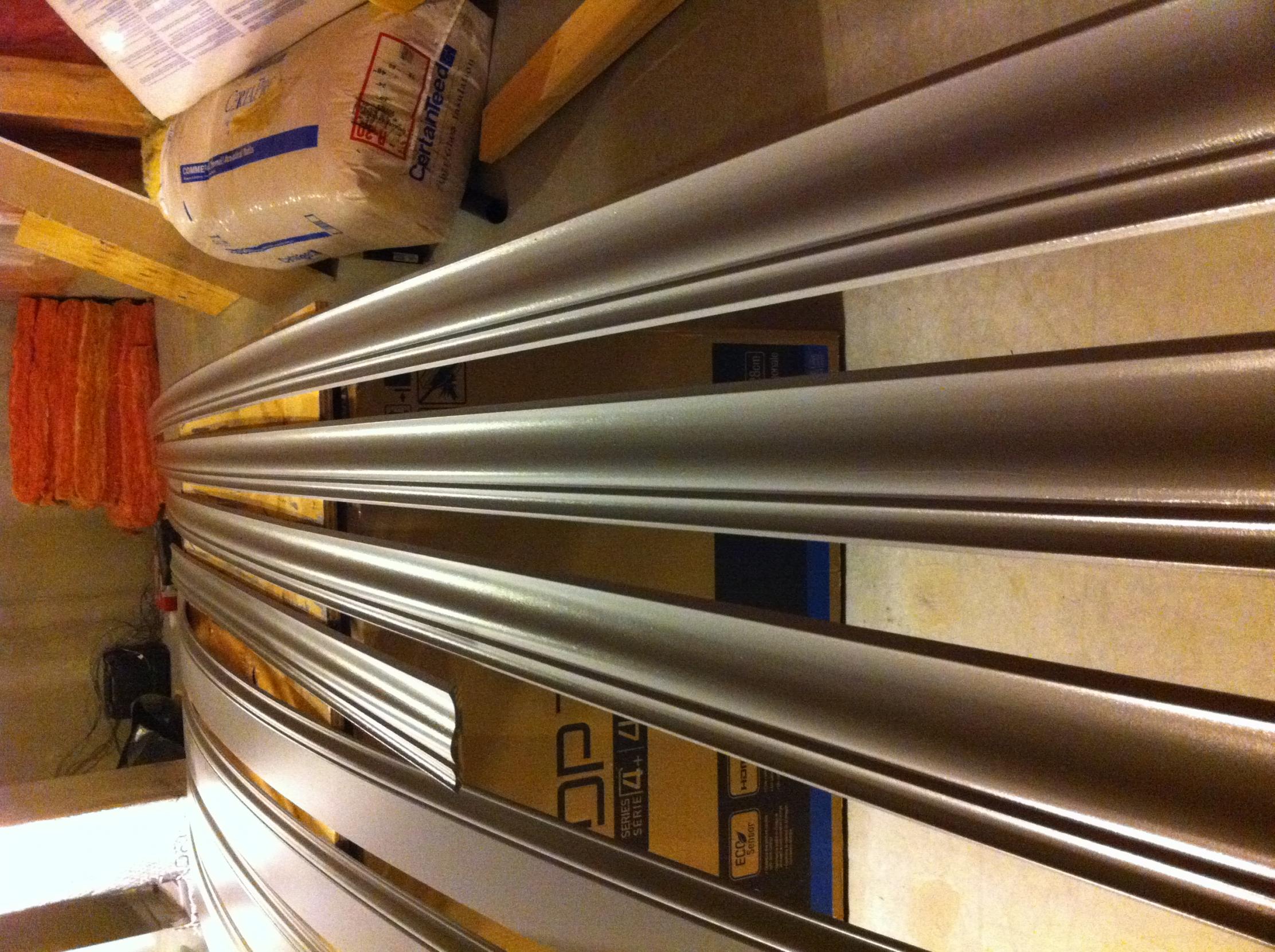

    8. Putting trim up.
