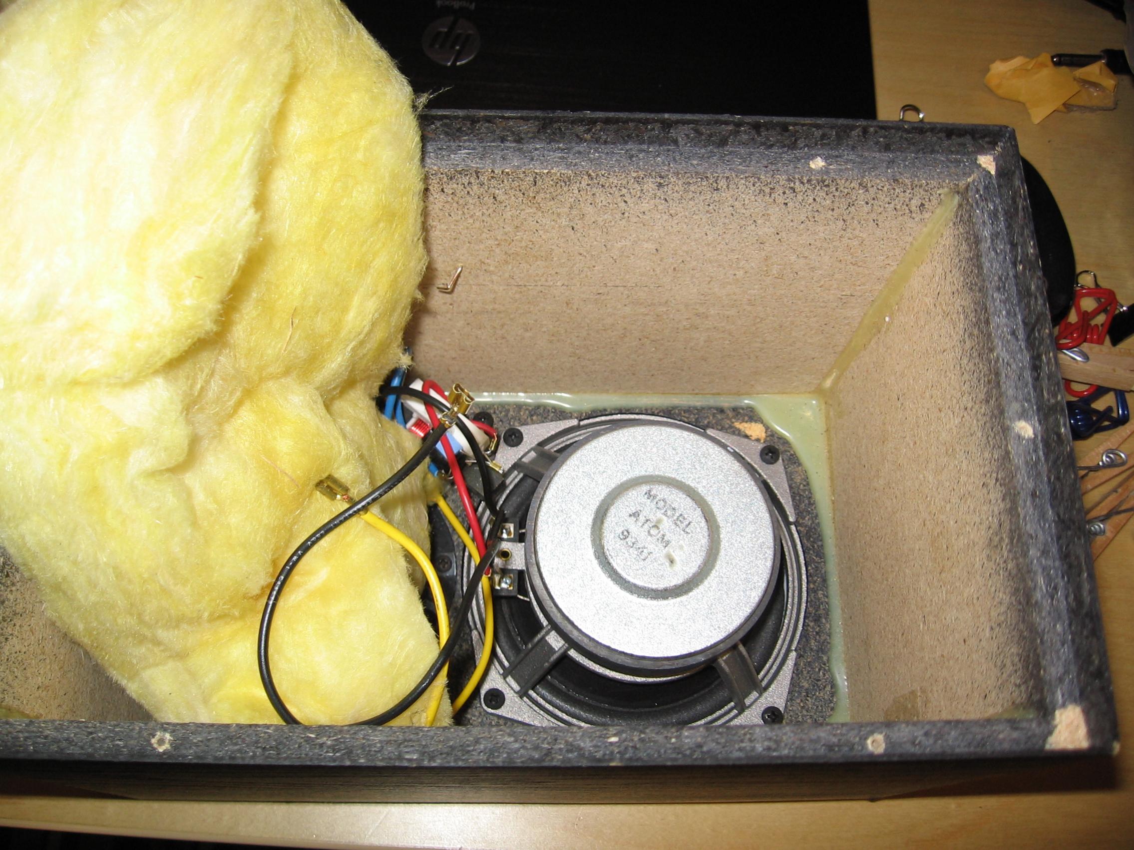

Bought the atoms and they were in pretty good shape. I had read that a lot of people had rotting surrounds. Being curious I opened up the back (grills are not removable) and took a woofer out. Looked fine. I touched it, it ripped and crumbled.

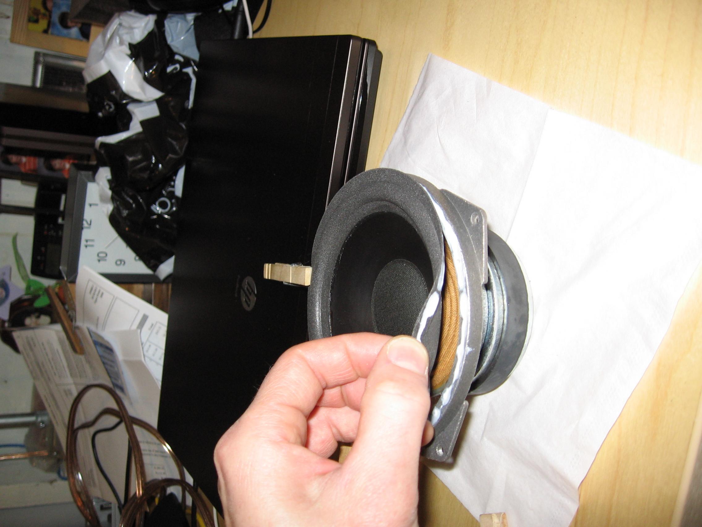

Well a little research and $20 later I had a refoam kit in hand. It went pretty well. I took off the old surrounds, cleaned everything up with rubbing alcohol. Glued the new foam to the woofer and then glued the surround to the basket while I played a 30hz test tone to keep everything centered.

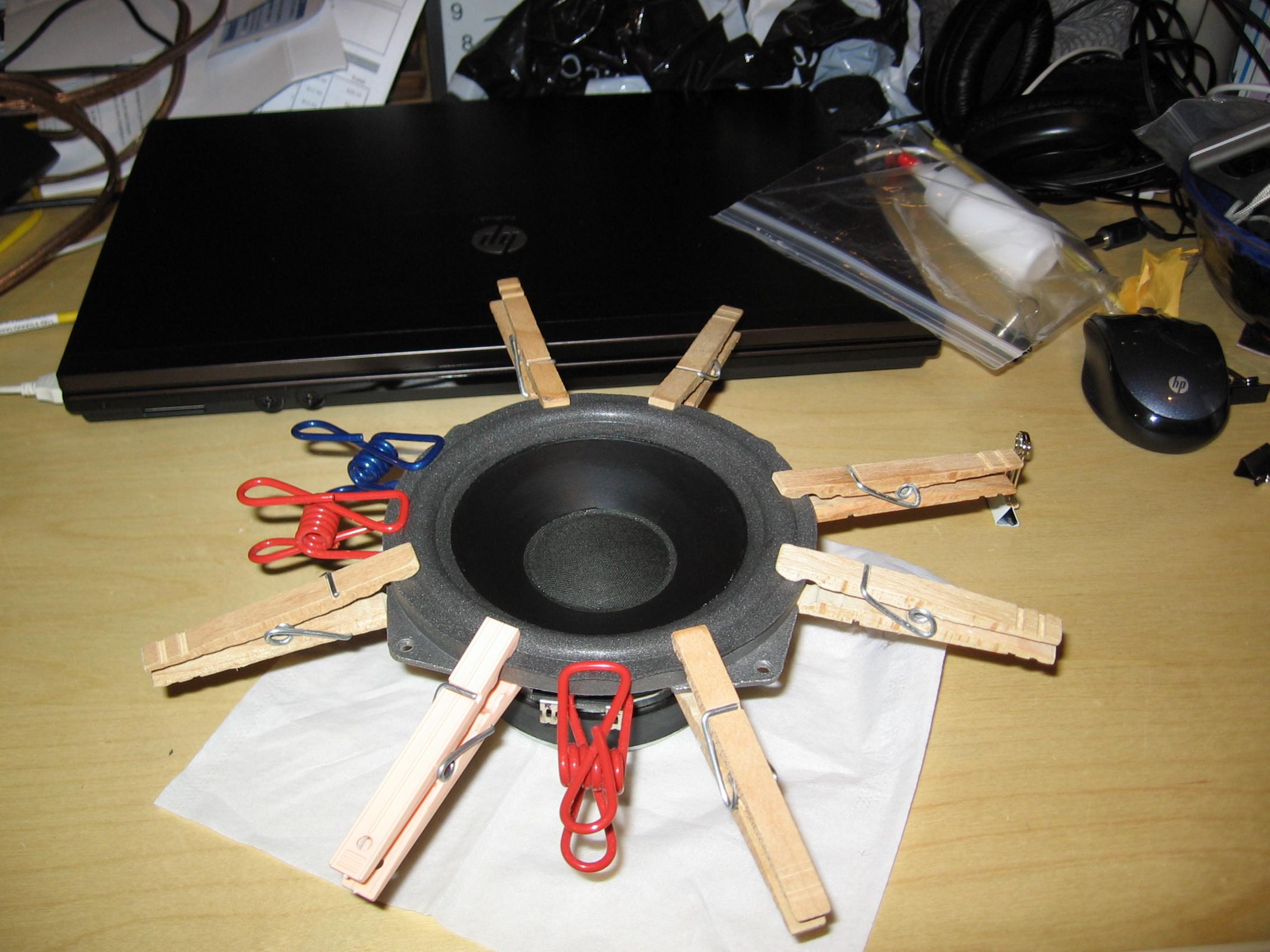

The first one didn't come off perfectly. When I got everything back together had a lot of woofer vibration noise. I could only diagnose this to an incorrectly centered woofer. So I used a wet paper towel, soaked the glue off and tried again. This time I played a bass sweep instead of a single tone to better listen for problems. Bingo, all good this time. Woofer number two went fine.

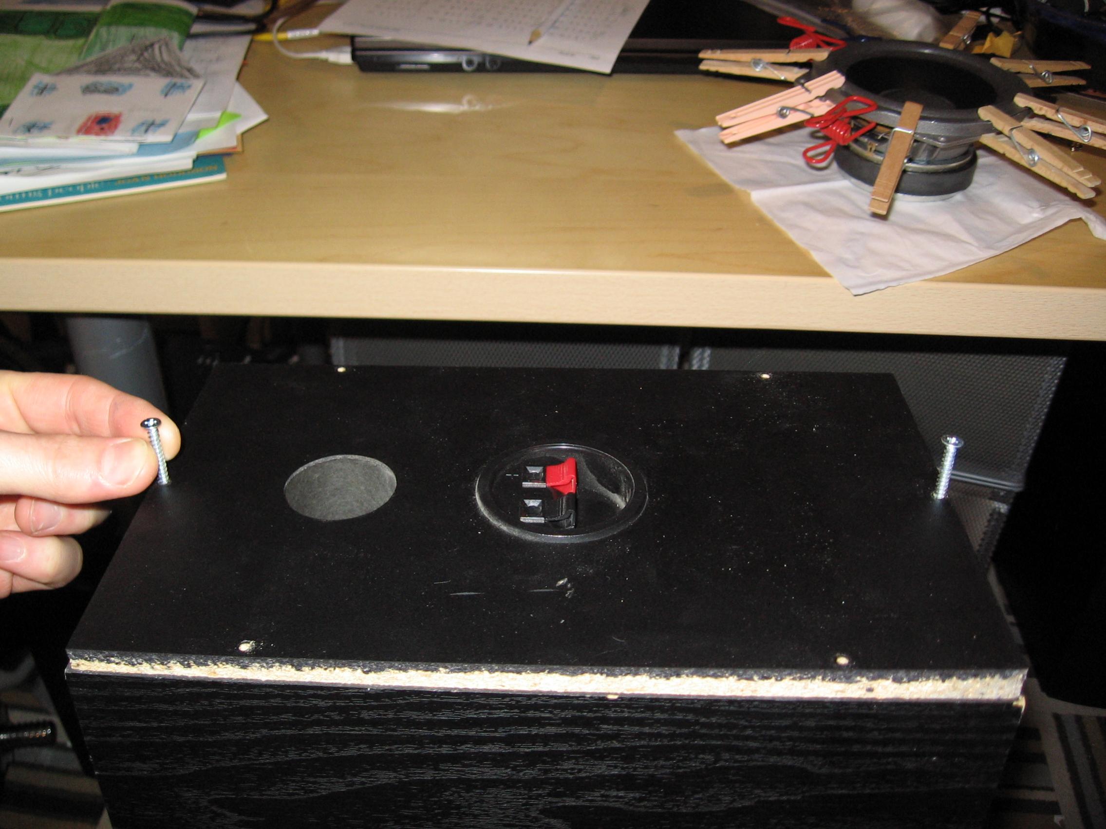

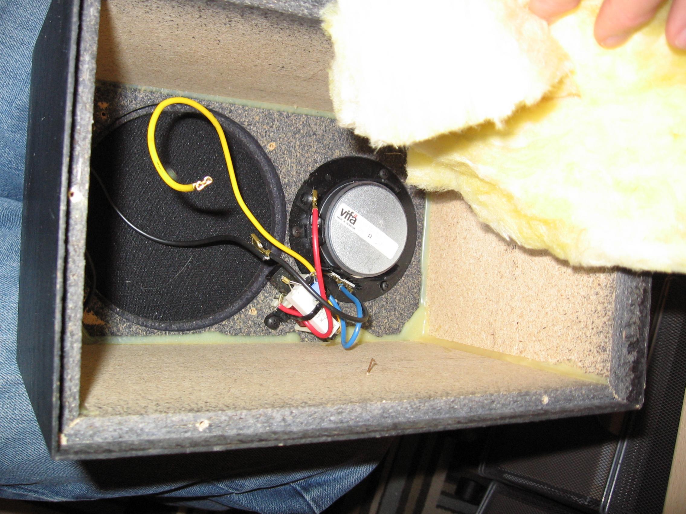

So then I go and pick up some Rt25i's which get damaged in shipping. UPS dropped the box so hard that the magnet from both the tweeter and woofer separated on one of the speakers. So I'm stipping that one apart and I have to say that the inside of the 25i is impressive compared to the atom to say the least. Much stronger construction. I was mining the box to salvage anything I could and just to explore. (I'll be putting the crossover up for sale in case someone needs one).
Here were some noteworthy tidbits (some might be obvious, but I hadn't really noticed before).
Front and back baffles are plastic
Nice strong inner baffle that partially separates woofer from tweeter area
magnet assembly on rt25i woofer is pretty beefy.

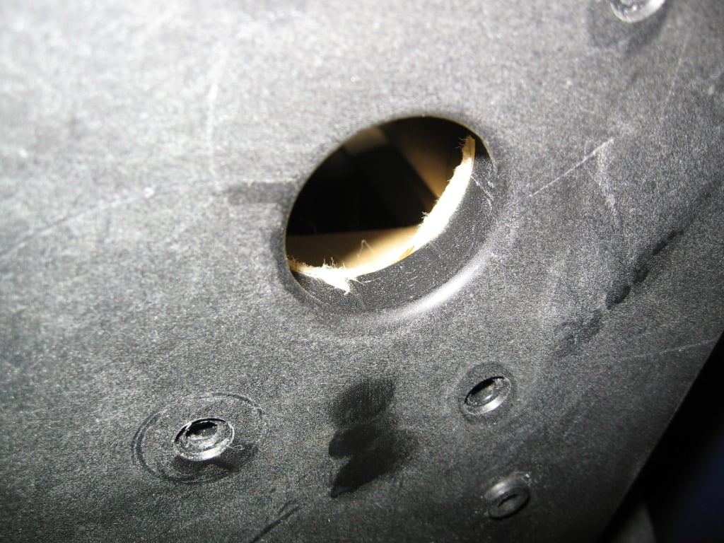

There are actually three ports on the 25i, the big one in back and then the two smaller ones that face forward (those are the anti-resonance ones or whatever they're called).
The powerport is actually screwed onto the back, I always pictured it as one molded piece, but if you look closer, it's obvious that it is two pieces.
Feeling that little cone on the powerport, I always imaging this fully smooth exit of air from the port with all this aerodynamic modeling behind it. When I took the powerport off, there is actually an edge of 1/16 to 1/8 of an inch between the port and the back baffle. Seems weird that this wouldn't be smooth.
It's little hard to see the edge, you can kind of pick it up along the left side in the second picture. -
I thought it might be cool to save the powerport and give it to someone that has a chipped or damaged one, but I'm not sure there's any room to remove it without the port tube getting damaged (I just ripped this one off as you can see in the hanging cardboard).

In post number two, notice the deformation of the foam under the red clip. This is where I went wrong on the first try. I think some of those clips pulled the woofer out of place while it was drying. On the second try, I only used weights to hold the foam down instead of clips so it would stay centered.
