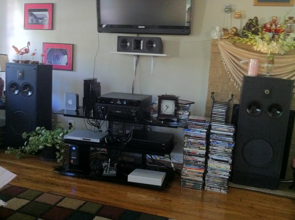

    i have the same speakers i used for my main front. i thought those were SDA 2As.
    i love listening to them eventhough i dont have the interconnect cable. how can i make one or can i order them at polks?
    i am not an electrician and dont know how to upgrade my speakers. i guess i'll just have to find an electrician to do it. how much would it cost for the upgrade? i dont know where to start but i really wanted to experience SDAs quality sound. they said these speakers are much better then the RTiA9. thanks for any suggestions.
    im bidding at ebay for a carver M-1.0t amp to drive them.

    Is it a blade/blade IC cable you need? If so call polk they will have one made for you..

    its a pin/blade IC cable.
