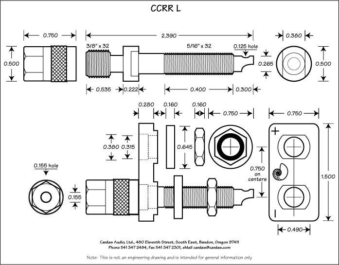

Okay, I've searched and searched. I'm looking for single binding posts, Cardas, to replace my SDA interconnect post so I can start using better cable. I want to leave the original speaker binding posts intact for now. I've looked over at Soniccraft and diycable.com and can't find single binding posts. Am I missing something here?

    Dude, I love you man. You unscrew the binding post from the little black bar it's connected too and there you have it single binding posts.

    Haha, I guess I was missing something.
    What confused me where those little black plates that the binding posts are attached to. I assumed someone sold single posts with those plates but by the looks of this pic that I found this morning, I was wrong.

    You may have to mod the holes in the terminal cups to get the posts to fit.I had to drill them out a little to get the eichmann cable pods I used to fit.
    I do know that vampire makes some that fit.Doro knows which vampires are a drop in replacement.
    I see your not going to replace the speaker binding posts..........My bad....You may still have to mod the IC post hole though.

    I just ordered the Cardas CCGR-S. Does anyone know if these drop in without modification?

    You may have to bore the holes out slightly, not difficult with the proper sized drill bit.
