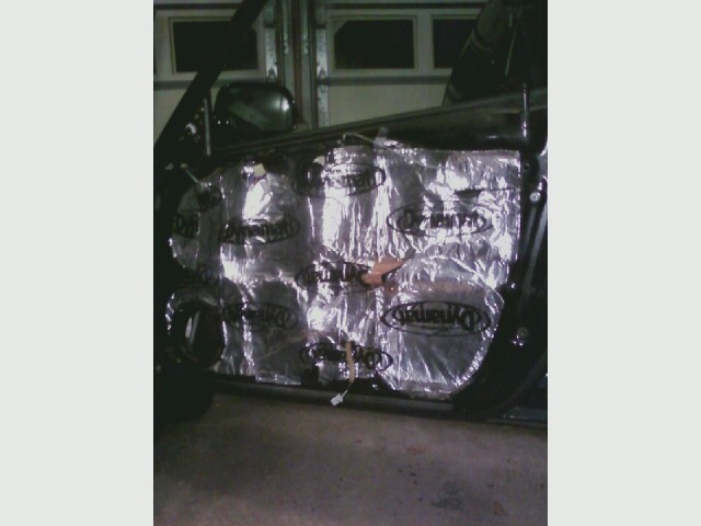

    Dynamat and yes its very important to seal your doors with the dynamat . This will give you a good bump in your mid bass end and prevent it from sounding thin and tinny.

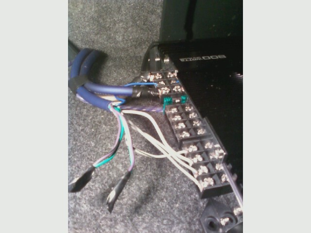

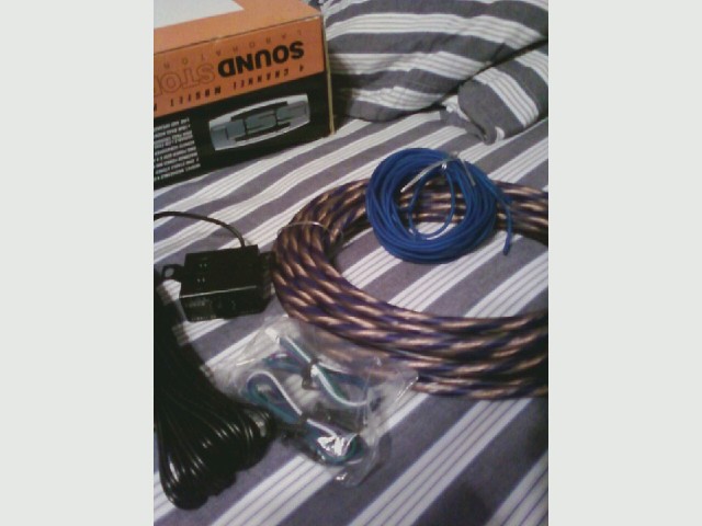

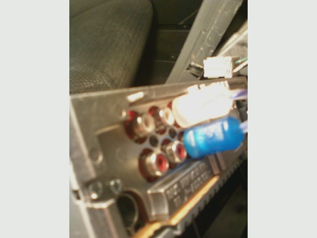

    Alright here comes a couple more questions. Today I finally had my 4 channel Amp installed by best buy today. I purchased a power acoustics wiring kit and a 4 channel sound storm amp and brought it to them. They wired it so that the first 2 channels are the front and back speakers to my car, and (my subwoofer was supposed to arrive 2 days ago but UPS lost the package, fml) I can put the subwoofer in later. Ok so heres the questions
    #1: For some reason after they have installed the amp, I have to turn the volume up a lot more on my HU. I used to keep it around 20, and then 22-25 was when you hear a song you like. Now when I hear a song i like i have to turn it up to about 40 just to get the same volume. Is that normal? My HU says its faded 4 to the left, maybe (because of the using only 2 channels in the amp) that means its faded to the front more and since my front speakers are the weaker sonys it isnt as loud?
    #2 I do NOT want to go back to best buy to install the subwoofer. They said all together everything would costs around $120, and today it cost $130 to get just the amp installed... soooo I want to steer away from that. I am not so great on the "know-how" of car audio. Easy speaker installations is about as complex as I get. Anyways, is it difficult to install a subwoofer? and also, do I need extra cables? The best buy guy said Id prolly need an extra RCA cable, but I want to double check and make sure.. It looks like I have one extra here from the kit, a bass controller, some smaller connectors and a smaller wire. I am posting a pic with this thread to show what I have left. If you know what I need or am missing please let me know. Also any instructions would be nice. They didnt give me back the instructions with my amp box :evil:
    #3. They installed the amplifier in the trunk of my car. Obviously my subwoofer needs to go there too. I have read that it is dangerous for your amplifier to be around your subwoofer because the vibrations can wreck the insides of the amp. The amp is as close to the back of the trunk as could be, and if I had to move it im sure I would have to undo and cut and reattach all the wires and stuff and I dont know if I could do it correctly. What is your opinion on that?
    #4 (and final, sorry about not knowin this stuff even though its basic :cry:) Once I save up the money I want to get a sound deadener for my doors and I'm looking for cost efficiency on this too. I was going to try to buy dynamat on ebay when I find it cheap. I also saw that fat mat is extremely cheaper but was wondering about the quality of it...
    Oh and one more thing! the subwoofer I got was a 12'' subwoofer and I planned to just buy an enclosure off of ebay. does any 12'' enclosure work? you just get the enclosure, stick the sucker in and thats it?
    Thank you so much for all the help guys!

    Yeeaahh... Dont ever go to Best Buy for intalls, they over charge alot. If you can do it yourself, that is the best, and cheepest route. All you need to do is do research befor you start. For the sub, yes getting a premade box for the 12 is fine, and yes it is a simple as wire up sub, put into box, screw sub down, then plug in wires from sub to amp. Done. Make sure the box is screwed done so it does not move. As for wire left over, what you have should be fine for wiring the sub to the box terminal, and then from the box termianl(s) to amp, however you will need another RCA to get the signal from the head unit to the amp. As for moving the amp, you can leave it where it is. Your concern about the sub rattling the internal workings of the amp lose is valid, but (someone please correct me if I am wrong) as long as the amp is not screwed to the actual box you will be fine.
    Hope this helps, and I hope that there will other people that chime in as well. Always seems when I chime in everybody kind of shy's away. LOL, It's like I am infecting the thread with stupidy or something. I mean I am not as good as like Mac, or Arun, but I know a thing or two about a thing or two...LOL

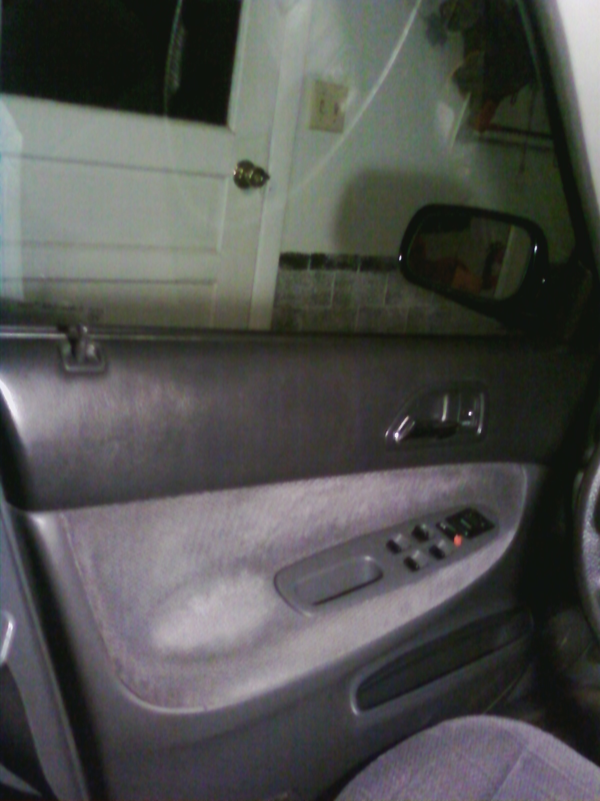

    Thanks a lot man, i appreciate the advice. I got a 12 SQ Ft pack of dynamat because I figured I would just try the front doors first and see how it went. Well, I must have bad like or something with this stuff cause it went horribly. For some reason my door (a 97 accord which i thought would be a pretty simple setup car compared to something newer), just does not look anything like the doors on the package. There are tons of deep dips and grooves (which werent rlly the problem), but lots and lots and lots of wires! Those darn wires kept **** me up. I eventually just made a couple small holes, pulled some through, and rolled it over the rest. It doesnt really looks pretty either. Its deffinitely not completely wrinkle free. I pushed down on it as hard as I could with a roller and tried to get it smooth but the wires push parts up, and another problem is, the place where the inner panel of my door connects to the actual metal part, there are lots of snaps that connect them together, but they are pretty far away from the edges, which means I was limited in how much surface area i could actually cover in the door. If you imagine my door as a rectangle, I covered about 5/8 of the whole door from the center. I just couldnt really get it to the outsides because of all the stuff that functions with the door. Hopefully tomorrows left door will go better. Here is a picture, sorry its poor quality.
    I also got my polk dxi 5250s today and im excited to put them in tomorrow and I have a small question about the tweeters. I wanna flush mount the tweeters on the plastic panel but more near the sail panel. My question is, is there any way to angle these? Ive heard that its important to actually have them pointing at you, but If i put them in the side panel, they will just be pointing perpendicular from me towards the other door. I posted 2 pictures of my car door and if you see a good spot tell me. unfortunately most of the area thats right on top of the panel has metal parts right beneath it. Only that area further to the right near the sail plate has a bit more fat to it and empty area beneath it. Do you recommend there? Any opinions/suggestions?

    The dynamat never really goes well the first time you do it. Like I have said before though, before starting any project. Do some research, and try to find pictures from other people who have done it. It will give you a good idea of how it should look roughly. Covering about 5/8 of the door is typical, and it fact that is about how much I covered when I did mine. One suggestion though would be to do the door in segments instead of trying to lay the whole sheet down at once. Doing it in one whole sheet is a real pain. I learned that when I was doing my doors. The dips, and what not on the door is just something that happens, and will not look perfect, so dont sweat it. If you can get some card board, and make a template of the door,and wires, and where you want your holes, that would help too.

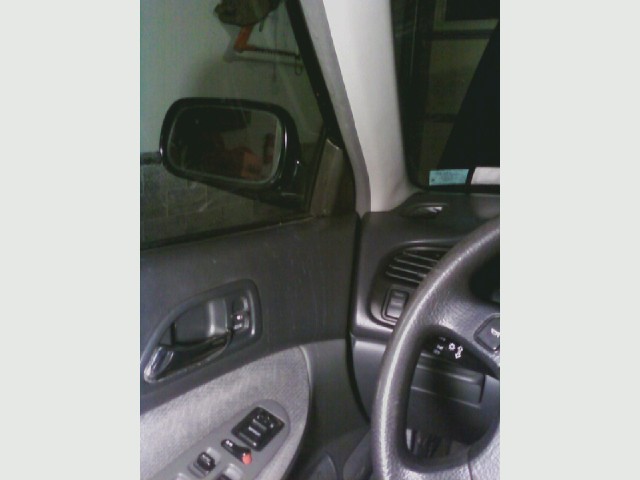

    As for the tweeter placement alot of people like Mac for example would suggest to put them in the A piller instead of the sail. As for me, I am going to put mine in the sail panel as well, but in order to get them angled to fire toward you. You will need to fiberglass it to get the angle. I am going to use a local shop around my area, and have them do it for me. I have no idea how to work with fiberglass, and hear it is a pain. I am willing to spend the extra money for it, if that means it will be right.
    Hope this helps.

    I ended up putting the tweeter in the side panel of my door near the sail panel. It looks great but unfortunately it is not perfectly aimed towards me. It still sounds fantastic after testing the speakers. I installed the 2 front speakers and duct taped the crossovers to the dynamat/material covering the metal part of the door. I think when I do the drivers side door I am going to do it in segments. that sounds like a much better idea.
    Couple last questions. The way my speakers were before, both front speakers went to channel 1 of my amp, both rear speakers went to channel 2. On my amp all I did was notice that in channel 1 there were two sets of positive wires and 2 sets of negatives. I removed all wires from channel 2 and then placed the extra set from channel 1, to channel 2. Does that sound like the correct process? Here is a picture of how it is now
    The darker looking wires are the ones I disconnected (rears) and wrapped them with electrical tape.
    I am going to be putting my 12'' subwoofer in and I am going to connect it to channels 3 and 4. Is that easy to do? I can only imagine that only 1 set of speaker wire comes with the subwoofer, meaning only enough for 1 channel. Do I need to get a second set and just connect them to the same connections on the subwoofer and the ends to channels 4 input too? Or can you do it with only 1 cable somehow. Also another important question is, This is what the back of my HU looks like right now
    The right side inputs where the RCAs are plugged in says "Front Speakers", and the next 2 inputs just to the left say "Rear speakers/Subwoofer". the ones to the very left say Bus In. Anyways, For the RCA connecting the subwoofer to the HU, Do I use both the red and white input of "Rear/Sub"? I ask because i didnt know if only 1 was designed for the subwoofer since it also says "rear speakers"
    Thanks a lot guys.
    Dan

    Ok. Lets see.... Doing the Dynamat in segements will be way easier, and if you over lap the pieces a little, that is fine too. Ideally you want tweets to fire pretty darn close to being on axis, or toward you. So if it is close, you should be fine.
    One question I have about the speakers though. Are you running back speaker, or just the fronts? Oh, and are you using the supplied crossover that came with the DXI's?
    As for the RCA rear/sub preouts. You will use the positive, and negative side like normal. The crossover part will be done via the HU, and then the amp. As for channels 3 and 4 you only need to use one of the channels for this. With the sub only being a SVC, I would venture to say that channel 4 will be the one to use, and should let you use the low pass filter.

    Anyways, the amplifier I am using is a soundstorm SSL f4 800.http://www.sonicelectronix.com/item_17630_Sound-Storm-SSL-F4.800.html
    The reason I thought about hooking up the subwoofer to 2 channels was because this amps RMS is 85 Watts, and Im afraid of damaging the subwoofer by underpowering it.

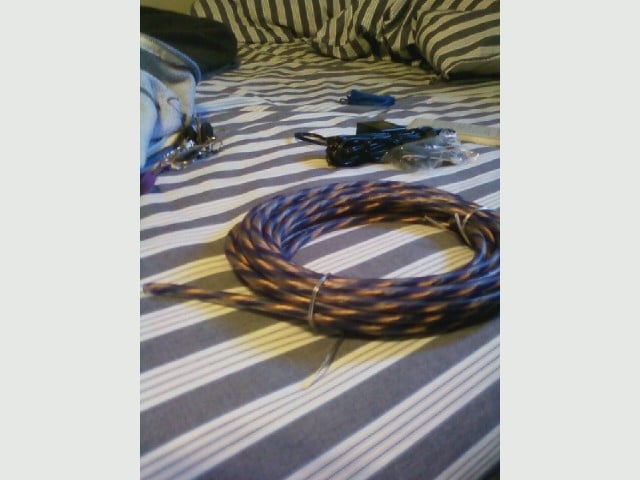

    Also this is the speaker wire I was planning on using for the sub. It came with the power acoustik amp kit.
    It seems to have a blue wire, and a yellowish wire inside the shielding, but I am not sure which is positive or negative. Is there a way to tell?

    Using the crossover that came with the speakers is good, no worries there. Using the first two channels for them is where you need to be. As for channels three and four that would be the one for the subs, and you could bridge it as well on those channels, and if you have the bass boost knob that is also from what I can tell for the sub channels three and four.
    So, on channel 1 & 2 you put the crossover on full range and then adjust the freq according to what the speakers can manage. Look at the manual for the Dxi's to get a better idea on that. Putting the crossover on full range is fine because, the crossover that came with the Dxi's will divert the signal accordingly. Do not turn on the bass boost on these channels... It will make them sound more bassy, and muddy. Use the HU bass, trebel, and mid for that stuff.
    Channels 3 & 4 is for the sub. I think you can bridge that to get more power, but I could be wrong. I sure I am right, but a little hazy on that.
    Arun please help with this. Thanks.
    At any rate if bridging the last two channels is good. Then plug in the bass boost control to the hole, then set your croosover to lass pass, and then adjust the freq. Now with this, anything that is higher then lets say... 40Hz should not pass through. In fact I would leave that at 40Hz, and call it even. Do not use the bass boost switch on this either. That is what the knob is for. This should be by the driver side of the car.
    The volume issue is not at all bad. Basically what they do (Best Buy) is turn up your volume on the HU to roughly 80% max volume. They then adjust the gain, and they try to get this match what the HU is pushing out. They adjust it to where they hear audiable distrotion, then turn it down a bit. It keeps you from blowing your speakers. NOW THE GAIN KNOB ON THE AMP IS NOT VOLUME CONTROL. It is only used to match the signal that comes from the HU.
    The over all idea is blend the sub with the front speakers so that they sound as one. I have a feeling that I may be off on some of things by a little bit. I have had an EXTREMELY wonderful weekend, and I am still thinking of this girl from the club so, yyyeeeaahhh my mind is kind of all over. LOL.
