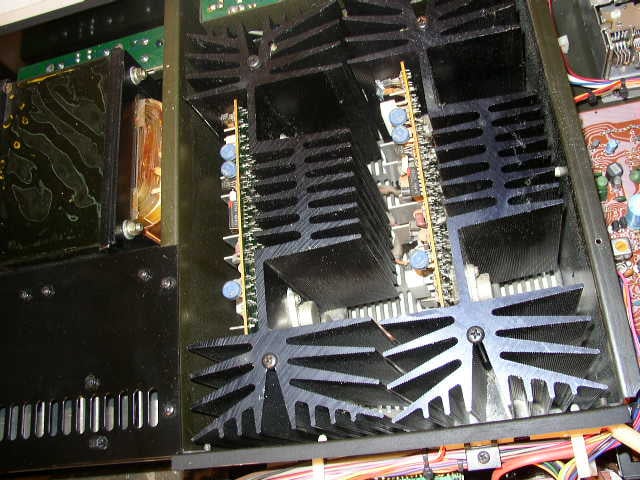

    I am generally not a big fan of receivers as opposed to separate components, but I have a soft spot in my heart (and/or head) for the aesthetics and sound of the Yamaha receivers of the 1970s. The CR-x00 and CR-x020 are incrementally better built than the CR-xx40 or the later "R-xxxx" models; the CR-xx40 and some of the later models use some parts made of the purest Unobtanium and some of them (e.g., R-1000 and maybe R-2000 as well) had some engineering shortfalls (e.g., inadequate heat sinking) that exacerbate the problem of component failure.

    R-1000 innards
