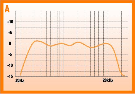

Here's a quick quiz: which of these two speakers sounds better: Speaker A with a frequency response range of 45Hz to 18kHz or, Speaker B with a range of 20Hz to 25kHz? The truth is there's simply not enough data in these numbers to know anything of value. Taken out of context and without other data, a simple set of numbers don't tell you much about real world sound quality. But people make audio buying decisions based on published specifications, such as the frequency response spec, everyday. I'd like to demystify the process for you; let you in on a little industry secret about "The Frequency Response Spec."
My Frequency Response
The Frequency Response specification attempts to describe the range of frequencies or musical tones a speaker can reproduce, measured in Hertz (known to old-timers as "Cycles per Second"). The range of human hearing is generally regarded as being from 20Hz, very low bass tones, through 20kHz (20,000Hz), the very highest treble. Presumably a speaker that could reproduce that range would sound lifelike. Alas, it is no guarantee. The most important determinant of a speaker's frequency performance is not its width or range, but whether it's capable of reproducing all the audible frequencies at the same volume at which they were recorded.
You don't want the speaker to change the "mix" of tones; that would ruin the timbre of voices and instruments, making them sound unnatural. Ideally, you want the sounds that are on the recording to be reproduced as they were recorded, without the speaker changing the sound. To say it another way: if you made a recording of all the audible tones at the same volume and played that recording through a speaker, you'd want all the audible tones to come out at the same volume. In fact, that's one way of measuring speakers. A signal that's comprised of all frequencies at equal volume is fed into a speaker that sits in a room with no reflective surfaces. A calibrated microphone is placed in front of the speaker and feeds the speaker's output into a machine that plots the frequency vs. amplitude as shown in Figure A.

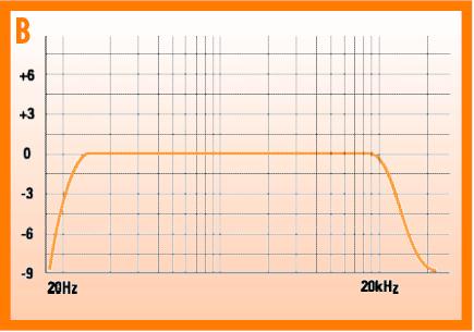

Now take a look at the graph in Figure B. That's the frequency response of the Erehwon Model 10, with drivers and tweeters made of pure Unobtainium ("Half the carbs, all the sound!"). The flat line on the graph indicates that the speaker is "flat"; it reproduces all the musically relevant tones at the same volume. That doesn't mean that a "flat" speaker will play all recorded sounds at the same volume -- bear with me here -- it means that it will treat all sounds equally; it won't impose its will on the music but will allow you to hear the music as it was recorded. Flat is good. Flat response means that the speaker reproduces sound accurately.
Too bad that the Erehwon Model 10 doesn't really exist, and neither does Unobtainium. Today's technologies allow speaker designers to get closer to the "flat" ideal than ever before, but they still fall far short of "perfection." So if a frequency range spec is not adequate, what is?

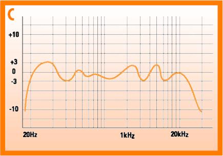

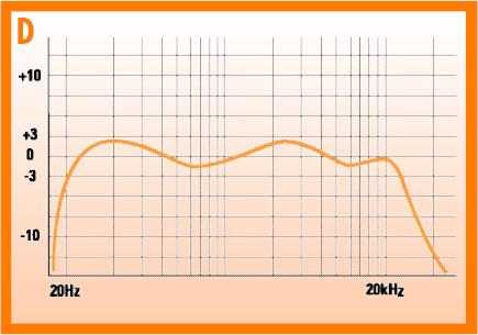

Take a look at Figure C. This speaker has response that can be specified as 20Hz-20kHz +/- 3dB. Take a look at Figure D; it, too, can have the exact same specification as Speaker C! Do you think they will sound similar? NOT! They won't sound even remotely like one another. Speaker C will have "one note" bass and will make voices and other instruments sound unnatural, but Speaker D will sound smooth and more natural.
If I had to choose strictly by the response curves, I'd choose speaker D because its amplitude variations are smoother and gentler. In contrast, speaker C's amplitude variations are more extreme and "spikey." Experience has shown speaker designers that those rapid changes in response produce a sound that is more fatiguing, less pleasing and subjectively less accurate.
