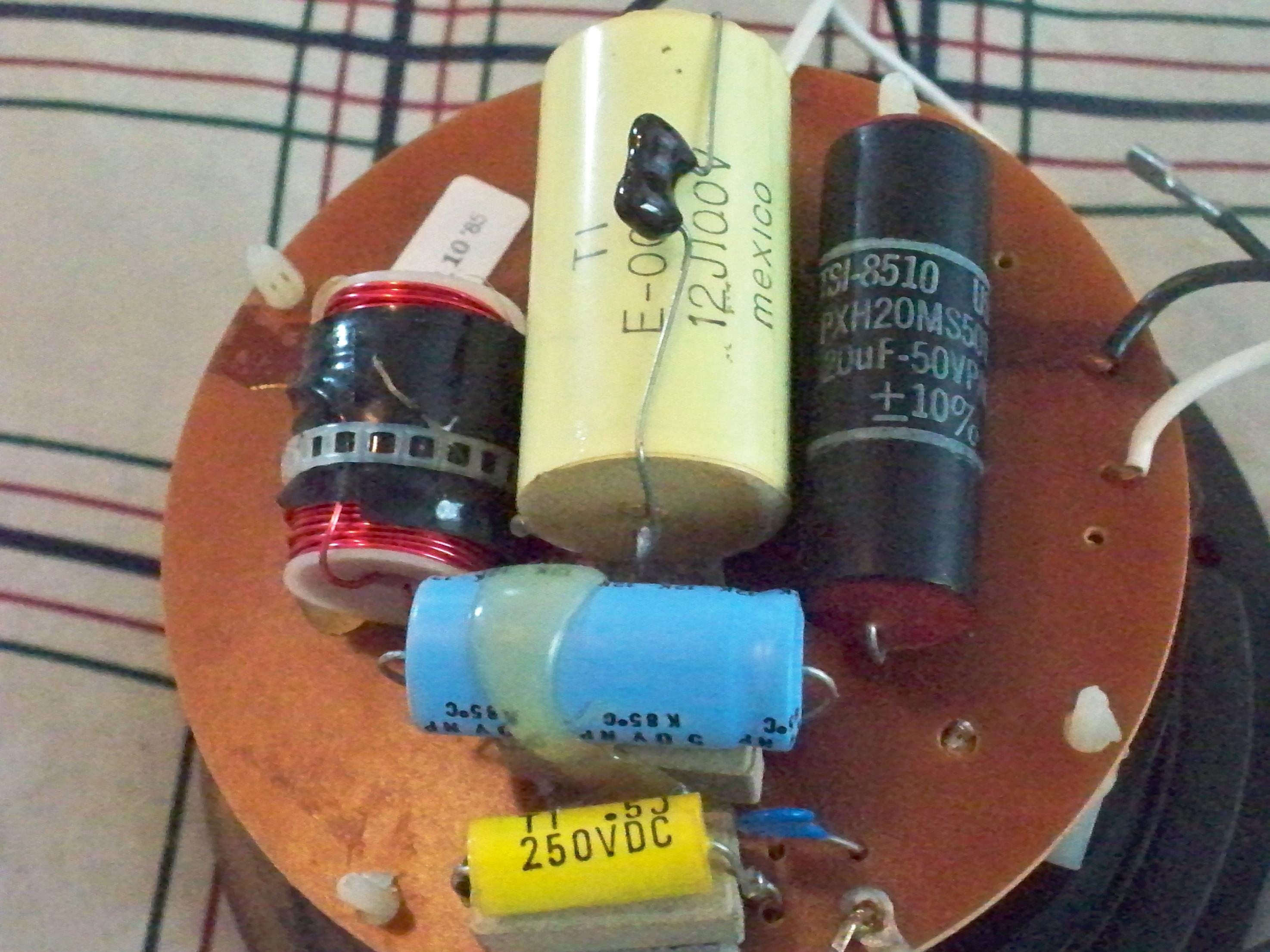

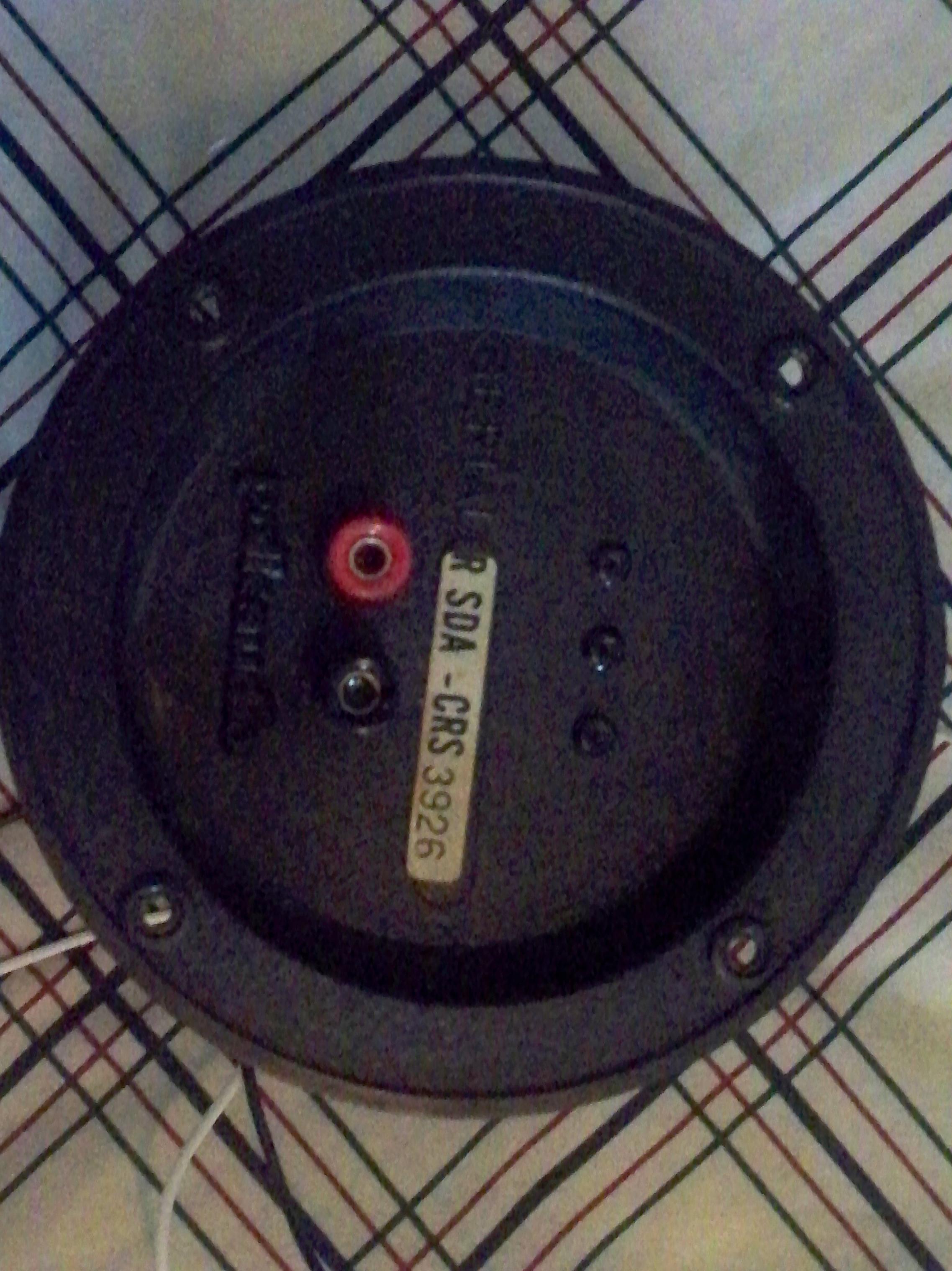

First thanks for any help. Cant find any information(Model #) on the SDA CRS bookshelf speakers crossover. It has 2 woofers and 2 tweeters. Seems to have 2 crossvers. Does anyone have this crossover for sale

    Im not sure nothing looks burnt but it doesnt work doesnt have any fuses im at a lost
    F1nut Posts: 50,768
    edited July 2011

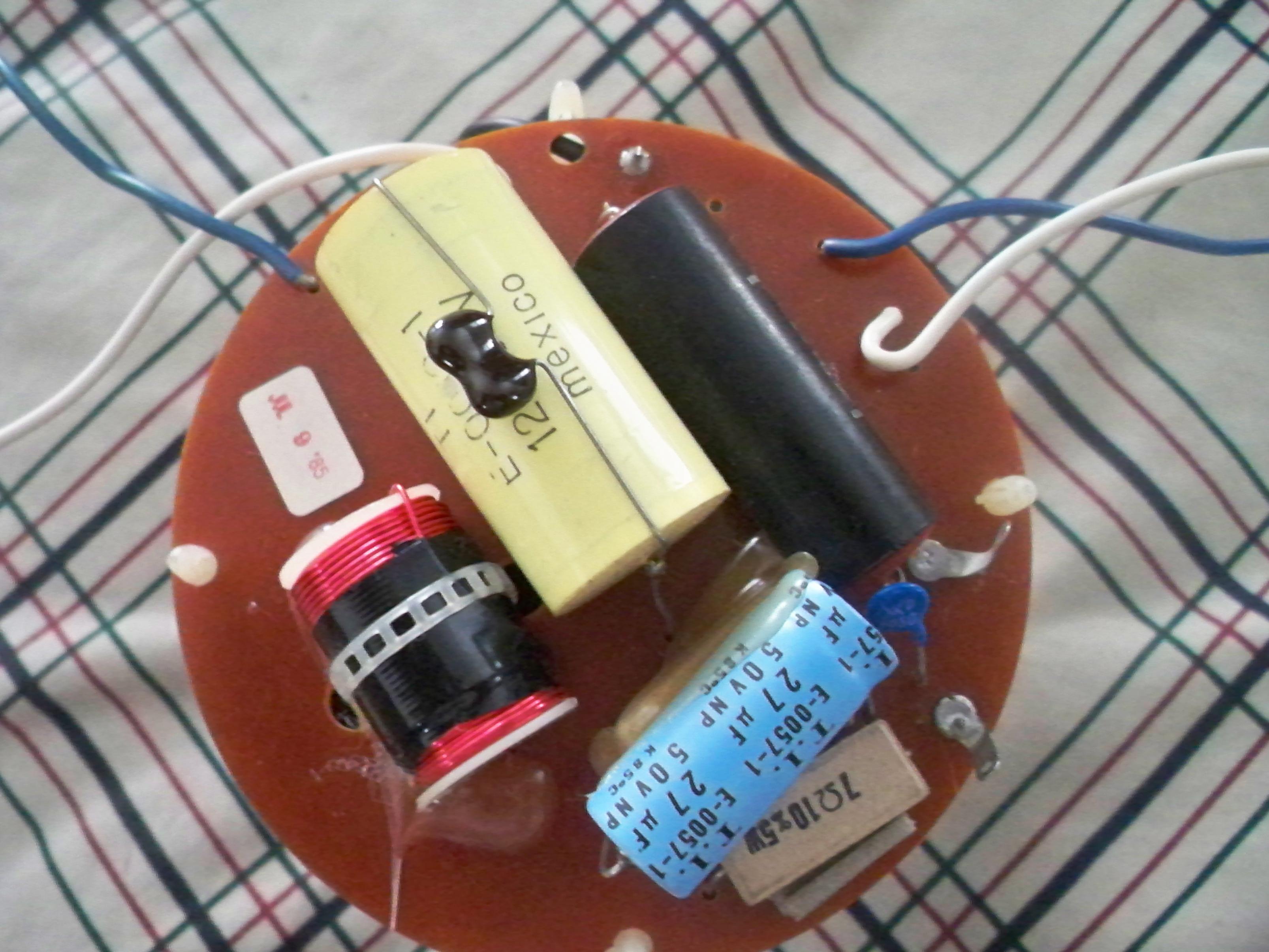

    The schematic for your speakers is listed in a sticky at the top of this section. You will note that both boards have a poly switch (type of fuse) to protect the tweeters. If they have permanently tripped, you won't have much sound from the speakers. You can replace them or remove them and replace with a jumper.

    post some pic's and maybe we can help

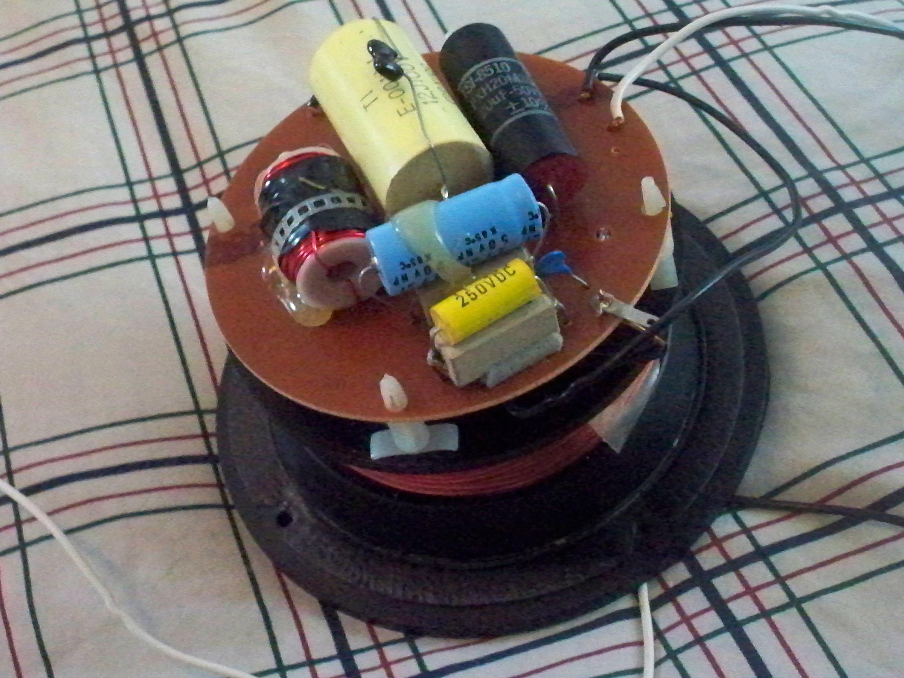

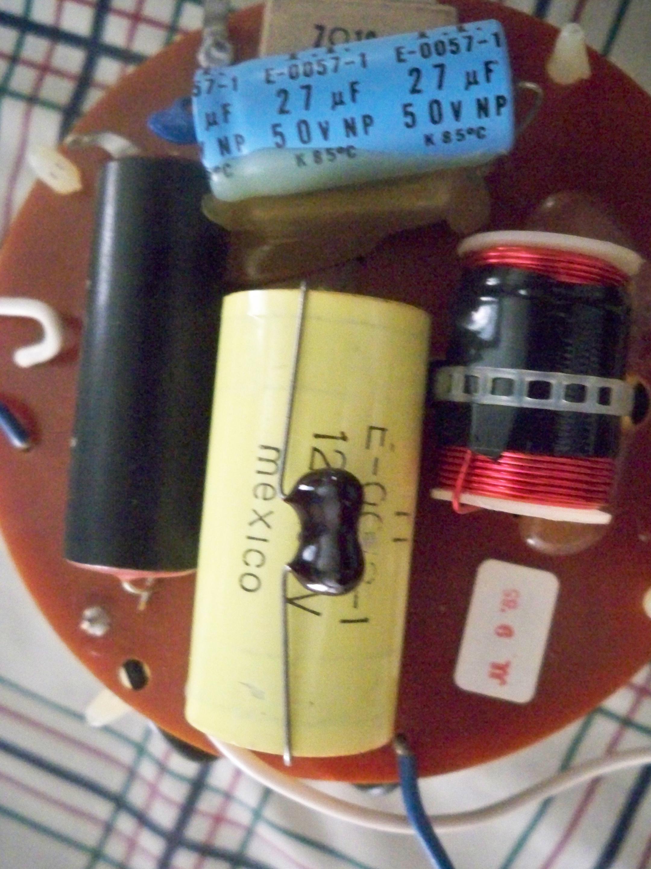

    The polyswitch is the "blue" disc thingy next to the yellow cap--think of it as a tweeter fuse.They usually reset unles they are tripped out.You are using the interconnect cable between the two speakers,,right?

    cant find cable saw a post about making a new cable using wire to wire blade connectors. crossover doesnt work only using 1 speaker
    Toolfan66 Posts: 17,338
    edited July 2011
    I bet your problem is the polyswitch, also call Polk Customer Service they can get you a Blade/Blade cable if you don't want to make one, if I recall they are about $30.
