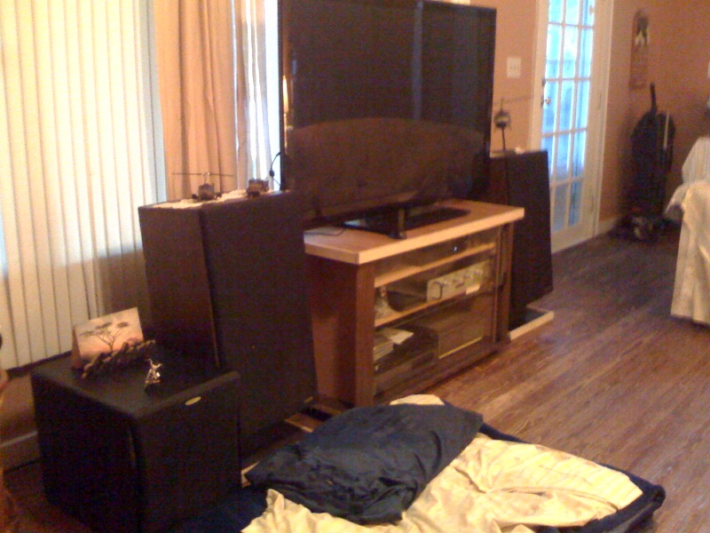

    Qiuck pic
    Yep that is my old polk 10's on the sides ... and my dogs sleeping pad on the floor lol
