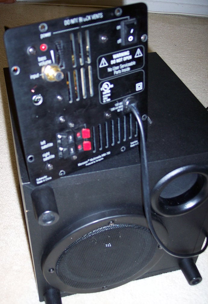

Picked up the legendary Monsoon desktop speakers off craigslist last week. They sound fantastic. Unfortunately the 3.5mm input jack on the subwoofer is touchy. If I push the plug all the way in, sound comes out only out of the left speaker. If I plug it in halfway, only the right speaker works. Putting it in at a halfway point in between is the fix, but when the PC shuts off the speakers make a loud popping sound. This seems to be a common problem with these speakers. The panels are amazing but the sub is cheaply made.
I decided to take it out and replace it with an RCA jack so I can feed it with coaxial out of my Nuforce uDAC2.

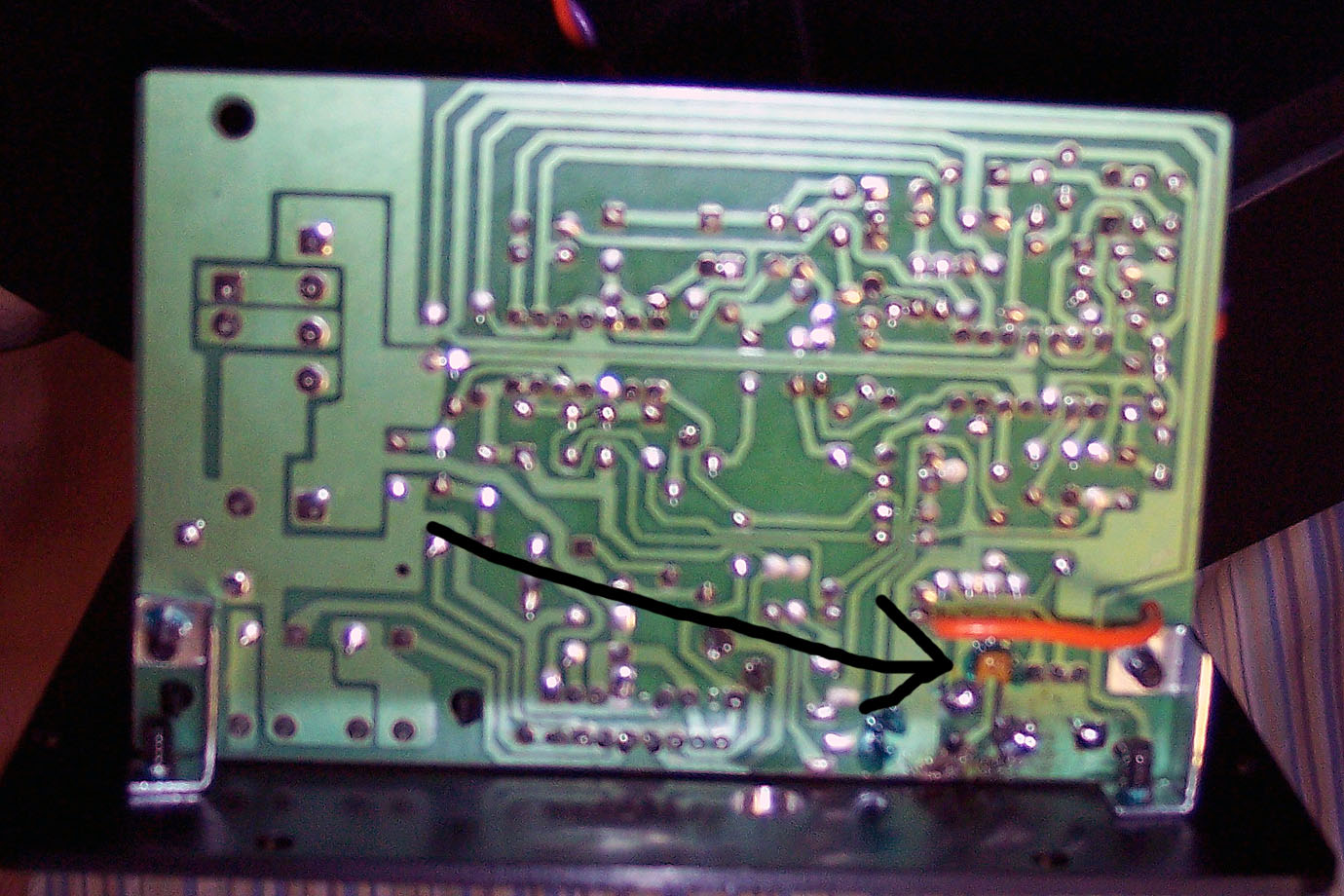

Unfortunately I fried one of the small caps during soldering. It's a ceramic capacitor that says 681 on it. I don't know what the voltage rating is. I've been looking for replacements on eBay but it seems that the closest available value is 680pf. Will it work? I also don't know the voltage rating. I've seen 50V up to 30KV. What is the typical voltage value that's used in line with a 3.5mm input jack?
The RCA jack replacements turned out to be a complete failure. At best I can only get sound coming out of the left speaker. I ended up replacing them with a new 3.5mm input jack and voila, I get sound out of both speakers. I'm kicking myself for not doing this earlier and wasting so much time with more complicated alternatives. The cap seems to still be working okay so I don't want to mess with it.
